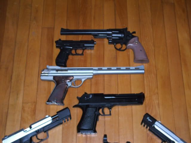

I'm definitely in too!

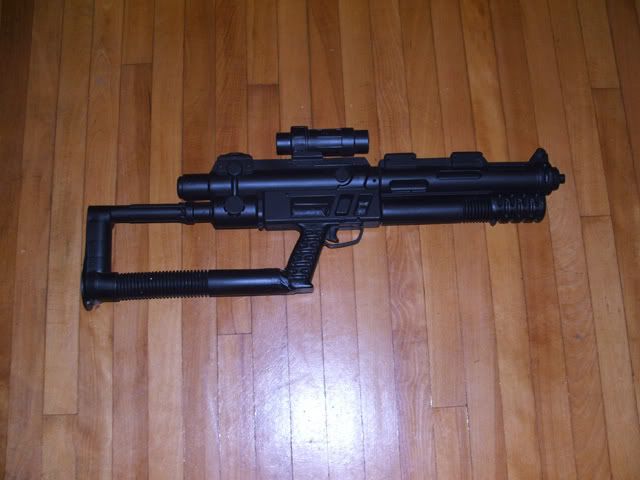

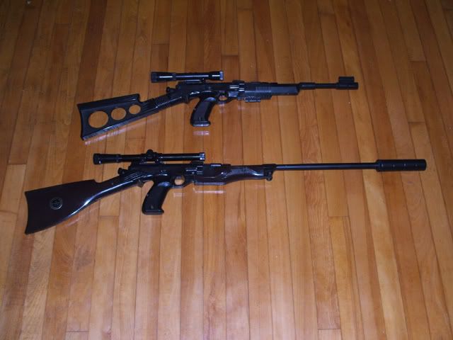

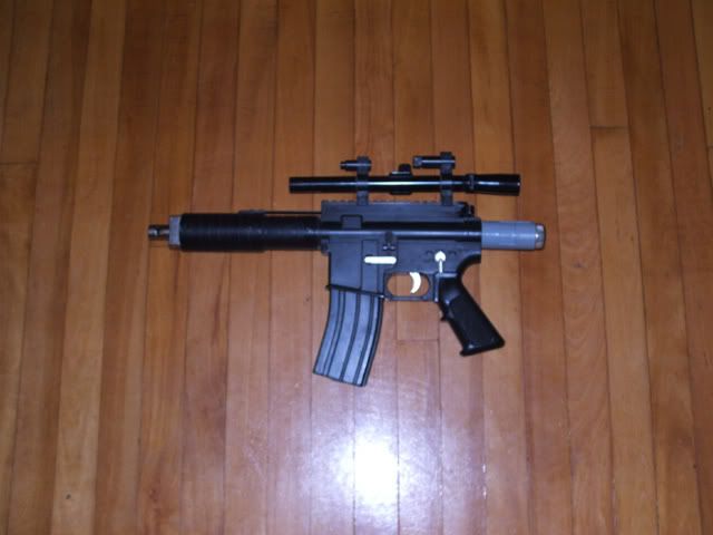

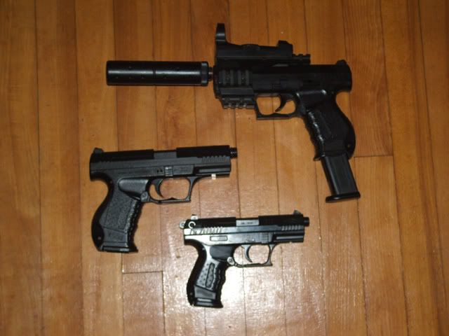

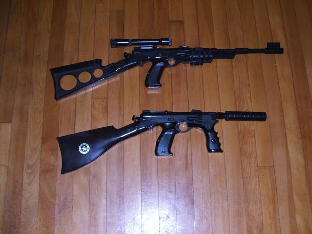

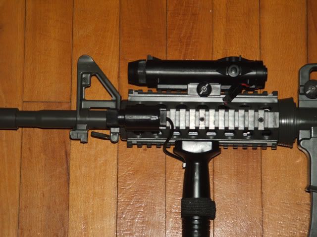

I bought several electric airsoft guns to do a light gun kit bash with, and for the hell of it I also got a Gyration GyroTransport air mouse.  The GyroTransport works fine as a mouse but there is no way to track the gun to the mouse cursor so the Wii mote method is definitely the way to go.
I haven't picked up my Wii motes and sensor bar yet, but plan on getting one this weekend.
So here is a thought that occurred to me... batteries...
How does the Wii mote recharge its batteries?  Is it USB based or does it require a special charging unit?  If it's USB based then that's an easy solution, I'll just put a USB jack in the gun.
I suppose I could feed it from the battery pack of the airsoft gun but I'd rather not get into making a voltage regulator.
I guess I'm thinking a step ahead here, driver and functionality first and then worry about getting it into a gun... but it is something we're going to have to think about at some point.  I for one will be relocating the motion unit to the barrel of the gun so it will definitely be a permanent fixture and not a removeable unit.
Last question for now, what is the physical size of the Wii mote?  The circuit board will obviously be a lot thinner than the case for the Wii mote, but it still looks a bit big for a pistol.  I probably could modify the Desert Eagle I have and get it to fit, but anyone wanting a Walther P99 or Beretta style may be out of luck as far as totally integrating it with a pistol.  Of course there is always the pistols made for the Wii mote but what fun is that ;)
I think it may fit inside a peg unit for a rifle though and won't look out of place on a RIS system.

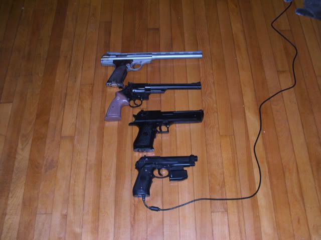

I did read where it takes AA batteries, but also see charging stands you can get.
I know many people will be using the Wii mote guns that you can buy, but I have these I plan on using! ;)
As well as a rather nasty 1:1 scale 50 cal Desert Eagle that has a blow back recoil that puts the TopGun to shame, and it also goes full auto 8)
So for me also figuring out a way to charge or change batteries without having to take the gun apart is going to be important.
There won't be a problem at all fitting them in the rifles, but other than a Desert Eagle or Robocop gun, the 6" part is the killer for me.  The GyroTransport is 1.5"x2.75", perfect size, but not what we need. :(
I think I'll spin this off into another thread, I got all excited and forgot most people will be using the Nyko Perfect Shot or something like that.

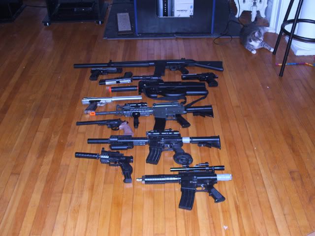

These are all of my guns waiting for electronics to be fitted inside.
Here is one I have that really has potential-
This a closeup of the LAM unit.  The Wii mote electronics would fit nicely in here.
Here are some other M4A1 varients that also would make good Lightgun candidates.  The last one is an actual version of the M16, the Patriot.  What is nice about these over the AK47 is they are a bit smaller in size and the collapable stock really trims them down.  Plus if you want, just pull the stock out for a full size shooter.
Here is one that is not only a unique gun, but also has tons of potential because of the enormous amount of room inside.  This is the P90 (Stargate machinegun)
I also have a G3A3, but like the AK, this is huge (it is actually bigger than an AK47), so it's not something I would want to use for a lightgun.  To give some size perspective, that's the Topgun shown to give an idea how big this thing really is.

Okay that's some rifles, here are the pistols.
Some of these would be very cool, but unfortunately they don't all have enough room inside to house the electronics.
Here are the larger handguns... the Magnums.  All these as well as the up coming pictures are all 1:1 scale.
Bottom is the Desert Eagle .44 Magnum, which is a huge gun.  Middle of course needs absolutely no introduction... Dirty Harry's famous Smith and Wesson .44 Magum revolver.  Top is the .44 Automag from Sudden Impact.  As cool as the middle one is, there is no way I can see this one being converted to a Lightgun.
and a shot with the Topgun for size perspective.
Here are some other very cool contenders, but these are getting to be a bit small inside, although probably can be modified to work.  On the left is the famous James Bond Walther P99.  One has a rail system and extended mag, and the tiny gun is a Walther P22 (way too small for what we need).  The picture to the right... yep, Lara Croft's Tomb Raider guns.  These are actually my wife's from her Lara Croft costume she wore for Halloween one year so I'd have to buy some more if I want to mod this model gun.

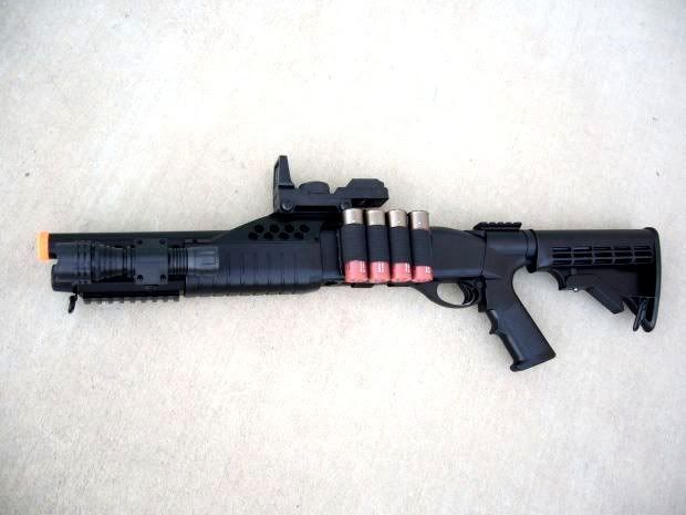

Some other interesting options... Say you want a shotgun... no problem, pick the style you want!
Seriously, once the bugs are worked out, the options are limited only by your imagination!

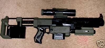

Okay, airsoft is cool, but don't forget about... ready?  Nerf!  Yes Nerf guns!  Granted these won't look like real combat guns but there are some very very cool Nerf guns out there and once dressed up with some paint, nobody would even guess it's a Nerf gun!  I think these actually have a Halo look to them-

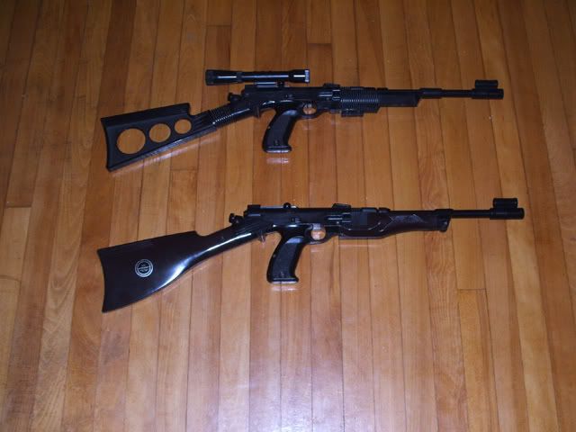

Last up is a very unique gun, and rare too, so as much as I would love to convert these I probably won't.  This is a type of airsoft gun, but the modular style and design is actually the exact same as a 1970's console light gun!
This is a secret agent 'kit' I made for my son.  Don't worry, he's 20 now and I made this for him when he was 16 or 17, so he wasn't a tot or anything like that.
Here is the above gun in various stages of its modular design.  You can probably see why I like this one so much and there is enough room inside to the electronics too!
