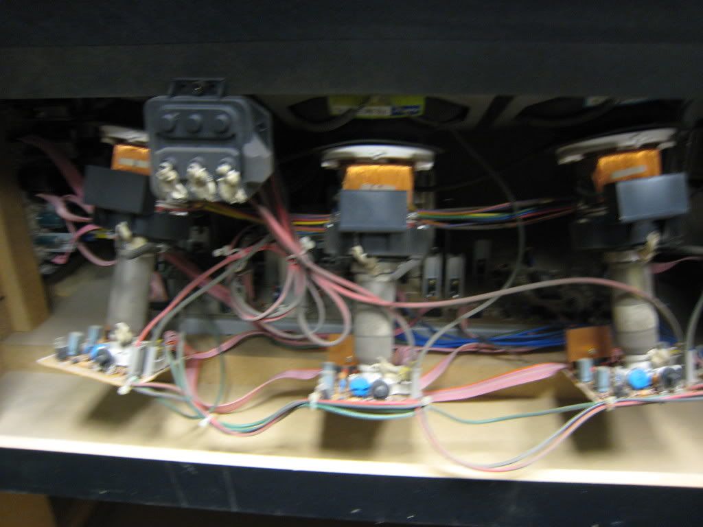

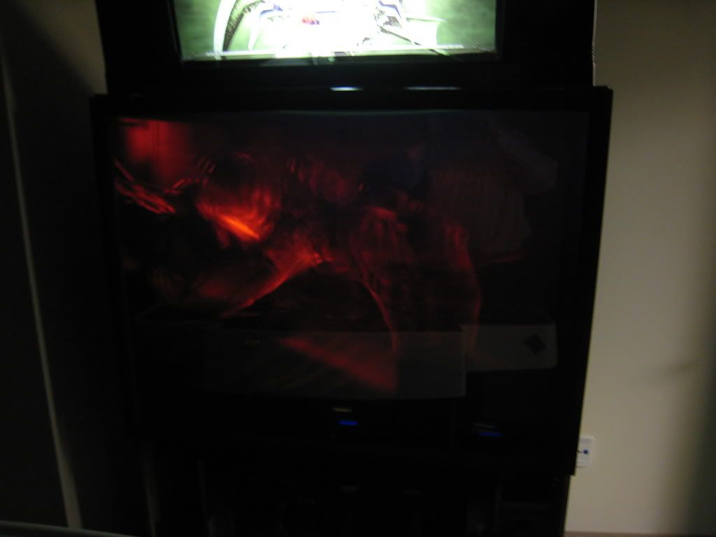

Hello, everybody.
I have a showcase cab with a 50" projection monitor that I believe uses three projection tubes (red, blue, and green).  For some reason, the three different images are not focused resulting in a little ghost image.  Some pics of it can be seen below.
I am wondering how I can focus all three images, but I am not finding any buttons to do so, and I am not finding any info on the internet on how to do so.
Any assistance on this would be greatly appreciated.  Thank you.

thats a convergence fault,aaaarrrrrrr :(
what make/model is it?
if you are real lucky you only have to converge the the colours using the handset
if you are unlucky then the convergence board is faulty

Convergence issues is a very common problem for projection tvs. The board that focuses the three crts is going to need some assistance. What you will need is to locate the board with your convergence amps (usually has 1 or 2 large heatsinks on it) and replace the amps. They will usually have a part number on them like stk-110 or the like. In order to do this you are going to need to pull the board and fire up a soldering iron. A supplier that I have used in the past is Audiolabga.com . If they have two versions (one that is $15 and on that is $40, buy the 40s). Good luck!

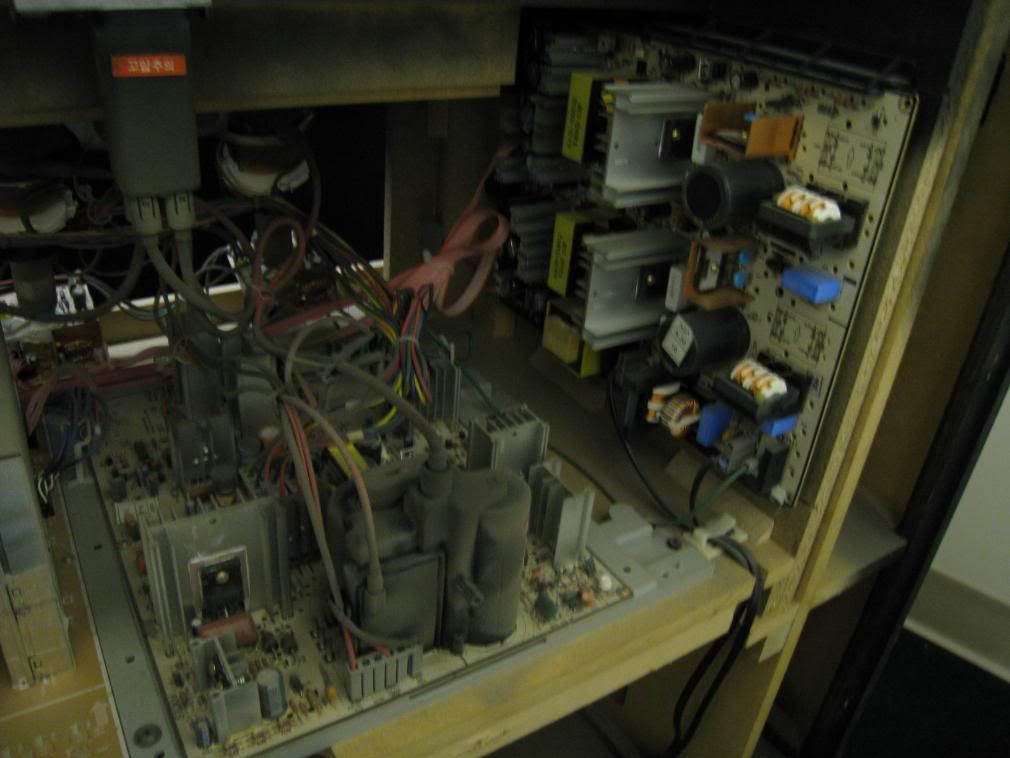

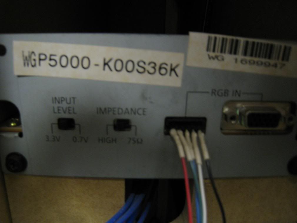

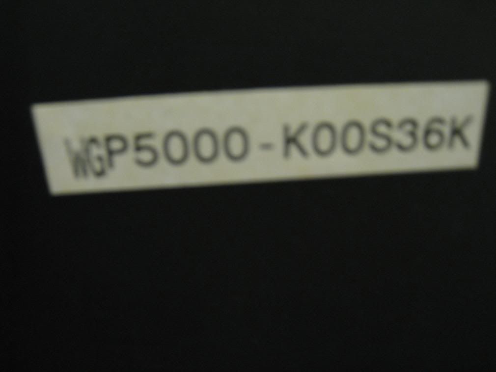

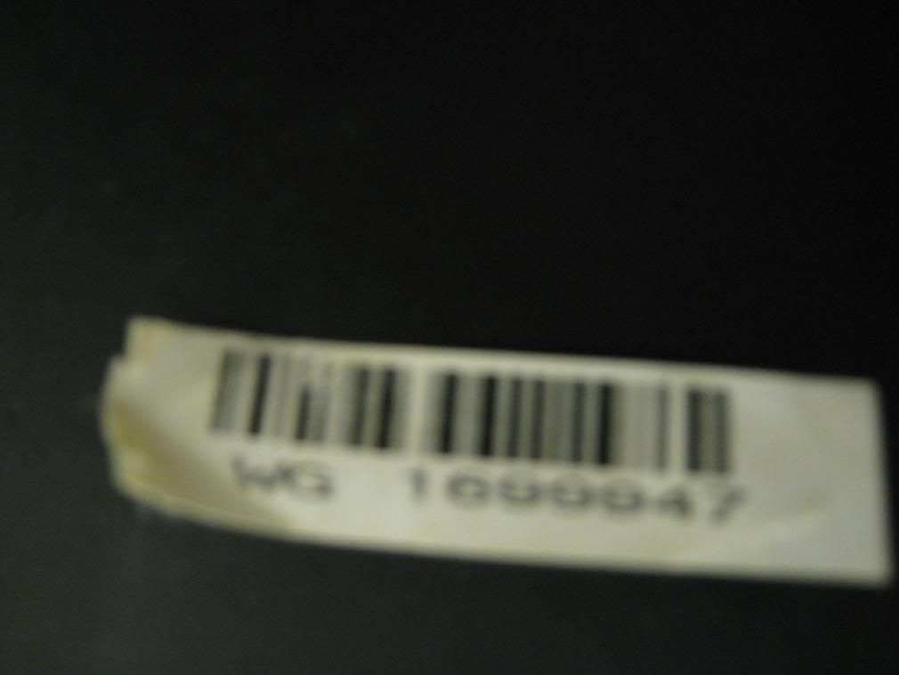

Sorry it took so long to reply. But I think I found the model number.  I believe it is one of the following:
WGP5000-K00S36K
WG1699947.
I have attached photos of the numbers on it, as well as of the PCB and electronics inside.
Please tell me how I can get this monitor to focus properly.  Any assistance on this matter would be greatly appreciated.  Thank you.

well according to that sticker its a wells gardner-never seen it tough so i am would say that was a united states issued only
this a later type projector where the convergence can be set using a remote control(same as a tv controller)
you will need a remote for this model and the convergence guide,maybe you can get that from wells gardner or namco
if you cannot converge using the remote then the problem will be the convergence ic which is located on the left hand side board mounted vertically
http://www.namcoarcade.com/nai_tech.asp

This is not going to be solved with a remote control. I have repaired many of this style tv, and this is going to involve some soldering and electronics skills. You will need to remove this board and desolder this part. Once you have installed your new one your tv should function normal again. If it does not go right away there are usually resistors or capacitors that blow right around the chip when this goes. This is about the easiest fix that you could hope for, but I recommend calling up a buddy who is good with soldering to replace this part.

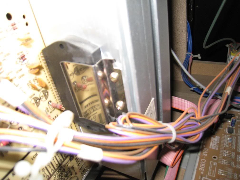

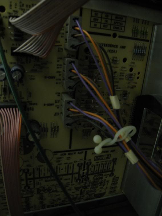

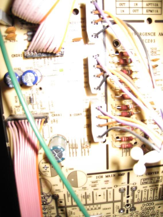

Okay.  I have some more questions.  I took some more pics:
1.  Is the black box next to the heat sink that part that I need to replace?
2.  If so, what is it called?  Does it have a part numbers?
3.  Where can I get them?
4.  Also, there are actually two similar parts, one on one heat sink visible from the rear of the machine, the other on another heat sink visible from the front of the machine.  The former is shown in the first two pics above.  The latter is shown in the very last pic above.  Do I need to replace both of them or just the one facing the rear of the machine.  Please let me know.  Thanks.

The very first picture is what you are replacing
     I can't quite tell from the picture if there are 2 or 1 but you need to replace that big black part that is attached to the heatsink. If there is one on the front and the back of the heat sink then you will want to replace both. These parts are 3 channel convergence amps. The website I listed at the top of the thread stocks these parts ( www.audiolabga.com ) . In order to get the right one I recommend unplugging the board and removing the cover that is pressing the amp onto the heat sink. There will be a part number that is silk screened right under that cover. It will say something along the lines of stk-330 or 440. You will want to head over there and order 2.
    For the install I recommend getting your soldering buddy to put the new amps in. Get your low wattage soldering iron out with your de-soldering braid and remove the pins one by one, and do the same thing in reverse. Before you completely remove everything, get out a black sharpie and label each connector that plugs into this board with a letter and match that to where you plug it back in. Tvs often have many sets of connectors that have the same plug that carry different type signals. If you plug the wrong cable into the wrong place on your board you may accidentally fry your tv, and have to spend a lot of money on a tv repairman.
    Hopefully once you replace these you will be done.  If the issue is the same pull the board again and check your soldering joints by heating up all the pins and letting the solder settle into the joint. If its still having issues you will need to take a digital multimeter and check all of the resistors and capacitors on this board.
    Last but not least, go to a local computer store to pick up some computer heat sink compound to put between the amp and the heatsink. The best brand to buy is called Liquid Silver. When you put it on, do not gob it on. Less is better and just put enough on so that you can't see the heat sink underneath TIP:use a old credit card or grocery store card to spread the compound onto the heat sink. Good luck!

Here is a good picture of a convergence IC
