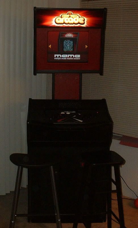

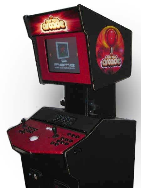

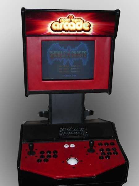

Hi All,
Just thought I would share my first MAME arcade with everyone. I picked up an old Mortal Combat 2 cabinet at a local auction for $5. It had a great monitor in it (WG 25k7197) with a very clear picture. It also inclued a Bass fishing game which I sold on ebay. I repainted the entire cabinet and installed an AMD Dual Core 4200+ with an ArcadeVGA video card, J-PAC for the monitor, and an I-PAC4 for the 4 player control panel. The picture below shows the result. The whole thing cost me a little more than expected $800, but I think it was worth it.
The only problem which I am still having is a video issue. When the whole system starts up, I get an intermittent ghosting on the screen. During this the screen also flickers. It is always fixed if I unplug the J-PAC from the computer PS/2 port, or unplug the I-PAC4 from the J-PAC. This happens a few times in the first 10 minutes of operation and then doesn't happen again.
Also, when the system starts up none of the controls work, which are connected to the I-PAC4. The problem is fixed when I unplug and replug the PS/2 cable from the I-PAC4.
By the way, the J-PAC is only used for video while the I-PAC4 is used for controls.
If anyone has any ideas, please let me know.
Thanks
BASS!
