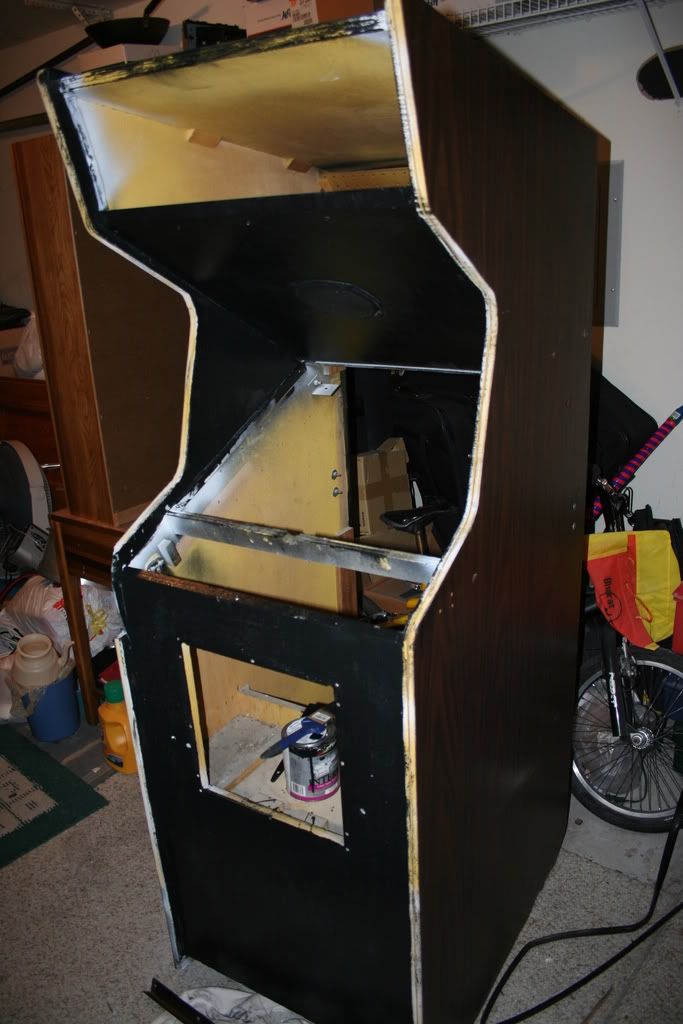

Lately i have been working on my TRON.
After sanding it all the way down, I thought about using some SHEET ROCK MUD.
I have been using it in my house, We have been remodeling rooms.
I know how well it hides and fills up imperfections in sheet rock.
So i thought why not a cabinet also?
I have to say, So far it is working really well !
Anyone else use it before?

I did also use Bondo.
But 4 the bigger area's that needed  it.
I had to use my belt sander to get all the original paint off the cabinet.
The original paint was a pain in the @ss !  to get off.
Much harder than any other cabinet i have done before
By doing that, It left alot of scrapes and tiny groves in the wood.
This Sheet rock mud,  Has fixed that very nicely.
This stuff gets pretty hard !
I would not recommend it to fix a large chunk missing out of the cabinet.
But small stuff i would.
To me, It is just as durable as wood filler.
But that is just me ?   :)

Sanded down the Sheet Rock Mud today.
Wow! It came down to a super smooth finish !
This is the route i will go down for all my future cabs!
The Mud really fills in those little nicks and dents excellent.
But like i said, I used BONDO for the big stuff !
Here's what i used below.
