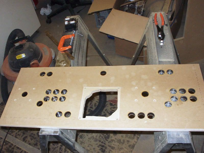

Alright...so I am done with the cutting of the control panel... I need to paint it and cut some Lexan to match.  I will also be painting the underside of the lexan so as to hide the trackball mounting plate which is flush mounted.  I also counter sunk the joystick carriage bolts for a clean look.

Frizzle -- How are you doing the routing, and being that precise?  Are you using a table mounted router or going freehand?  I'm probably going to have to take out some material on both sides of my control panel, one to accomodate the trackball and the other to make the Competitions sit at proper height.
I don't know how I could be confident enough in the router to do the trackball though, and have my overlay still sit level.  Unless you are going to use some type of fill on top of the mounting plate?

bluevolume; I recently bought a table mounted router.  I'll never go back.

Hey Blue for what it's worth I'm not router savy either but managed to handle the flush mount track ball freehand.  I made a template, clamped it to my CP, then routed away.  Not hard at all, tricky part is making sure you have the measurements right when u make the template.  I didn't use any 'fill' over the mouting plate and think it came out just fine.  Good luck!

I free handed the routing.  It was only the second time I ever used the router too.
I simply used the mounting plate as a template and drew the edges...
If I was going to use a CPO I'd likely use putty to fix the very small gaps I ended up having,  but since I am dropping a piece of Lexan across the top it doesn't make a difference.
I actually have the panel "done" but only about 80% operational.   Beer got in the way of completing all the wiring.

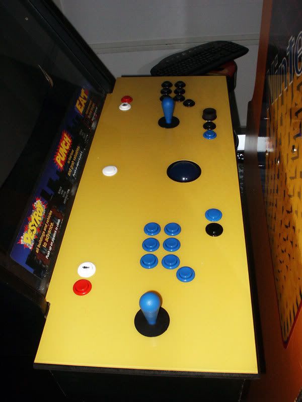

Here is a shot of the control panel I put together over a couple days last week.  Sorry for the crappy angle,  but I am working on my VS Unisystem (as seen on the left) and I am too achy to move crap around for a photo.  Mo better pix coming soon.

why yellow?

I am 90% sure I am going with a "Steelercade" type theme...though I am not 100% sure.  I'm considering painting a yellow stripe down the middle....and adding a steelers logo to one side of the cabinet.
But no worries because I have plenty of Lexan should I decide to change colors...
If I DO go with the Steelercade idea I will go with blue, yellow and red buttons as well...

That's cool, I just thought it was odd to have a yellow cp and black painted cab.

Dude - that control panel is way to small. You should triple it in size...

I doubt you could land even a small helicopter on your CP.  And where is the dog supposed to sleep?

You might want to consider putting a 1/2" or so radius on the edges of your CP.  Sharp corners like that tend to leave deep dark bruises in your thigh/hip.  Or worst yet, on the thigh/hip of your mistress.
