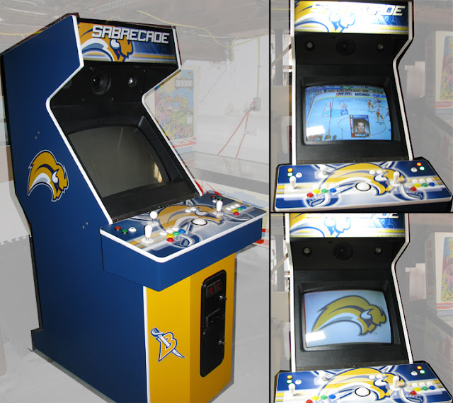

I'm starting my first MAME machine, after taking way too long to figure out what I was going to do.  I picked up a Bad Dudes machine with the intention of modding it, but had a change of heart about gutting a working game.  Bye bye Bad Dudes via Craigslist.
I now have a cabinet that was converted at one time to NBA Jam, but after removing the paint and top layer decals I found that it was actually a Hit The Ice cabinet.  OK, so I could have figured that out by checking the manf. plate on the back, but this was fun too.
Here's a couple pics of the cabinet, before and after removing the paint.  Does anybody know what the story is with the shape of this cabinet?  I might be nuts, but the contours almost resemble a zamboni...

9/4/07 - Big update!  I was tired of tripping over wires and having my cabinet look like its guts were spilled all over the floor, so I took on the task of mounting the computer.  I decided to mount the computer, power supply and drive on a sheet of MDF that could be easily removed.  Right now it sits in a channel I built into the sides of the cabinet, but I might put a couple of bolts with wing-nuts in there so the board won't fall out if the machine is tipped.  I haven't finished tying down the wires yet, but I think it looks pretty nice.
I also installed the solid-state relay and that is working perfectly.  It is triggered off of the 12v line from the computer power supply at the moment, so when the computer turns on the monitor and marquee light up along with it.  This setup doesn't work for "suspend", as that line is live during suspend, but it will work for hibernate.  And for regular "shut down", of course.
The entire machine now has only one plug, with all of the connections made inside the cabinet.  Still need to figure out how/where I'm going to mount the speaker controls and transformer.
I picked up an AtomArcade board from a guy locally and started wiring that up as well.  I wanted to get a tag strip like the I-PAC ships with, but couldn't find anything that lined up with the small spacing on this board.  I'm sure digi-key has it but I decided to go with what I could find here.  I picked up a few terminal strips from RS and am going to connect them with short wires.  More time consuming, but it works.
Finally, I installed the speakers and they sound great.  I had to pick up a shielded woofer because the Logitech one was really screwing with the monitor.  The sound was good for music but it was a bit much for games, luckily I found that there is an equalizer built-in to the motherboard I'm using so I was able to get rid of some of the boomy-ness and over-saturated mids.

10/01/07 - Lots of good things happening on this project.  I finally fixed the monitor problem, and feel a bit dumb as the fix was so simple.  The sparks were actually jumping across dirt and grime that had accumulated on the back of the tube.  I cleaned the whole non-grounding area of the tube, and "sparky" is now gone.
I decided to jump in and start building my control panel.  After going through like 15 design changes I needed to get moving.  I bought a drill attachment from Sears that keeps your drill at an exact angle, sort of like a drill press.  It worked very well for the buttons.
I'm still waiting for my trackball mount (come on Divemaster! ;) ) to get finished with the cutting.  I'm looking for a good hinge solution too, no luck with that so far.

10/11/07 - More work done on the control panel.  I came up with a sick design for the control panel overlay, and I'm waiting for it to get here from Mamemarquees.  Even if you aren't a Sabres fan, I'm sure you'll approve.
I received the trackball mount, and got that sucker installed.  I'm glad I got some practice with the router on the underside of the panel, because sinking the mount flush required routing on the top, which could be visible if I screwed it up.  I actually did it free hand and I think it came out pretty good.  I finished the control panel box and got both pieces primed.
I also wired up my AtomArcade board -- much more work than an I-PAC.  I wasn't able to find any terminal blocks that could be soldered directly to the circuit board (the pins are very close together) so I decided to use blocks with screw terminals on each side.  This was a good compromise, and will let me change things out without having to re-solder or cut and tape wires.
Much more coming, as soon as I get my overlay and paint!

10/16/07 - BIG Update!  I received my order from Mamemarquees, and that's the big one I've been waiting for to get this project finished.  This is also my first unveiling of the graphics I designed -- what do you think?  If there are any Sabres fans here, you'll see that the logo on the control panel is not a standard logo, I came up with that one by combining the "slug" with the sabre from the "B" logo.
The materials from Mamemarquees look great, very impressive.  I should have made my marquee graphics darker though, when the light is on it looks a bit washed out.  I might be able to compensate by putting a filter along the back of it.  For now it is fine.
It was hard to get the control panel overlay lined up exactly, especially since I had it made 1/2" oversize on each edge.  I put a bright light inside the control panel box, then set the overlay on top.  That way, I could see the holes in the panel through the overlay.  When I got it lined up where I wanted it, I cut away the extra material on the left and bottom.  This gave me a starting egde for adhering the overlay.  It came out pretty close, its not exactly right but I'm not going to worry about it.
I spent the next couple hours wiring up the controls, this was a lot of fun.  I'm not being sarcastic, I actually enjoyed it.  I still need to tie up the wires and make it look a little nicer, but right now I'm going for function.  And what do you know, it works!
Last night I dismantled the machine (removed control panel, computer, monitor) in preparation to move it into my house.  This is a huge cabinet and I'm trying to get the weight down as much as possible before I move it.

Its been a long time, but I'm back to say that the Sabrecade now lives!  Since tonight is the home opener for the Sabres, I figured today was a great time to provide an update.
The only thing I have left to do is put plexi over the monitor.  This should be fairly easy, but I just haven't got around to it.
I started this project when my wife got pregnant (there were about 3 months where it was best to just 'give her space'  :) ) and I wanted something productive to do with my new found free time.  Our little boy, Owen, is here now, and I'm looking forward to building a mini-cade with him in a few years.
