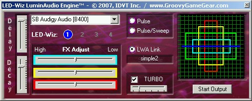

This is a barebones (edit - Ok, not so much anymore)  "light organ" application for the LED-Wiz and LED-Wiz+GP Lighting and output controllers.  The software will detect the number of units you have attached to the system.  The devices are toggled by clicking on the device numbers.  The beat detection I developed is pretty decent, but you may need to  do a little tweaking to get the effect you want.  Start with your wave output volume at about 80% then move the cyan, yellow and red sliders until you see something you like.  *update*  We're on v.05 now!  Get the new one for Delay and Decay sliders for LWA mode, ToolTip Help, a slightly nicer display, and the ability to save settings and run minimized at startup! :)
The "real time" effects are really intended for the full RGB ElectricICE 2 buttons, but a panel full of NovaGem2's or other mono colored lights, will still dance to the music.  The LWA file support, coupled with the Delay and Decay sliders, will open up things for mono-LED users quite a bit though.  I look forward to comments and videos :)
Features:
  • Make every light on your panel respond to music, sounds in video games, etc.
  • Supports up to 4 LED-Wiz or LED-Wiz+GP devices
  • 3 different effects based on custom beat detection algorithms.
  • Unlimited animation possibilities via LWA files.
  • Now even more stuff to tweak!
This version now includes a "Make Default" button and command line options as follows;
/hide = Minimize to the taskbar at start up.
/start = Start the lights using previously saved settings.
Click on the screencap to download it, unzip it onto a drive and run the executable from the folder it creates.

I get the following error :
LuminAudio WIP
Failed to activate control 'VB.UserControl'.  This control may be incompatible with your application.  Make sure you are using the version of the control that was provided with your application.
OK
I'll have a look on the web to see if its a common error. I'm pretty sure I've got .net 1 and 2 installed but I can't remember if I've installed any vb ocx type stuff.
Back soon !
Buks
EDIT : lol - I always do this ! I needed to register the supplied ocx :)
Just in case - open a command prompt and cd to the directory when the fancy-music-lights-thing is and type
regsvr32 ledwizm05.ocx

yep - I usually test software extracted onto my desktop so it could have been something to do with the log file path (just a thought).
I've got the leds flashing but they flash regardless of music. Its a bit light still so theres no point in me trying to post a video.
Okay, I've moved the app to C:\LuminAudio_WIP and re-registered the ocx (I think it got confused as I'd moved it from where it was previously registered).
I start the app and click on the "1".
All but 2 of my buttons light. On full brightness.
I click on Start Output - all buttons start flashing in what could be a radom sequence (including the 2 buttons not lit from the previous step). All leds are very "dull".
Starting and stopping the music doesnt seem to make much difference - again its hard to see until it gets a bit darker in northern England !
I'm not running anything other than ms media player.
Any ideas ? Or can someone else post their experience ?

Try going into the recording options for your audio card and make sure the source you want monitored is selected and that the volume is up.
Most sound cards nowadays will have a "what you hear" or "mixer" kind of control that acts as a Master for all inputs.  If yours has this, try selecting that one.
Also, make sure your WAVE playback volume is up!
RandyT

Not sure what "the source you want monitored" is ?
You have open up the mixer app, go to Options, and "Adjust volume for" -> Recording.  Then click OK.
Then the sliders all change to recording levels and have a checkbox  to enable them.  You need to have either the "What you hear" or "StereoMixer" or something like that to feed all input through the AudioMonitor.  Alternatively, you can limit it to WAVE, MIDI. MIC, ect. by selecting just that input.

Woot !!!!!!
Randy - you the man ! I have never seen that option before - I had to tick the "Wave output mix" option so that the mixer showed it. Then I upped the volume - nothing. Then I ticked the "Select" button and wow ! All lights full  brightness ! And they go off when the music stops - which proves that they are reacting to the sound (I think).
Now goign through my entire music selection :) Cheers randy - I build an arcade machine to play games and you make me turn all the lights down low and play bad dance music!!!!

« Reply #31 on: August 22, 2007, 03:38:37 am »
Hey Randy,
I've hooked up my RGB boards to the ledwiz and on all six, only the blue is lighting up with this app.  Is there something I'm missing?  They work fine with the regular LEDWiz software.  I checked to make sure the correct boxes were checked.  Also, it only works if I have pulse selected.  It doesn't work if I have anything but pulse selected.
RandyT
  • Posts: 7024
    • GroovyGameGear.com
Re: LuminAudio Engine™ Release - Music-2-Lights for LED-Wiz / LED-Wiz+GP
« Reply #32 on: August 22, 2007, 10:30:31 am »
Hey Randy,
Make sure that both the wave in the playback and "stereo mixer" in the recording volume levels are up to pretty much to full, or to the point just below where they might start to distort a little.  The Master volume can then be tweaked to control sound levels without affecting the lights.
Then, tweak the sliders.  Move the RED slider about 1/4 from the left, and the YELLOW slider about 1/8 from the left.  You should start to see the other colors.
Also, make sure you have some good, punchy music playing!
Let me know if this doesn't get it going.
RandyT

« Reply #36 on: August 22, 2007, 09:24:30 pm »
Randy,
When using the software, only the blue comes on when I start output.  Even when I try to load one of the .lwa files, they all shut off.  So, again, the only time they are on is when it is on pulse, I have either one or both LEDWiz's selected, and I start output.  Other then that, nothing.  I have checked all sound options under the input, as I have had to do this previously with Freebox software, so I'm familiar with what was needed to be done.  I have no idea, as everthing works (well, I assume the 2nd ledwiz works since they all turned blue) when using the regular LEDWiz software. :dunno
RandyT
  • Posts: 7024
« Reply #37 on: August 22, 2007, 09:52:47 pm »
When pulse is selected and you see blue, do they flicker to the music at all?
Also, how are your LED's wired to the LED-Wiz?
I've had it working with a SoundBlaster Audigy under 2K, and an Aureal Vortex under 98.  This pretty much represents the high and low end of the spectrum so I would expect it to work on just about anything out there.  Anyone else seeing this type of weirdness?
RandyT

« Reply #39 on: August 22, 2007, 11:02:16 pm »
Okay, I figured it out.  I was using a laptop to test, and apparently, there's no dice with that.  Anyways, hooked up the jukebox computer and it fired right up.  Works like a champ.  Thanks for trouble shooting with me.  I thought a laptop would work fine. :dunno
