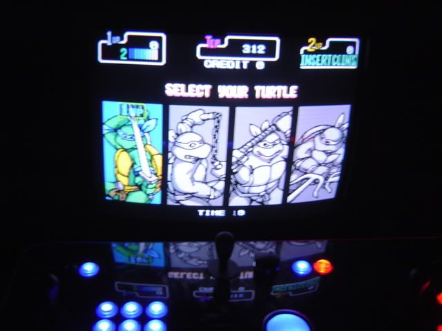

What video-related settings should I have in my mame.ini if I'm using a DVI to component adapter with a TV? (I want the most accurate, arcade monitor-like results)

I think the most important are:
video                        ddraw
hwstretch                 0
switchres                 1
and then force resolution to either 640x480 or 640x432.

Can you elaborate on that a bit?  Do you mean set the desktop resolution to 640x480 or 640x432 and then let mame set it to whatever it wants using switchres?  Thanks.
Jeff AMN
  • Posts: 1213
    • Gamer Theory
Re: mame.ini for TV with component
« Reply #4 on: June 22, 2007, 04:04:59 pm »
You'll want to set your Windows resolution to 640x480. To do this, you need to do the following:
Right Click on Desktop --> Properties --> Settings --> Advanced --> Adapter --> List all modes --> 640x480 True Color (32 bit) 60 Hertz --> Apply --> OK
After that your desktop should be set to 648x480. You will also want to set it to your primary (or only) display. At this point, or even before, you should set your preferred front-end to 640x480 as well. Now, when you fire up games you'll notice that the edges of the screen are cropped or that the screen is way off of center. To fix this, simply change the MAME cfg (.ini) file. Set the resolution to 640x432. Yes, 640x432 is the correct resolution for component inputs. If you go higher, you'll get part of your image cropped due to overscan. Again, 640x432 is the correct resolution setting. Save the cfg file, fire up your front end, and enjoy the closest image you can get to an actual arcade monitor with a TV set.
Example Pics:
Vertical Games look nice...
So do horizontal ones.
Close up shots.
Any bluriness can be attributed to my lack of a tripod and poor photography skills.

Alright, I have the video set to ddraw and the resolution is being forced to 640x432.  I don't understand why I should have hwstretch off though if I'm forcing the resolution to 640x432?  If I do that, then most games will be displayed in a little tiny box since they aren't being stretched fullscreen.  So right now, I have it stretched which fills the screen, but makes the image a bit blurry due to the stretching...

hwstretch intoduces blurriness associated with stretching (anti-aliasing).  That's why you want it off.  Did you remember the switchres = 1?  It's been a while, but those settings used to fill the screen for me.
Zebidee
  • Posts: 3499
  • Last login:January 07, 2026, 10:22:02 am
« Reply #8 on: June 25, 2007, 05:33:09 pm »
Those are good general defaults, but you may find that some games will look better in 640x480 and/or with d3d instead of ddraw.  It all depends upon their native res vs 640x432, how well it scales etc.  You also want to try in your default mame.ini file:
window         0
maximise       1
keepaspect   1
Using powerstrip and setting MinLines=200 in the pstrip.ini config file will let you create some great non-interlaced modes such as 640x240, 640x256, 640x288, 448x240, 448x256, 448x288.  With these modes and some prudent "integer" horizontal stretching (eg native res 224x256 games look great in 448x256, or even 448x288 to eliminate overscan) you can make most games look fantastic.

If I'm setting the resolution parameter to 640x432 explicitly like you said, then isn't switchres going to always set it at 640x432?
ahofle
  • Posts: 4544
    • Arcade Ambience Project
« Reply #10 on: June 26, 2007, 12:16:35 am »
Without switchres, it may ignore your resolution setting:
"-[no]switchres
        Enables resolution switching. This option is required for the
        -resolution option to switch resolutions in full screen mode. On many
        modern video cards with hardware stretching support, there is little
        performance penalty at higher resolutions, so it is nice to be able to
        get rid of the monitor resync time when you run in full screen mode.
        This is also useful on LCD displays with a fixed resolution. The
        default is ON (-switchres). This option requires -ddraw.

I'm having the exact same trouble, and using the settings recommended here, especially yours ahofle, and with these settings at a desktop resolution of 680x432 I get the game running in a small box.  Ahofle, could you or someone else put their mame.ini on here so we can see the settings.  It would be much appreciated.  Hope this is not too much to ask.

The problem seems to me is that mame is not forcing the 640x432 that we need.  Maybe the lines to force it to do that would be all that I need?

Can you try the same settings, but force resolution to 640x480 instead of 640x432 (just to make sure mame is honoring your resolution selection as someone suggested)?  I also know in MAME32, you have to select a 'screen' (ie not 'auto') to be able to manually choose a resolution -- maybe something similar is happening here?  There is also a verbose mode in MAME that will tell you on the command line what resolution its using (I can't check at the moment what the exact command line switch does it).
Gave it a try and it ended up stretching the top of the screen to just a little bit out of view and the bottom of the screen perfectly to the bottom.  It looked very much like when you load up a vertical resolution game on a 4:3 screen.  I did the math and 480 = 1.111... etc * 432, so I multiplied 640 * 1.111 and ended up with 711.111.   Put that resolution in and mame completely ignored it.  Which makes me think we were right to think that mame was ignoring the resolutions we were putting in before.
Tried changing the screen variable from auto to 640x432 and got no results.
There's multiple groups of these video variables(I.E.  Resolution Aspect, Resolution0 Aspect0, Resolution1 Aspect1), so I guess I'm gonna go play with those or try to figure out what they are and get something going.  Just thought I'd post the results of what 480 did.

So 640x480 was OK just a little bit beyond the top of the screen (overscanned)?  If that's the case, I would go with 480 and find the service codes to your TV and adjust the overscan there to size the picture down.  Then you will have a perfectly fit picture at 480i.

I had previously tried 640x480 as well and had the same overscan on the top and bottom.  I still had to enable hwstretch though, or I'd get the little box in the middle of the screen.  Are you saying yours filled the screen at 640x480 without hwstretch?  I haven't been able to find out how to enter my tv's service menu.

I thought you said when you tried 640x480 that it overscanned on the top?  How can it overscan if it's in a tiny box?  I just tried ghosts n goblins at 640x480, ddraw, nohwstrech, switchres and it filled the screen on my PC monitor.  Also what MAME version are you using?

I'm using 0.116 windows command line version.  When you say "at 640x480" do you mean you have your windows desktop set to 640x480 or you have the resolution parameter in mame set to 640x480?  If you just have windows set that way and mame is set to auto, the your PC monitor is just switching to whatever resolution Ghosts and Goblins runs at...something I'm not sure a television is capable of...
I meant the MAME resolution (I rarely trust 'auto').  My desktop is at 1280x1024 on this particular PC and I'm running GnG at 640x480.  I'm not sure why you are getting a little box with those settings.  Maybe someone else currently using a TV with component inputs can provide some more feedback.
