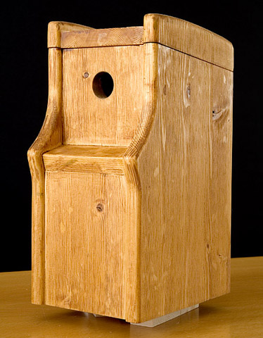

I bought myself a sawtable after getting fed up with two cuts on a selfmade sawboard never coming up identical. To try how it works I decided to build myself a Galaga Birdhouse.

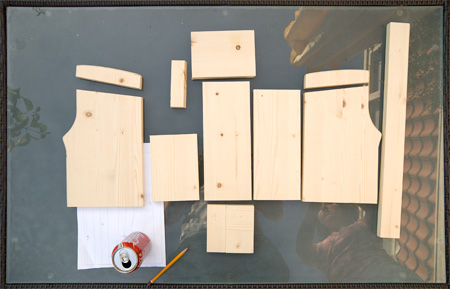

I started out with a drawing of the side with all the parts. The top will be detachable to be able to remove the junk the birds might leave behind after nesting.
Got wood! All the parts cut out. Sort of laid out in the location where they will go in the birdhouse.

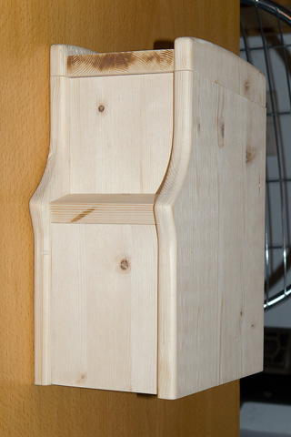

I put all the parts together with the birdhouse laying on it's side. It's not glued or anything. I just simply put the pieces where they are supposed to go to see if it all fits. Just noticed my PocketGalaga in the background  :P

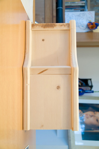

Same thing with slightly different view.
Took of the top board (left side) so the insides are visible. The roof of the birdhouse is visible as a detachable part.<p>
BTW I ran out of wood and I had to make the bottom plate from two pieces :)
Still to be done:
- Hole in the front for entry
- Fix damaged pieces with flexible wood
- Drill holes for dowels
- Glue whole thing together
- Paint outside of the birdhouse
- Hang up on shed
- Wait for birds to show up ...

can you post the dimensions? I wanna try to make one, or should I just print out the drawing of the pieces and blow it up?
The overall height is just over 31 centimeters. The bottom is an 11x11 cm square piece. All the pieces between the two sides are 11 cm wide. I printed the plan over 2 pages which I taped together.
For a more detailed plan, here is a CorelDRAW10 plan of the birdhouse. Illustrator should be able to import that. I tried to export it to Illustrator, but it gave me a 1MB file.
I used 18mm pine wood  (which obviously is a bit too thick for the scale), but that should help insure there is a more or less constant temperature inside of the birdhouse.

I drilled the bird hole with a button hole sized forstner bit. So I can always install a button there if I want to  :P Also put on the first coat of the stain (needs 3 coats according to the instructions). Each coat needs to dry for 16 hours, so ths is gonna take a while  :-\
The putty wood I put in the damaged bit on the "t-molding" looks really horrible.

Forgot to ask, but I have some questions:
- I used a router to round the edges (to mimick the t-molding), but the wheel of the router bit seriously dents the wood. Any way to prevent that?
- In a few cuts the wood got a bit (or even badly) scorched. Did I do something wrong setting up the cut or should I just move the wood faster over the table saw. Moving it fast adds some splintering though. It didn't happen on all cuts, but when I moved slow to prevent splintering it happened quite often.
The bearing digging into the wood is common on softwoods. Only thing you can do is sand it out after.
The scorching looks like it came from an unaligned tablesaw blade or from the fence being clamped down out of whack. This is common on benchtop saws.

heh yeah, it's a bit silly :)
Your gf is really hot.
Ah thanks.
Indeed, I didn't notice the problem with the router on multiplex. Guess I'll just have to live with it on the pine wood then  :-\
I was thinking the same about the fence. I need to clamp the fence of the table saw on both sides. Guess I just didn't get it exactly on the same distance on both ends.

Second coat:
The paint (or stain) is not at all what I had hoped. I wanted it to be like wood (matte), but it's turning out quite shiny.

Second coat:
sun, rain and birdshit is gonna take the shine off it soon enough mate. ;)
