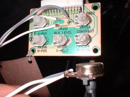

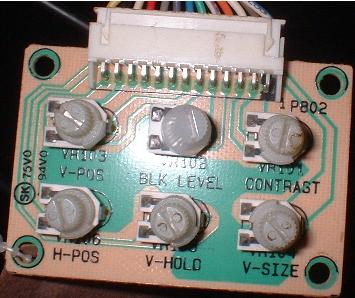

Look for a pot labeled "Vertical Height" or "Vertical Size" and sometimes they interact with the vertical hold control. On some Wells-Gardner monitors there is a pot labeled "50/60 HZ" which will also give you a little bit of compression or expansion at the top and bottom of your picture.
A word of caution: these pots are very delicate so turn them gently or they'll bust.
jerryjanis
  • Posts: 821
  • Skate or Die!!!
    • Jake's Joystick
Re:Tweaking Monitor Pots
« Reply #13 on: October 27, 2003, 11:35:11 am »
Wish I'd heard that a week ago.  :'(

Mouser Electronics (www.mouser.com) has the correct replacement pot for only 61 cents. It's their part number 323-409H-2K.
jerryjanis
  • Posts: 821
  • Skate or Die!!!
    • Jake's Joystick
« Reply #15 on: October 27, 2003, 11:57:22 am »
Wow, thanks a lot.  I just ordered it.  I wouldn't have known where to begin looking.

If you change the "H" in the part number to a "V" you can also order the vertical mount style. The vertical style is used on the neck boards for the color balance adjustments. The numbers after the last dash in the part number I mentioned (in this case -2K) is the resistance of the pot.
jerryjanis
  • Posts: 821
  • Skate or Die!!!
    • Jake's Joystick
« Reply #17 on: December 03, 2003, 02:46:41 pm »
for only 61 cents
Hooray, I'm back in action:
