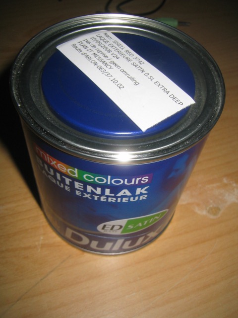

I went to my usual paint shop this afternoon... they don't work with the brand "CORONA" anymore.
But because I still got the reference, they have done an equivalent color in the brand "Dulux".
There it is something you  8)
Of course I've to check if it looks similar :
It looks the same... hope it'll match your cab like mine  :P

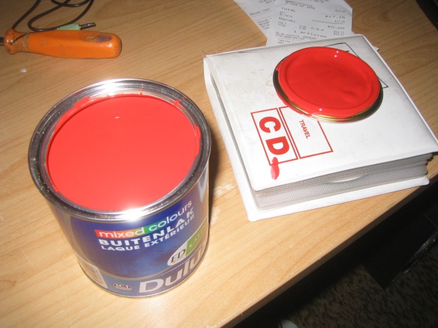

About paint, I took a look at the paint that my friend Bruno (DarthNuno) had mixed for me and I think the pictures say it all:
With flash:
And without:
Amazingly it's a 100% match under both flash and without. That's normally pretty rare. Well done Bruno and thanks !
I tried applying it with the technique that Bruno used on his cab. Although it hides the defects pretty good, I am planning on just repainting everything.
That will require masking of the artwork and repairing the sides with bondo etc.

There are several brands, I bought this one:
