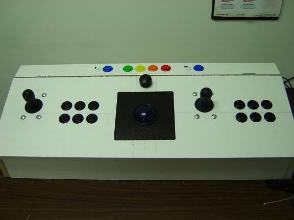

« Reply #7 on: December 15, 2006, 01:46:27 pm »
(I guess technically this is now a borderline "Project Announcements" thread)
The Box is built:
Open Top
As you can see in the last picture, I went a different route with assembling the MDF by going with "L" brackets....alot of them. I am amazed at the strength of the completed box, I even dropped it from 3' back on the table to see how sturdy it was, no problems. And the "L" bracket method made it quick to assemble, less than 20 minutes.
Next step will be the black paint, then Overlay form Mame Marquees, and of course the hardware and wiring last.

« Reply #8 on: December 15, 2006, 05:53:22 pm »
Whatever you do don't ruin the CP by NOT flush-mounting your trackball mounting plate...that is the #1 mistake I see people make and it just looks like ASS (in my humble opinion anyway)...
Box looks nice though...
EDIT: Maybe ASS is too strong a word...but it certainly looks much more professional when you flush mount and put your CPO over the plate....

I too did not flush mount my trackball. But what bothers me even more is visible screws for the joysticks. Is there a reason that people use nuts and bolts on wood mounted control panels rather than wood screws from below?
Not only are the screws a distraction, they can eat up your hands while you're playing! I say, screw from below (with wood screws) if you have a wood Control Panel.
Joseph Elwell.
FrizzleFried
  • Posts: 5159
    • Idaho Garagecade
Re: Re-Vamping my Control Panel, any advice on my concept designs?.......
« Reply #10 on: December 15, 2006, 08:01:45 pm »
Wood screws pull out...
Use carrage bolts as you normally do but counter sink them too.  It just takes a drill and about 1/10" to drill in so the bolt heads are flush...then you can lay your CPO over it and they will not be seen.
Thanks for your opinion, however, some of us actually like the trackball plate. Not flush-mounting a Trackball does not ruin a CP, it's all a matter of taste.

Postal:
Look at your current CP.  If your trackball was sitting flush and the CPO covered the plate,  just think how much nicer it would look...
Personally,  I can't see paying so much for a CPO...so I went with a plexiglass top...but still flushmounted the CP,  countersunk all the bolts...etc.
I think it came out decent...for a first try...
postalp123

From my own experience: You WILL catch your fingers on that spinner knob playing Golden Tee.
--Chris

I have a similar setup and I use the trackball with my right hand.  When playing golf, my hand hits the player two joystick.

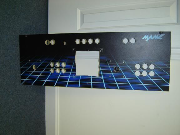

Managed to get it almost complete over the weekend, functional at least:
The old CP:

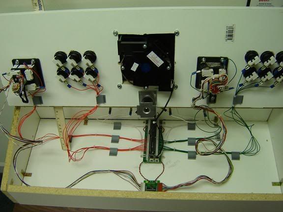

WARNING: Disclaimer, what you are about to see are the hideous remains of the worst wiring job I have ever done, prepare yourself!:
The new shell carved out and ready for the hardware:
Joystick Bases, Buttons, Trackball & Spinner Installed:
I-Pac 4 & Druin Board Mounted:
Wiring Installed (Red=1P, Green=2P, White=Admin, Coin, Start):
HAPPs Rotary's Installed and Connected to the Druin Board:
Ground Wiring Installed (Black):
VOILA-ish:
Still have the asthetics to do (Painting, Overlay should arrive soon).
I tried her out, and I must say, everything works great! The spinner doesn't get in the way of my Golden Tee Madman-like trackball use. And since I mounted the spinner directly above the trackball, I play some driving games with one hand on the spinner (Steering) and the other on the trackball underneath (Analog Gas Pedal) it seems to work rather well.

Mmmmmm, I don't play golf but I can tell that spinner is too close.  Alas.
Although I agree that it's close, I haven't hit it yet.
The other thing I noticed was that you got a little loose on the cutting, and at least one side pops out from beneath the top.
Don't quite understand what your saying here?
FF: nice-looking panel....my caveat is the sticks and button sets seem a little far forward for play.
Unless your a midget, they are right where they need to be. the whole purpose of this rebuild was to make clearance for the rotaries which need roughly 5" underneath the top. The CP is actually angled as such to allow your hands/palms to comfortably "Rest" on the surface as you play, Ergonomically if you will.
Thanks for the thoughts though.
