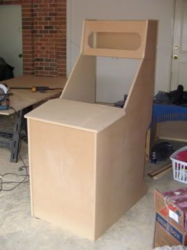

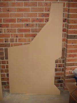

Hey all,
I've started my Atari Gauntlet 4-Player build. Here are some pics:
I'll add more as I complete more of it  :)
Next up I'd like to build a System 1 cabinet, but I don't have any plans  :(
So if anyone has any PLEASE contact me
The 80's is what it's all about.....
Steve

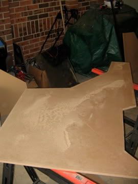

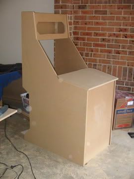

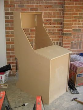

« Reply #1 on: August 05, 2006, 10:54:13 pm »
Did a little more work today. Here are a few more pictures:
Hope to have the artwork and controls this week  ;D

« Reply #2 on: August 06, 2006, 12:39:50 am »
Hey Steve - lookin good!
You owe us a story! First off - why gauntlet? Also, are you working off plans? Whats your timeline? What kind of controls? Or... are you being mysterious on purpose?!  :)
Ok. I'll try and answer your questions in order:
Why Gauntlet - Well I used to LOVE this in the arcades  ;D I'm a HUGE 80's fan of video games (and music)
I'm working off the plans on the Jakobud site, so I hope I get it right.
I don't have a timeline, but the sooner the better I say  ;)
As for controls, I'm going to use the Happ color coded ones (Yellow, Green and so on)
This is also a dedicated MAME cabinet just for Gauntlet (Might build a Gauntlet II one as well)
I'd love to build a dedicated Marble Madness, Temple of Doom and Peter Pack Rat but I can't find any System 1 cabinet plans.
Also, I plan on building more dedicated cabs in time to come. If I can't find any System 1 plans then either a Juno First or Rolling Thunder cab (once again need plans)
Hope this helps answer your questions

Bit more info.
I'm using 3/4" MDF for the whole cabinet (except for the monitor surround)
I'm going to cover it with melamine and place the artwork on that. Unsure how I am going to mount the joysticks, I might have to route out some of the MDF so they can fit.
Adding T-molding, Perspex or glass and a 21" CRT computer monitor for the display. I'll use a old Pentium III 1Ghz PC for the brains and some good speakers.
Coin-doors will be added too  :)

« Reply #8 on: August 06, 2006, 05:40:33 pm »
Looking good ..but, what's the depth of that beast actually? I could never have something that deep in my (current) living room  :'(
Steve
  • Trade Count: (-2)
  • Posts: 139
  • Last login:June 24, 2009, 06:18:34 pm
Re: Atari Gauntlet - Ground Up Build
« Reply #9 on: August 06, 2006, 06:46:02 pm »
38.375
Thanks for the kind words guys  :applaud:
Veinman, I'm just about to purchase the artwork from Arcadeoverlays.com and I have the front player/coin art (above the coin door)
Leapinlew, yeah I have a little bit of space  ;)  I could add in more games, but I just want a dedicated cab for now.
Psychotech, the depth is 38.375" and I am in a 4 bedroom house and there is only me and the Mrs  8)

Gotta love that sawdust on the garage floor!!
Well the sooner you help me mount the monitor the sooner I'll have more pics to add  ;)
Also, you can collect the 19" for your Jukebox  :angel:
« Reply #28 on: June 15, 2007, 07:01:20 pm »
Yep, it's finished, just needs the Artwork applied tp the sides.
I got the speaker grill made (cost me a bit too)
I'll try and post up some pics soon
