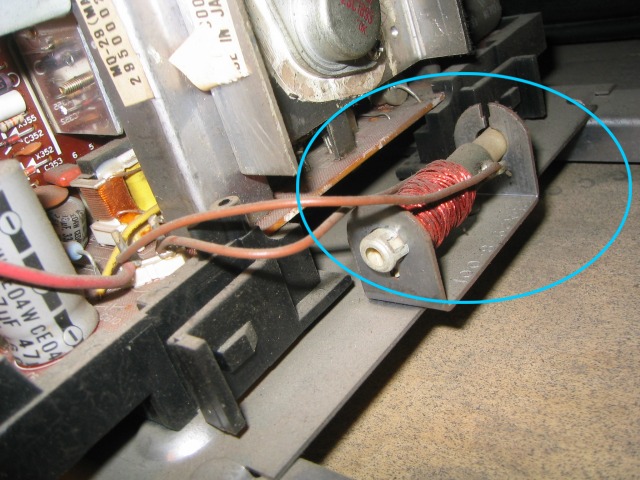

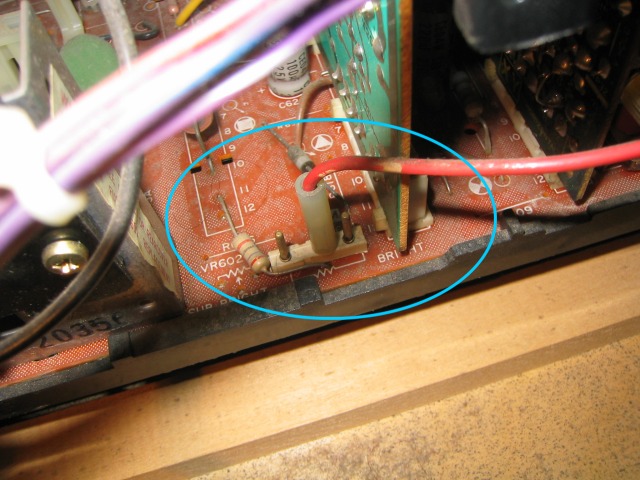

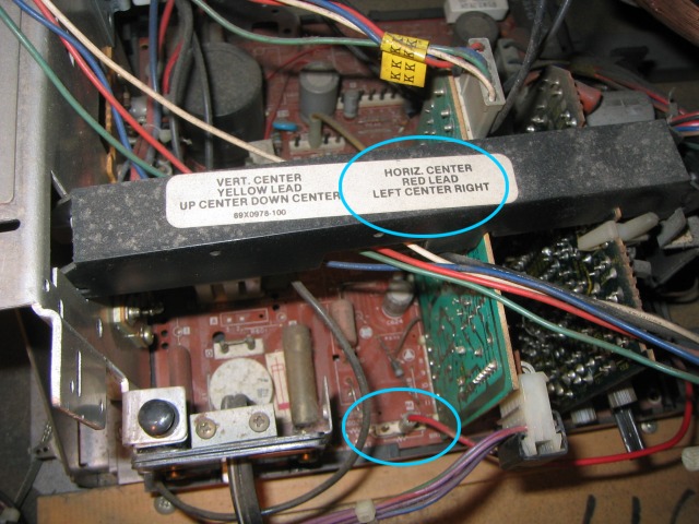

I've also an other problem with... the monitor  :badmood:
I can adjust the horizontal screen position.
A good part of the picture is missing... the left part of the screen... and I can't adjust it !!!
I suppose I've to adjust it with this :
THere is three pins to use, but when I plug the red wire on each of them, I see no difference :-(
That red wire goes to 2 pins, than to this coil :
Do you thing that coil is broken ? How can I check it  ?
Thanks for your precious help  :notworthy:

When It comes to Monitors I'm phucked...
I'd ask the question over on the Monitor/Video board..
I'm sure a Mr Layton or someone else will know the answer...

Is there a way to move something within the coil ? Maybe it's adjustable this way ?

Hi All,
I've submit my monitor problem question in the right topic, and it appears to be a Cap problem... I've ordered a CapKit for the monitor, I'll let you know if it'll fix the problem  ::)

...Capkit installed  :D
Now... let's play  :cheers:
