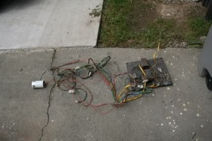

Sorry, no real "before" or "during" pics on the wiring.  But here is the cab and what was going on with the original board.

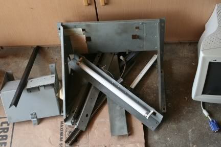

Gala-guts!!  Here's the harness and PCB cage I carefully removed.  I had actually left the cage in at first, but the Gallag board set is much larger adn I had to wrack the cage to hold it.  That caused the cage to short against the monitor frame!  Sounded bad over the speaker and then blew a fuse.  Took a little while before I noticed what was going on.   :dizzy:
All better now....

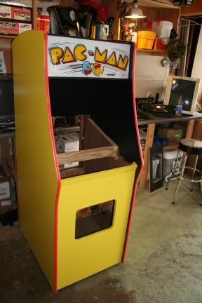

Here it is!  Eventually, I'll get new glass, but this works for now.
Now I need my CPOs and to repaint the coin door.
