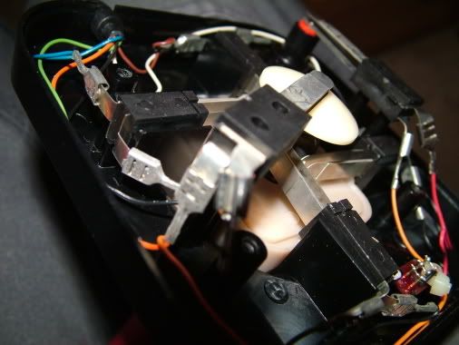

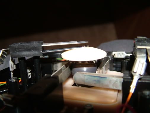

I am using a 3 LED "Lazer" cluster; $2 from SVC, with a clear 2.25" trackball. It is prewired with a standard 4 pin computer power supply molex. Took off the plastic casing and taped the LEDs in place. Looks great to me but I haven't seen any other lit trackballs in person.

Well I don't mean to hijack Divemaster's thread - in fact if I wasn't such a cheap bastard I would have ordered a real trackball and a "real" trackball lighting solution from him or Ponyboy; or better yet the new RGB trackball from RandyT and GGG. The LED bulb Divemaster sells sounds great and definately more professional than what I did.
I am using a hacked Kensington Turbo Mouse trackball with a clear "sparkly" cue ball that I bought from Paramount Industries. I am sure it doesn't roll as well as a happ or an imperial trackball but I figure it should get the job done and keep my wife from pulling the plug on my project ;-)
So attached are some pix of my cheap lighting solution using the "lazer" LEDs from SVC.com to light up my clear trackball. No idea how well this would work with a happs or imperial... Might not be bright enough - I don't have any experience with them.
But this method does the trick for me! The pix illustrate lit and unlit. It was a pain in the ass to get decent pix because of having to use a flash with my camera...
