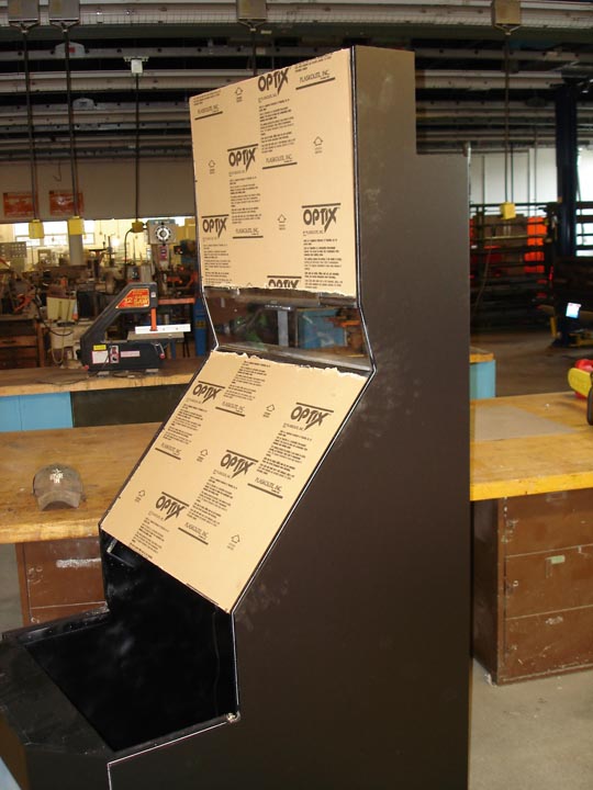

Now, for something rather exciting.  I started to make the jig to hold the plexiglass after it is heated.  Here is what I did:
First, I traced the curve of the cabinet onto a piece of paper and then cut out two identical boards:
Second, I attached the two boards and the paper together and drilled holes in strategic spots.  Next I cut dow rods to fit in the holes and put the jig together:
I hope to get to the bending before the weekend so I can paint the plexi on Sunday.  Anyways, more updates to come!

Well, I just finished molding the plexi.  All in all it went very well.  The top bend was bend a little cold, so there are two one inch hairline cracks.  One on each side.  I figure that I can put some sort of instruction or something on there.  It is really not that big of a deal.  I get pissed when I mess up anything and this didn't cause any sudden knee jerk reaction if that makes any sense.  It could've been a ton worse.  I'm going to attempt to route out the speaker areas next.  I'll be back tonight with more pics. :applaud:

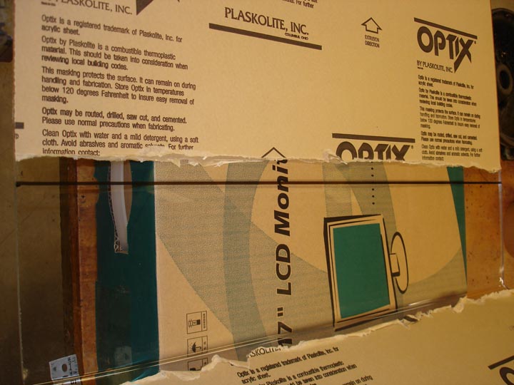

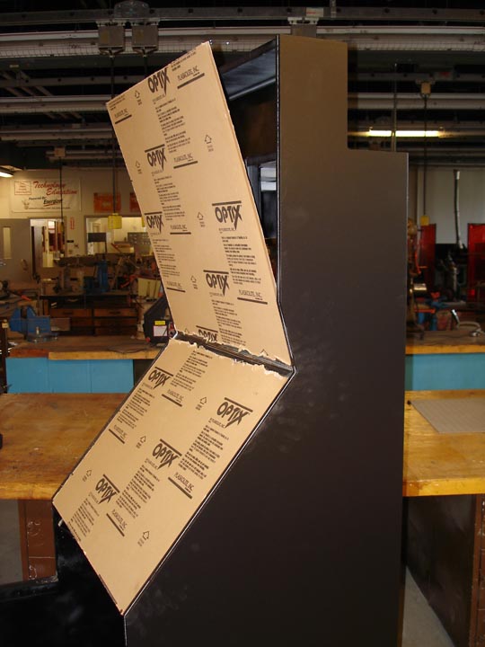

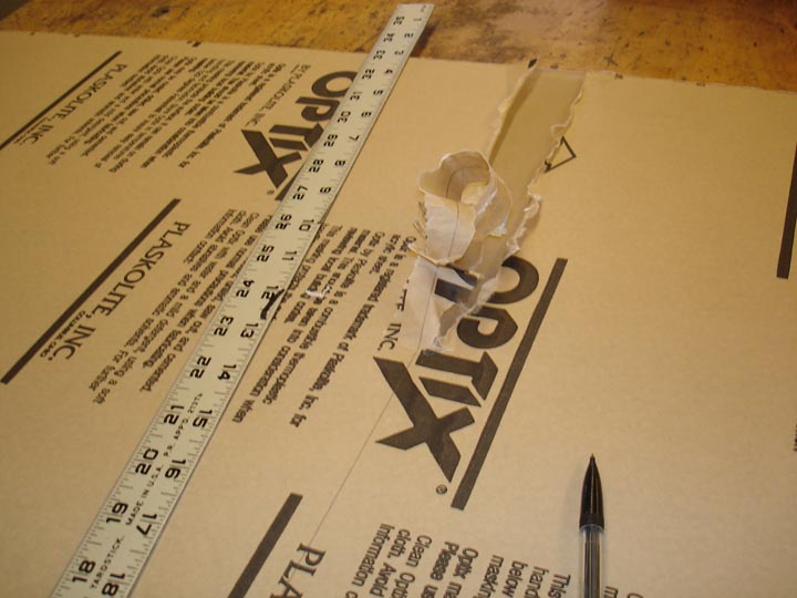

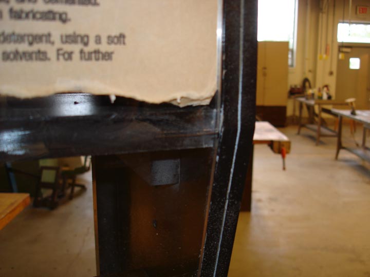

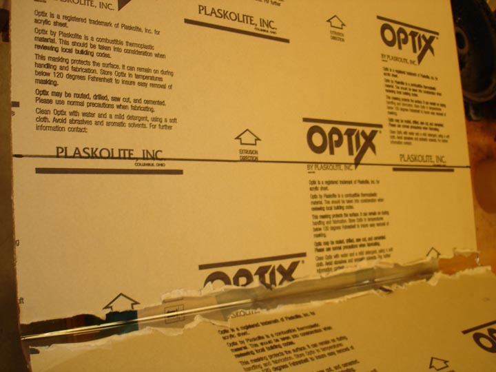

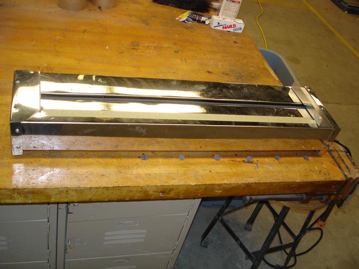

Today is a tribute to both Pixelhugger and Knievel.  They have both provided blueprints for our hobby that are of the first degree.  This is the best quality I could produce.  The plexi work is a reflection of the lead Pixel has set and the cp wiring is in tribute to Knievel.  I saw the work he did on the cp he made and it was very impressive.  I know there are plenty of others out there who have set the ground work, but these two specifically inspire me everyday I work on this machine. :cheers:  Now, an explanation of what I did today:
The first thing I did today was form the plexiglass to the contour of the cabinet.  After getting the angles correct, I decided to cut out the areas for the speakers.  Here is a pictorial of how I did it:
First, here is the machine that was used to bend the plexi.  Very simple, yet very effective:
I measured where I needed to make the bend and marked it with a dry erase marker and pealed back the protective paper:
I ended up not using the template that I made  :banghead: and used the cabinet itself.  I don't want to talk about it:
I marked the line where the next bend was to happen:
I peeled off the protective paper and transfered the marking to the plexi directly.  I erased most of the mark before it got too hot on the bender:
When I went to bend the second section, it cooled too quickly.  When I reheated it, I tried to bend it too early and that caused an inch hairline crack on both sides.  Here is the finished piece and a closeup of one of the cracks.  They will be easily hidden:
All in all, I was very happy with the results.  The bends are a perfect fit!  Since I've not bent anything bigger than a letter holder, it was pretty cool.  It seemed like so many things could've went wrong.  I can handle the two little cracks.

Here is the final product.  I love that look.  I would've liked a nice bezel in there with instructions or whatnot, but you can't beat the quality of the look it gives:

Thanks a ton man!  I honestly thought non stop about this project for about 8 months.  It has been neat as to how things are coming together.  I predict that I will be about 90% done in two weeks.  I have a bottleneck of things to do right now, but I should be out of the woods soon.
I am now trying to determine where to locate the volume control.  This is not fun, as I have prepared for most everything else.  Such a dumb little thing to do and such a pain in the butt!
