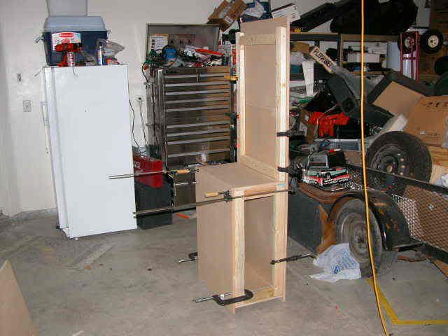

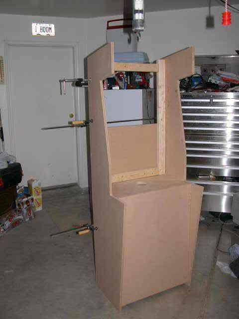

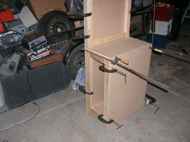

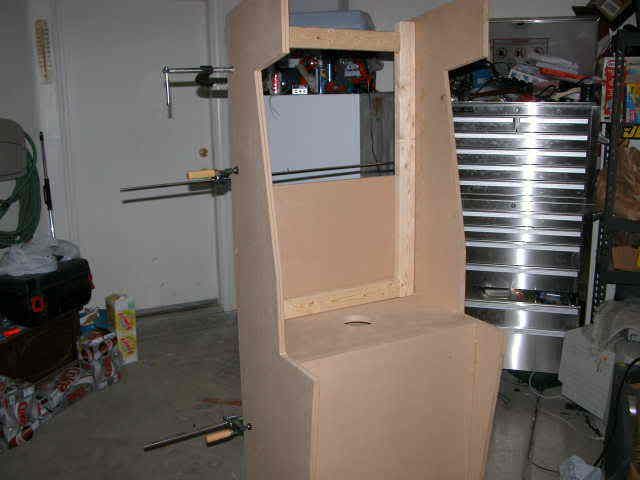

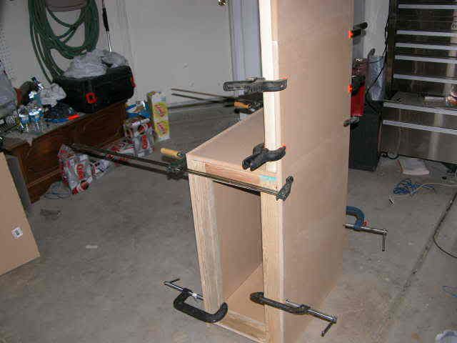

After I had the cab to where it could be easily moved around, I began working on  the big stuff. The old, burned-in monitor was discharged, removed and discarded.
http://img173.exs.cx/my.php?loc=img173&image=image359dd.png

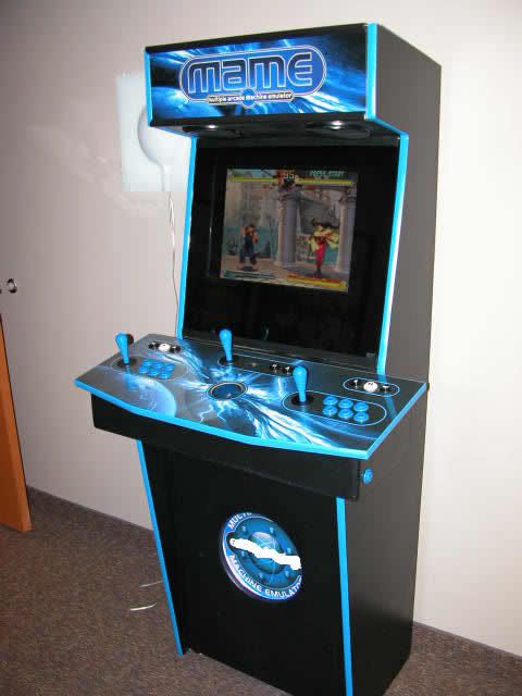

After about 3 months of on and off work, it was completed. Most of my time was tied up with the control panel, but my hard work finally paid off. I could play every game in MAME flawlessly, as well as HotD with minimal jitters.
Final result!
http://img223.exs.cx/img223/7402/arcadepics001small2hp.jpg
http://img54.exs.cx/img54/4985/arcadesummary9ei.jpg

After a few months going back and forth on different marquee designs, I finally came up with one I'm going to keep.
As for the CP, I'm still working on it, but I can tell I'm getting very close!
