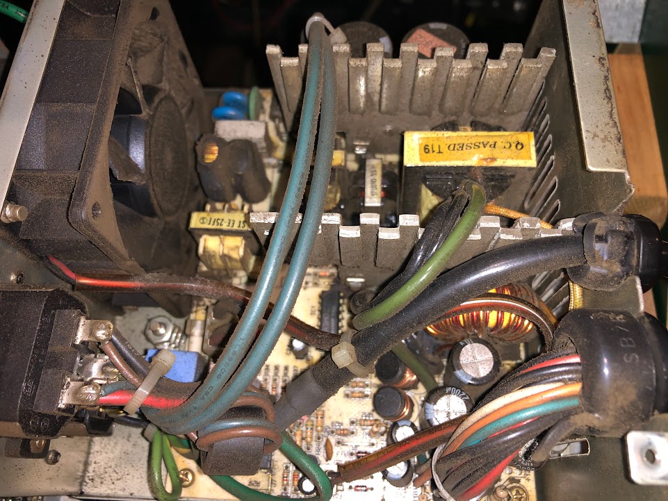

Quote from: Power Supply
Before
After

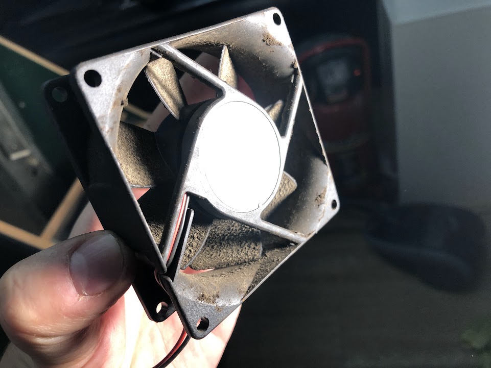

Quote from: Back Fan Restoration
Before
After

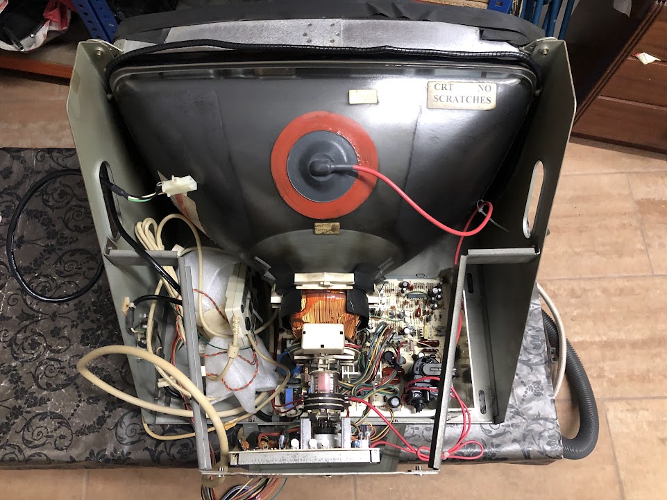

For the monitor... mine is fine touchwise and mostly fine displaywise but I have white lines that go across and one of the pots does not work at all.
I am nervous about repairing considering I know very little about how CRTs work and realize that they are very very dangerous. Am not finding luck finding a repair person. Do you have any documentation or guidance for what you had to do to restore your monitor?
lilshawn
  • Posts: 7515
  • Last login:January 26, 2026, 07:56:08 pm
Re: [Restoration] Megatouch Maxx Upright
« Reply #17 on: August 13, 2023, 06:54:33 pm »
they are called "retrace lines". it's usually an indication the the screen voltage is turned up a little too high on the flyback.
on the high voltage transformer you'll find 2 adjustments. one will be "focus".... the other "screen". turn down the "screen" a tiny bit till the lines disappear and the black is black again.
