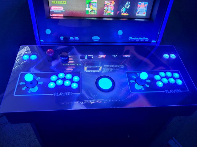

This stuff is hugely helpful for me. The 220 ohm resistors arrived so I'm going to wire them up this afternoon if I can ever get off of these work calls...
I found a thread on reddit HERE where someone was wiring volcano buttons and was using the 220 ohm resistors as well.  The wiring is a bunch of spaghetti but if I stare at it long enough I should be able to figure out which wire goes where (ground vs. the hot wire).
The final results make the LEDs look a bit dim but would be plenty good enough for me.  Is this what you guys are arguing about?  I assume the bigger the resistor the less power that gets through so the dimmer the LED will be?  But if you let too much through you will blow the LED?
