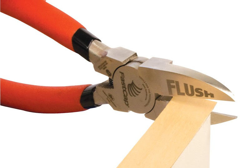

Thanks.  The second set of hands was key.  Got the vinyl down and trimmed.
Now I'm messing with the t-molding... I can't seem to make a 90 degree cut.  Not a 90 degree turn with the t-molding.... I mean cutting a piece of t-molding off of the roll at a 90 degree angle.  I'm using a razor but it's always slightly off.

« Reply #175 on: July 06, 2020, 07:05:31 pm »
There’s these:
https://www.t-molding.com/flush-cut-trimmer.html
« Last Edit: July 08, 2020, 12:14:11 pm by Arroyo »
Re: javeryh's Nameless Cabaret Copy
« Reply #176 on: July 06, 2020, 07:13:26 pm »
I've got one of these from Lowes and they are fantastic for cutting T-molding.  Doesn't look like they sell them anymore though.
https://www.lowes.com/pd/Kobalt-2-Piece-Multicutter/50074273
These from Amazon look similar.
https://www.amazon.com/Sheffield-1283-Multi-Cutter/dp/B072HJB9BC/ref=sr_1_1?dchild=1&keywords=Sheffield+1283+Sh+Multicutter&qid=1594077131&sr=8-1

The spine of the t-molding gave me trouble cutting it 90 degrees.  Use the razor to shave off the spine so there's little to no material left of the spine.  The 90 degree cut will be easier to control.

Those flush scissors look awesome.  I got frustrated and just ended up eyeballing it.  Came out OK - can't tell unless you really look for it.  I mean, I probably made a 90.5 degree cut across 3/4" so it's negligible.
You are now reaching Arroyo levels of persnicketyness. I reserve the right to make up new words or add extra letters to words when the need arises. That will probably make both of you itch too.
Of course that level of care and attention to detail leads to the cab you built. Very nice work top to bottom.
Atari made some cabarets with 19 inch CRTs. So I wouldn't be too worried about what size you shove in there as long as it fits. :o
Ha thanks.  Arroyo and I are practically the same person except he's better at this stuff than I am.  It's hard for me to let go when something isn't "perfect" even though I know it doesn't matter at all to anyone.  I hate noticing imperfections everywhere I look.  I'm working on it.
