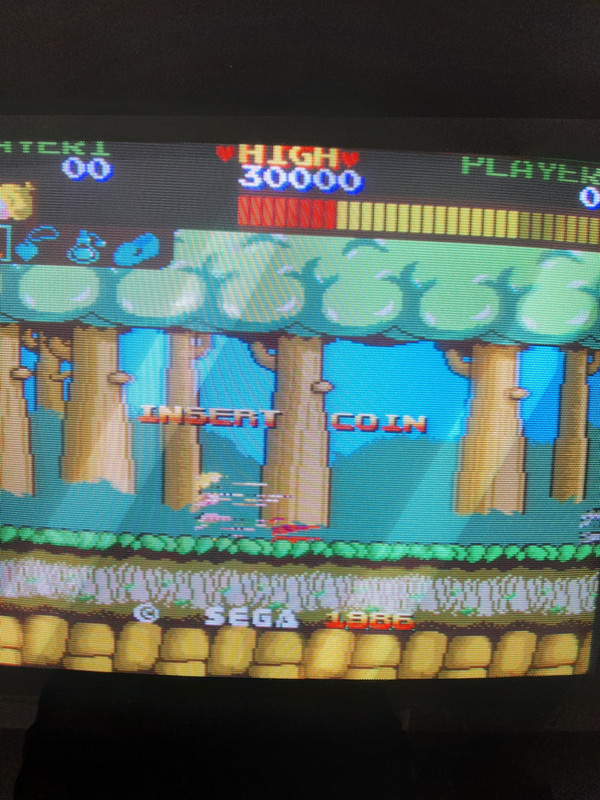

Nice pickup!  Love that game. Looking forward to seeing the progress.  So paint for the sides?  Was the original painted or vinyl, or do you just prefer paint?

Good catch on the monitor.  It looks even better in person.  I was a little on the fence going to look at it but when the seller fired up the cabinet and I saw the monitor I said I'll take it!
