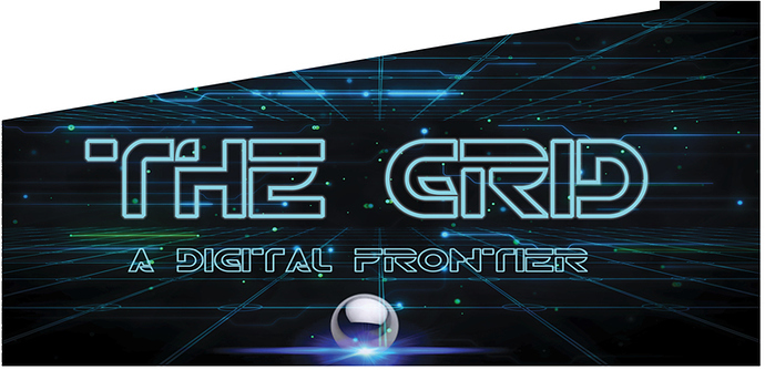

Hello All,
I blame Terry Red for this, but after looking at his build and him practically mentoring through.  Rablack97 came up with this...I'm still amazed it's come this far.  Sorry for the lack of documentation, was deep into the build.  I posted this to also open discussions for others to ask questions if they are partaking in the same wormhole of a project.  I will have to say building these are super fun and learning experience.  A few shots,  I'll post more if folks want to see more of the internals etc.  Posting photos on here is a PITA, i get burned out too easy after the first post.
This is a Terry Red (big ass backglass) modified design, that I cut on CNC, pockets and only 12 1"finish nails hold this together, no screws.  3/4" melamine mdf core black on black.
So this has, high level
Full DOF feedback - 10 solenoids, shaker, gear motor  (do not buy a gear motor, its a waste of money and offers no purpose)
Addressable leds
DIY Pin2dmd (real dmd)
Digital plunger
3 screens
xboxone kinect for BAM mode
5.1 surround sound system
i5 with gtx 970 8 gb ram
250 ssd + 1tb harddrive worth of tables
Anyways, there ya go if there's interest I'll post more frequently otherwise, just wanted to show what im up to these days.
