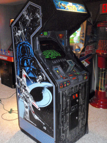

Thanks a lot for the compliments, guys! I’m happy with the way it’s turning out so far in spite of a few hiccups.
As you probably noticed in my last post I was able to get the coin door installed. It’s an original Coin Controls over/under that I found on eBay in really good shape. All I had to do was give it a nice scrub and install new bezels and reject buttons I bought from Twisted Quarter. I whipped up the reject button inserts by modifying one that I found over at the KLOV forums in this thread.
It’s a little difficult to make out in the picture, but I put felt over the batons that the monitor glass lays against to keep it from getting scratched. I originally used the “loop” side of adhesive backed Velcro, but it was a little too thick and made the glass push too hard against the speaker panel. After taking that off with Goo Gone, mineral spirits, and 30 minutes of immense frustration  :cry:, I cut strips of felt the width of the batons and adhered them with some spray adhesive. The glass lightly butts up against the speaker panel which is what I was going for.
I also installed the control panel clamps.
Oh, and how could I forget the arduous process of painting the sides lol. It took about 5 coats of primer to get the sides smooth. There were a handful of grooves that had to be smoothed out. That’s what I get for using cheap ply from Home Depot. Next time I’ll fork over the extra $$ and get better quality sheets. The sheen isn’t perfect, but it’s smooth enough for side art – that’s all I care about lol. So here’s what she looks like at the moment. Try to ignore the slurpee straw and furniture movers under the feet lol. Next up, paint the inside of the monitor glass and start on that marquee.  :)

So I'm getting my marquee retainers ready and I want to drill the screw holes, but I'm not sure how much room I should give for the marquee. I originally thought of sandwiching the marquee art between two 1/8" pieces of glass. That means I need to allow for at least a 1/4" space. But now I'm considering having it reverse printed by Brad. So I have 2 questions:
1. Do you know how thick the plexi is that brad uses?
2. Since the vinyl is adhered to the plexi, do I need 2 pieces, or just the one that it's attached to?
Thanks in advance, guys.

His reply was, "The thicker it is the better it looks...I'd go 3/16" if you can."
I'm assuming you don't need another piece of plexi since the reverse printed screen is adhered to the one he provides. I'm going to install the retainers with 1/4" allowance to be safe.

Hi guys, sorry it's been such as long time since my last update. Life has been crazy and I was addicted to the new Zelda game for about 2 months lol. Anyway, I special ordered these angled aluminum pieces to use as my marquee retainers. I spray painted them black, but still need to drill the holes for the hardware. I think they'll look nice.
I also sprayed the sides of the monitor glass with black primer:
Using an LCD TV has its cons, one being that the black bars on the top and bottom (or sides, if your tv is mounted horizontally) aren't completely black, which kinda bothered me. So I bought some of this stuff:
I cut it to size with a razor blade and straight edge and adhered it the the TV. It took some finesse, but I was able to get it right by my standard. Here's how it turned out:
I took a photo with the TV on, but it doesn't show the difference that's noticeable in person. I'm happy with the result.

Thanks, actually my cabinet is finished  :) Check my signature link if you'd like to take a look.
Great side art graphics! Really has that old school arcade vibe going on and great throwback to the original Star Wars cab below, but still with it's own identity, very nice. I like it with the logo included best, but without looks great as well.
I don't know why, but in my mind you had yet to install the side art. lol. Your cabinet looks fantastic.
Thanks for the kind words!

Only thing you might want to do is change the lasers on the X-wing as they are suppose to be green.
[/quote]
I totally thought that, too, before this project. Actually, the tie fighters (and rest of the empire vehicles if I remember) have green lasers. The rebels' vehicles have red. It's weird that they would reverse the colors like that since the lightsabers are the opposite.
[/quote]I stand corrected. Me being a big SW geek I totally forgot the empire lasers were green. Good catch!

Looking really good! I honestly think you can go either or on the art, but would lean towards with logo, if I had to choose. I'll be posting an updated picture of the art for my cab soon, also drawing inspiration from the Echo Base cab and other classics. Just curious could you take a close up picture of the piano hinge from the outside of the CP ? I'll probably be using one as well, but want to see how visible the hinge is from the outside. Keep up the excellent work. :applaud:
Thanks, man! I’ll have to keep an eye on your build! I’ll tey to take a pic of the piano hinge today. Gotta move some boxes waiting for Christmas haha

If it were me I'd 86 the logo, doesn't feel right to me.
Smh at green lasers... c'mon man everybody knows xwing lasers are red.

I think that sideart is perfect without the logo. It doesn't need a logo to balance it out, the design carries the eye up the side of the panel just fine and the logo gets in the way IMO.
Here's a picture from the outside. You can see it if you bend down or from afar, but not when standing close to it. It's pretty well hidden painted black, but I don't mind if hardware shows a bit as long as it doesn't stand out like a sore thumb. Of course, you can make adjustments during installation to show less or more of it as you prefer.
