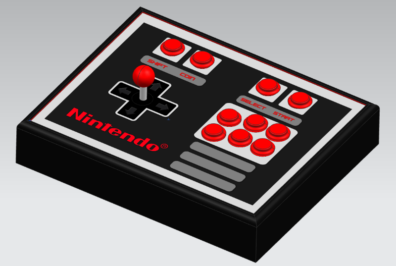

I thought my portable game gear project was fun, and even though i have an HDMI out on it, i really want to use actual arcade controls for games on my TV.
I initially had plans for a 6600 mah battery to power the Pi so that there would be one less cable coming out of the box, but i am putting that on hold for now. I can easily route the power in to a powerboost and then attach that to a battery in the future.
parts list to buy:
sanwa JLF joystick
bright red ball top
sanwa 30mm buttons x 6
sanwa 24mm buttons x 4
Raspberry Pi 3. I have a pi 2, but i wanted to have the fastest interface and be able to play the most games.
HDMI and USB pass-through
power input. I want to use a barrel jack rather than USB to input power. This will give it a more consumer electronics feel.
1/4 inch mdf sheet 2 x 4
1/2 inch mdf sheet 2 x 4
11 x 14 acrylic sheet x .093 inches thick
here was my initial concept drawing and I've pretty much kept everything the same. I probably don't need 4 admin buttons but i like the symmetry.

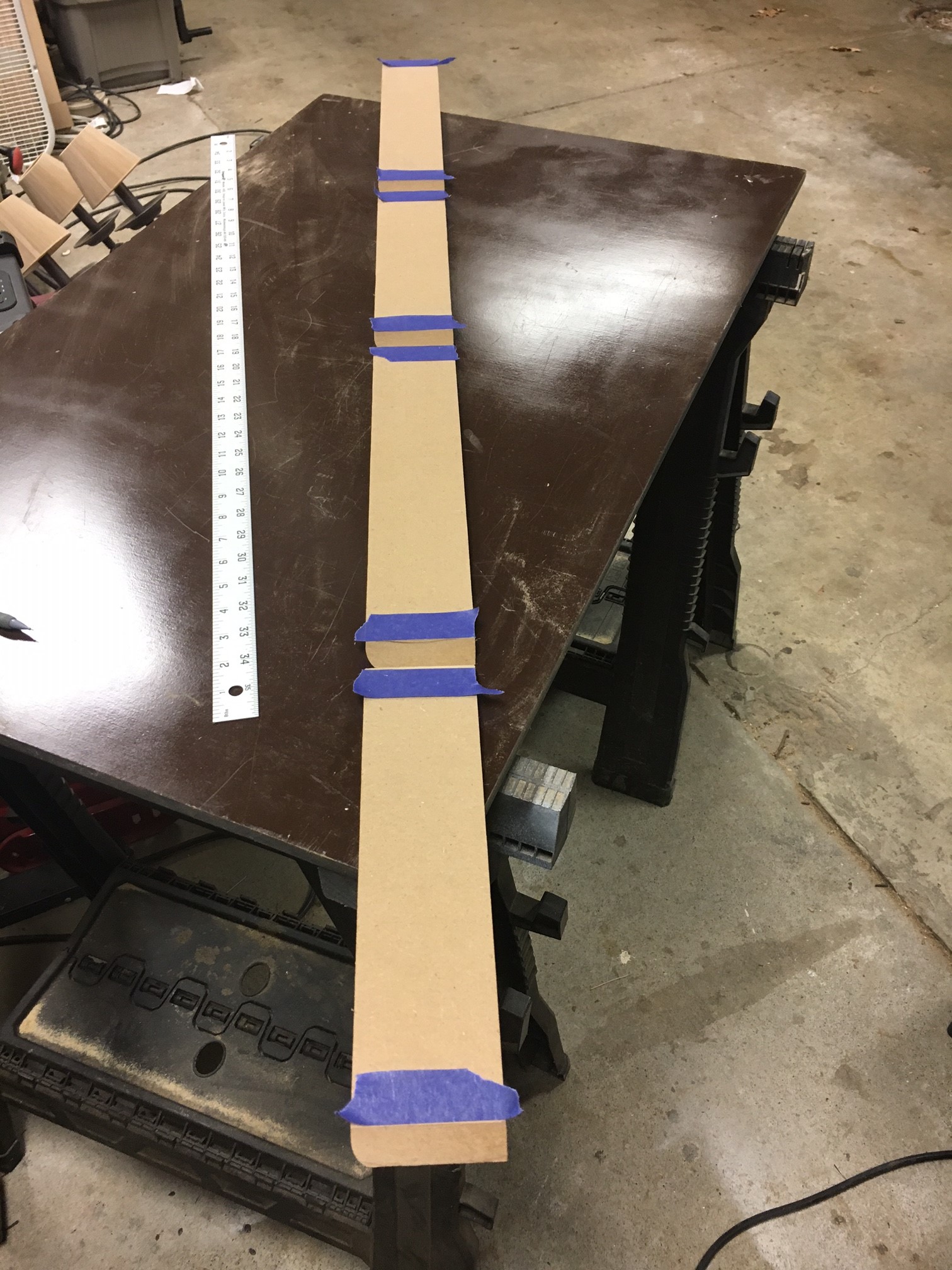

after screwing up the squareness of the box the first time i found a youtube video to do this little trick for 45 degree miter cuts. use painting tape (frog tape) to create hinges so that when you glue and then fold up the 4 sides you get a perfect edge. the blue tape here helps to trap any glue that squirts out. nice and clean
