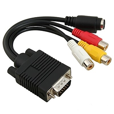

Hi Everyone,
can someone tell me if there is anyway to connect an arcade monitor to a desktop PC?
What I'm trying to do is use the Monitor from a Tekken Cabinet I picked up, and connect it to my MAME Set up ( I have MAME set up on my Desktop PC )
Is there any way to do this? or should I just get rid of the monitor and use a new LCD monitor?
I would love to use the Old monitor, to keep the style of the cabinet.  I attached 2 images of the monitor
any help will be appreciated!!
Thanks everyone :)

Since you're asking this question, best answer for you is to visit Ultimarc.com and look into picking up a ArcadeVGA card.

Nooooo. Whatever you do, don't toss that beautiful CRT!!! In any case, this whole site is dedicated to interfacing X to an arcade cabinet. You have 3 options to interface Windows to an arcade CRT machine:
  • ArcadeVGA, which I described above.
  • Soft15khz, doesn't work with all cards, but can prove to be a quick solution.
  • Calamity's CRT Emu Drivers, Radeon HD4000 card, GroovyMAME
  • A VGA>CGA convertor, but this is the worst possible way to do this
All of these solutions, especially if you are using HyperSpin, seem to work better in WinXP not Win7. In all honesty, the best solution is the 3rd one. Simply pick up an HD4350 card off eBay for ~$20 (a higher HD4000 series card is overkill). Calamity's drivers now allow you to use HD5000 series cards, but only under Win7. Do some reading in your free time. Ultimately, if done right, the ends will justify the means and you will have exactly what you want even if it takes a while longer to get there.
