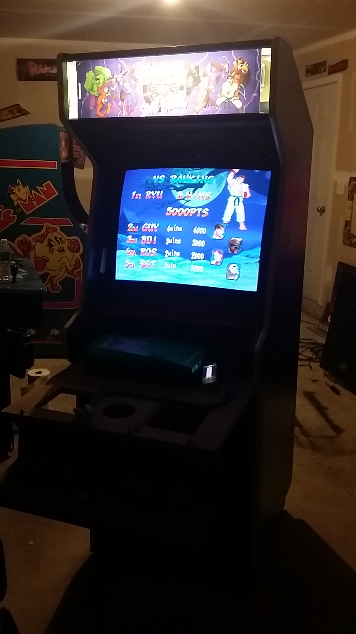

« on: December 28, 2015, 08:11:58 am »
I plan to keep this one, forever, right next to my MKII in my rape dungeon.
This is how I got it:
yes, it came with a 161 in 1 cart. First thing I did was remove the 2 slot marquee and put in my bust a move marquee that Ive had for about a decade.

What did you do with the labels on the front?  Did you make new ones or use the old ones?
Used the old ones......for now.
Cool.  If you find a source/method for new ones, I'm in for a set.
Out of interest do you know what joysticks/buttons were native to these cabs?
Factory sticks were either happ ultimates or happ comps, depends on who you ask. Ive personally gotten more Neos with Ultimates than anything else. This cab has Sanwas and I lub them for neogeos.
Thanks :)
