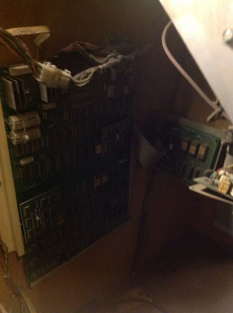

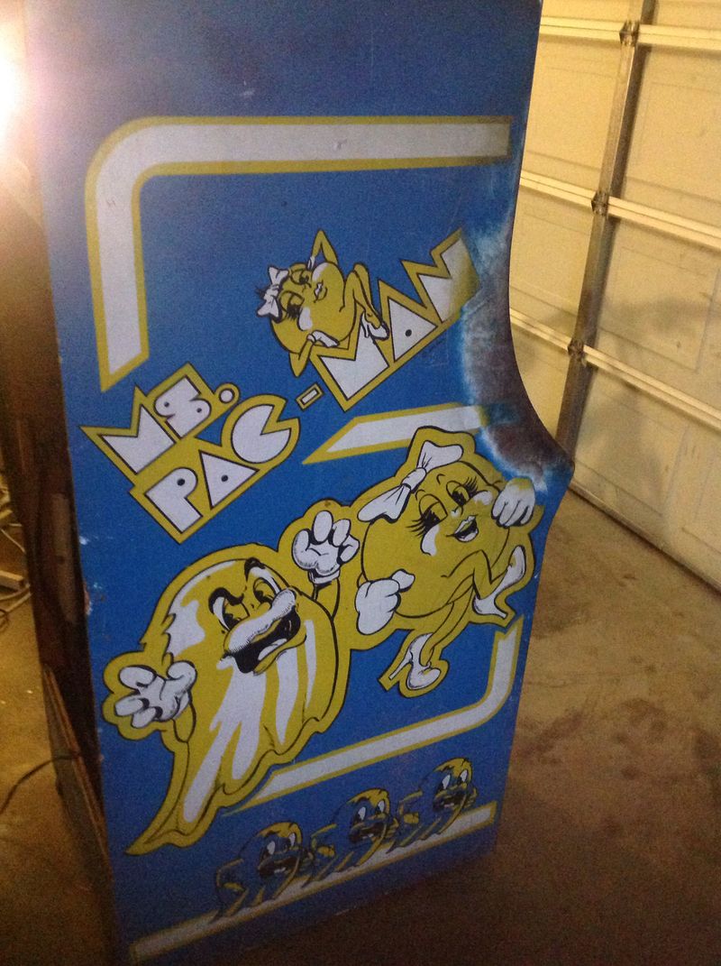

So while I am awaiting my capkit for my other project, I pulled the second arcade of my recent haul out of the storage building and started working on it. It is one of two Ms Pacman machines.  At first when I plugged it in, it came on but with garbage on the screen. I decided to clean the thirty-four years of dirt and grime out of it so I could get a closer look at what is going on.  After vacuuming that out, I pulled back the safety switch and the screen went to a test pattern and then the game fired right up! I did notice that the joystick wants to stick to the left, but I bet with some cleaning that will go away.
The color on the screen wasn't perfect but I couldn't find where to adjust that. on the monitor. I will have to take a closer look and see what is going on with it. Other than that, I just need to fix the lights and the cpo.  I don't know if it would be worth it to try to fix the artwork. If I try to repaint it, I will have to fix all of the wood on the whole cabinet and then get the stencils.
Can anyone tell me what is going on with the PCBs? Does it have a speed chip on it? I ask because Ms Pacman is flying through the maze.

You can see the damage the coin door has from being on location. Someone had tried to pry it open.
These internal shots are from before I cleaned it.

« Reply #1 on: July 16, 2015, 09:59:28 am »
i like the patina of ages cabs, I wouldnt mess with the outside much unless there is a structural issue.
If MsPac is flying, it prolly has the fast rom installed.  Do yourself a favor and get the sixpac from the guy at KLOV turns pacmanor mspacman into pacman regular, pacman fast, mspacman regular, mspacman fast, pacman plus regular and pacman plus fast .
http://forums.arcade-museum.com/showthread.php?t=153189
I bought one from Mark and I love it.

« Reply #2 on: July 16, 2015, 10:30:51 am »
Well, structurally, the cab is fine. The only issue is the back panel has to be screwed on and there are a few chips missing here and there. These cabs were on location for a long time, so its a wonder that they look this nice. I agree that the aged look looks nice, so it probably will stay this way.

« Reply #3 on: July 16, 2015, 10:37:00 am »
you just pull all the roms, install the 5E from the kit, move the Z80 fromt he daughter card to the main PCB, and put the kit on the extra edge connector. Takes about 5 min

« Reply #9 on: July 16, 2015, 11:01:53 pm »
You might want to turn your blue drive down on your monitor.  The Six Pac kit is nice.  If you're handy with modding boards there's a 4 pac DIY mod that's just as nice out there but you'd need to do some soldering and burn some roms.
