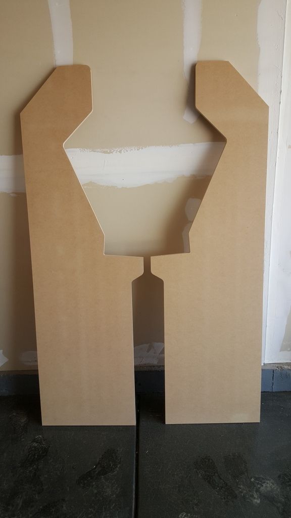

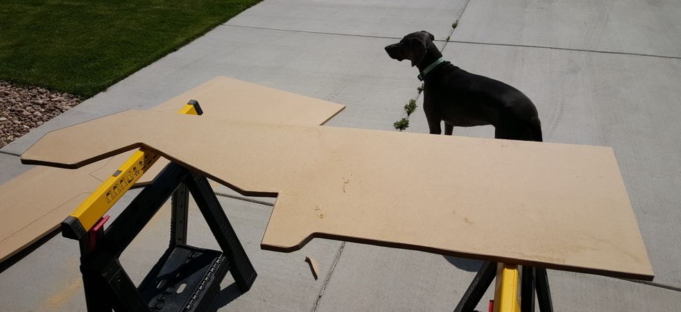

So far I only have the sides ready to go. I had a PVC template made at a local sign shop from ChanceKJ Arcade sides CAD file. Traced the template onto 3/4" MDF, rough cut em out with a jigsaw, then finished em off with a router. Man that was crazy simple! I hope the rest goes that smooth ;)

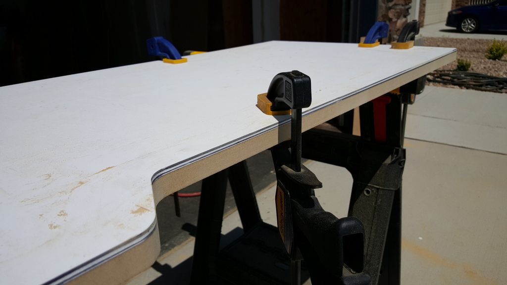

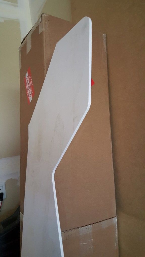

Well it's been quite a while since the last update. So here it goes.
Coin door is fully assembled...although I realized I'm missing all the coin door mounting pieces. Those little clips that attach the door to the panel itself..have to track those down somewhere
After it was all assembled I found out about these 3D printed AnyCoin V2 mech replacements..had to pick em up...not sure if I'll use them or not however
Finally getting down and dirty with the build itself!!!
Started out with the CP base since I figured that would be the most challenging with all the angles. Turns out it went pretty well..although I did not like how far the front of the base protruded so I top mounted that piece and routed some of it out to clear the track ball. then I routed out 1/8" off the CP bottom so the trackball will sit just right with the trim ring on there.
Next up was the cabinet base. That was a fun one to build! Especially routing out the room for the wheels...What a mess...hahaha!
Next up was getting the ledgers on the side panels..Wasn't as easy as I thought it would be but it's close to being done
Also in possession of some of the remaining pieces for the build
Then after a couple tweaks on getting the artwork 100% aligned I got it all printed out. Man this looks really nice!
Now...back to the build. Hoping to get painting late next week, but I guess I'll see
« Last Edit: July 13, 2017, 09:17:10 pm by Scotty_C »
