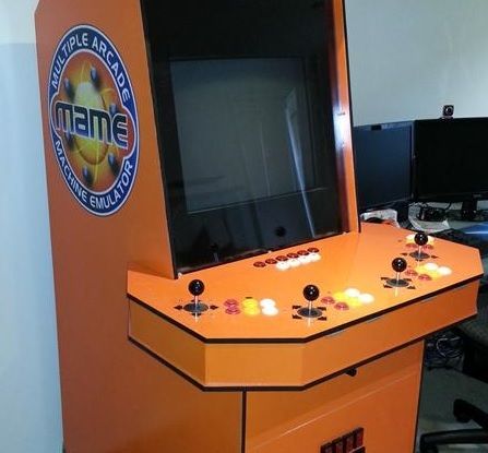

Here's a quick update - We finally had an afternoon to cut some wood last week. Nothing too spectacular to see yet. I think the only interesting part of this build is the PS2. We did install OpenPS2 Loader on the the PS2 and have been testing several games. It works pretty well. When you turn on the PS2 you're presented with a list of available games and they load fairly quickly over the network.
We only need to cut the piece for the speakers above the monitor and the monitor support bracket. Then we just need a couple hours for some putty/sanding and then we'll be ready for paint.

« Reply #24 on: July 06, 2015, 04:13:37 pm »
Had another day to work on the cab. It's about 95% done now. Just need locks for the coin doors and some adjustments to the drawer hardware. So here it is:

« Reply #25 on: July 06, 2015, 04:19:52 pm »
That's an extremely clean looking build - lovely woodworking too. Congratulations  :cheers:

More details...
The cab's design is somewhat common, so there's not much to say about it. The unique part (the PS2 running commercially available arcade roms) is still a bit of work in progress. The PS2 itself works very well and the arcade ports appear to be the actual roms in most cases. The control panel is powered by a bunch of minumus AVRs running the Kade software. They work very well, but we needed some kind of solution to mount them to the CP. So we modified a piece of wood L-moulding and added a USB port saver to make it easy to mount and remove the minimus.
To avoid killing the optical drive, and to avoid handling the discs, we were using a soft-modded PS2 that was using OPL to run the games off of a network drive. We've recently added a "modder" PC from TKW4rr10r to the cab and we've been testing using emulators for the PS1 and PS2 games to make the process of selecting and changing games more convenient. The PC is running GameEx, but I've been tinkering with Mala as well.
