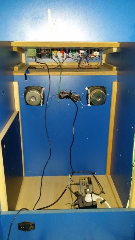

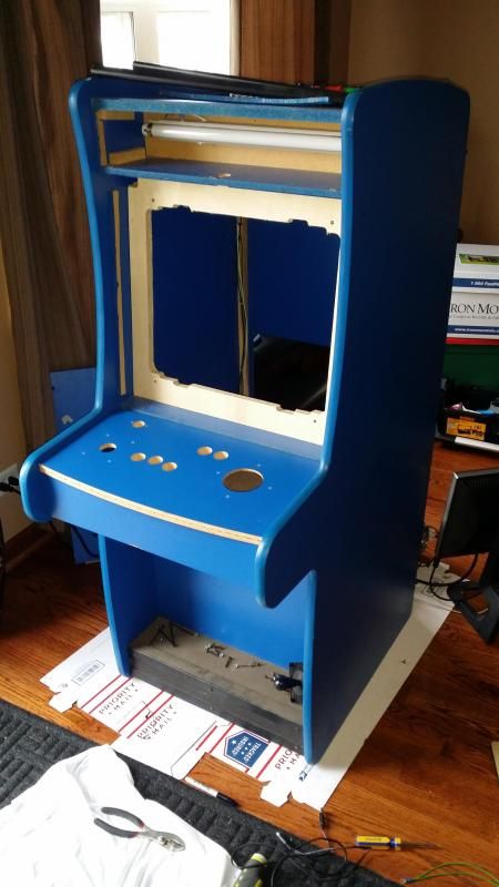

I recently acquired a "KIDKADE" cabinet that was made in Schaumburg, IL by TLC Industries.  It's a smaller cabinet at about 50" tall obviously aimed towards kids but it makes a perfect sit down adult sized cabinet as well.  At some point someone had converted it over to MAME and when I received it there was no monitor or interface for controls not to mention the MAME computer was not working properly.
I'm thinking this could make a nice little MINECRAFT machine for the kiddies since the CP already has the left joystick and trackball slots.  I can increase that three button setup to a clean 7 or 8 button set up.  I would just make a custom CP for this but it's actually glued into place and is not removable.  I actually have to go under the CP and remove a small panel to access buttons, wiring, etc.
My biggest challenge on this is going to be me not ever really playing MINECRAFT so I would appreciate any input on very basic controls so I am not relying too heavily on the input of my 9 year old son!
Here are some pics (the first being the company stock photo of this cabinet) of the actual cabinet followed by complete tear down of this cabinet.  So this will either be a fun project or a disaster and a waste of time, lol.

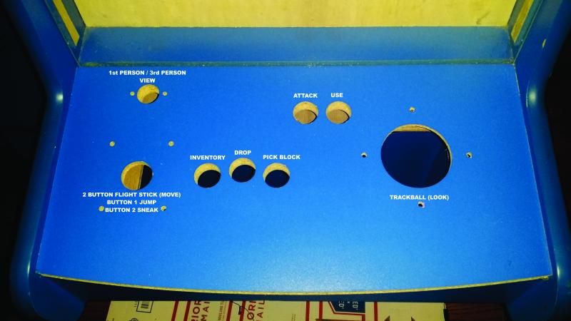

Well, according to this site, you need to account for the following essential controls:

Assuming you can re-map the last two to button presses, you'd need a minimum of joystick, mouse, and 9 buttons, unless you start getting into shifted function buttons. I dunno, maybe some 360 controllers hooked up to a PC would be better.

I was looking into that and came up with mock up 1 of the CP.  As far as the "Options" menu goes I think I may want to keep that kind of hidden so that settings aren't accidentally changed so maybe I will place that under the CP in a far corner or something.  I'm sure there is a more fluent layout but since I'm not a Minecraft guy I wouldn't know.  If anyone plays and can recommend a more comfortable scheme here I would appreciate your input.
The [Attack/Chop/Dig/Mine/Open/Close/Use] and [place block] buttons are going to be the buttons that need pressing 95% of the time while simultaneously moving with the joystick and/or looking around- so placement should be in a comfortable arrangement. Maybe reachable with the thumb while controlling the trackball? (You don't ever need to press both simultaneously as far as I know). I can't help but think you need to move those button holes to below/left of the trackball.
Or maybe the two functions should be mapped to the flight stick buttons - just not sure how minecrafty that'd be.  ;)

Thanks for that input as what you say makes perfect sense.  I'm going to be using the PC version of Minecraft.  The nice thing with Minecraft is the ability to remap the most common buttons easily through the options menu at any given time.  So during a game if I'm thinking "I wish that button did this and this button did that" I could go into settings and make that change.  It's crucial that I get button placement correctly however.  I also considered buttons above or below the trackball.  I thought above the trackball may be a better option so that you can rest your wrist below the trackball without hitting buttons.

At very first sight I thought your project wasn't a very good idea at all... I was kinda leading toward agreement with the gasoline smirk...
But quickly I changed that opinion when I pictured my own kids (son and daughter, 13 and 8 ) at the controls of a two screen minecraft 'arcade' machine. They absolutely love minecraft - yes they play other games - but they always come back to minecraft, often playing LANed together. And it hasn't lost its appeal to the kids in over two years - almost unheard of for a game!
One or two player, the controls are going to be tricky and need to be right for the game to be more (or as) enjoyable than on a PC. My son has the XBox version as well, and although there are a lot of people used to it, the controls are awkward and he insists that he has more fun on the PC.
I think that trackball of yours is a brilliant idea - and will have to fill the roll (er, sorry - role) of the PC mouse.

I'd use an AHK script or something and map sneak and jump to the same button.  Tap the button to jump, hold it down to sneak.

I have 2 buttons mounted under my trackball to simulate a mouse for PC games that need it, I don't find I bump the buttons at all, but I did have to mount them a fair way under to allow for the base of the trackball. Maybe use resessed buttons so you can rest palm on buttons without accidently pressing them?..
Anyway, good idea. Kids love Minecraft so hopefully you can find a good CP setup so the game is intuitive to play. Will be watching.

I like this idea alot, and i was thinking maybe it would be better if u almost emulate the keyboard

I like where you are going with emulating the keyboard. I wanted to use the flight stick for 2 main reasons. First, I wanted to have a joystick to give an arcade look and feel to the game. Secondly, the flight stick has 2 buttons on it and that means 2 less buttons on the control panel making it a little cleaner. I'm leaning towards using those two buttons for "build" and "remove" since they are used most of the time.
I'm not 100% committed to any specific layout though so thanks for the input...I really appreciate it!"

I feel that the flight stick is going to be awkward because of how the game is played your always opening your inventory so that means u have to let go of the stick every time, also u could but small buttons for the 9 inventory slots

So "Kidcade" ended up with a classic Ms Pac-Man theme and was delivered to a center for handicapped kids because of its wheelchair accessibility. It ended up with the ever so famous 60 in 1 board with working trackball.
After much thought I just couldn't seem to get the Minecraft idea to flow without making a mess of the control panel. I guess it's OK since my kids are now on to Terraria. Hmmm...wonder if that would make a good cab?  ;)
