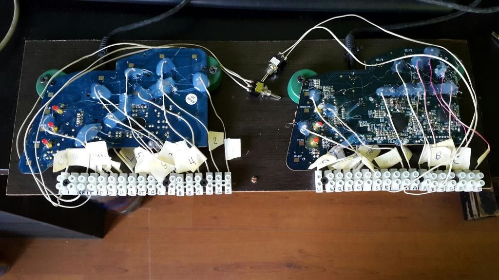

Hello to everyone!.
First I want to give my thanks and congratulations to all involved in  the GroovyMAME / GroovyArcade project.
I installed GroovyArcade and I had perfect sound and video in no time.
I'm using the latest beta.
However, I can't make my controls work.
My encoder is called "ROF USB Puzzle". It has a dual interface for 2 players controls.
If I do a cat or a jtest the device works, but ADVMenu or GroovyMAME doesn't see it.
I enabled joystick in its config files with no luck.
I've also deleted all files related to wiimote in an attempt to disable it permanently.
My XORG log says xinput is configuring both joysticks as a mouse.
I tried adding a 50-joystick.conf in the etc/x11/xorg.conf.d/ as stated in the archlinux wiki, but it has no effect, xinput keeps configuring it as a mouse.
Forgive my ignorance, but I'm a linux novice, lots of concepts are new to me.
Do I need to install some new package like AntiMicro or xboxdrv?.
I tried compiling them with no luck.
In fact I never managed to compile a simple thing, I allways get lots of errors while compiling and I surrender.
I really need your help to finish this project, I have all the hardware part finished, all of my games and chds works perfectly, but I can't make the controls work.
Thanks in advance and congratulations for your great work!.
Regards.
Whipon.

ves
  • Posts: 225
  • Last login:April 11, 2020, 02:57:49 am
Re: I need help to make my USB joystick encoder work
« Reply #4 on: May 19, 2014, 09:12:58 am »
Hello whipon
This problem is known when used wiimotes and joystick simultaneously, you must disable wiimotes.
systemctl stop wiimote
systemctl status wiimote
systemctl disable wiimote
You have to configure mame and advmenu, to recognize the joystick correctly.
To disable joystick as mouse, delete file.
/etc/X11/xorg.conf.d/50-joystick.conf

Thank you very much Ves!.
It worked perfectly in MAME!.
Just had to reinstall GroovyArcade and following your directions I got it working!.
However in Advmenuplus I had to map all the options to the buttons, since the directional pads doesn't get recognized.
1joy_up, 1joy_down or 2joy_up, 2joy_down doesn't do anything. So I had to map up and down to 1joy_1 and 1joy_4 (buttons 1 and 4) to be able to navigate the menu.

All the events I assigned to joysticks doesn't work.
As a workaround I used buttons for that events...for example:
Code: [Select]
event_assign up up or 1joy_1
Thanks in advance for your help.
Regards.
Whipon.

Hello, how are you?.
I don't have any input lag with this USB encoder.
Sadly I can't get an IPAC, because the Argentina government changed the import regulations.
So its extremely difficult for me to get any item from USA or any other country. Yes I know my government sucks  :angry:.
On the other hand this USB encoder is avalaible in my country, and works perfectly. Only point down is I coulnd't make the joystick to work in the Advmenuplus frontend, so I'm using the buttons to navigate it.
This encoder uses Axys 4 for X and Axys 5 for Y. I suspect that is the reason Advmenuplus doesn't see my sticks. For example, some time ago, I had to recompile the Dosbox emulator with a fully bindable patch, to be able to map my sticks with that emulator. By default Dosbox only uses Axys 1 and 2.
My GroovyArcade MAME cab is fully working, only thing missing is to be able to navigate the frontend with the joystick up and down...instead of mapping those events to button 1 and button 2.
All 20 buttons of my USB encoder work perfectly fine in the frontend.
Thanks a lot for your comment.
Regards.
Whipon

I gave up >_<!!!
« Reply #11 on: November 05, 2014, 12:06:02 am »
Well, I did some tests with some old usb arcade sticks I had lying around, and they worked perfectly both in AdvMenuPlus and all my emulators.
So I decided to hack them:
I notice a better response in the controls now, plus now I can take advantage of the turbo fire feature of these boards. Now I can enable or disable autofire in the buttons individually.
Thanks for all the replies.
Regards n_n.
« Last Edit: November 05, 2014, 10:01:59 am by Whipon »

Very neat solution, thanks for sharing this.
Thanks, Calamity, glad you like it  ;).
