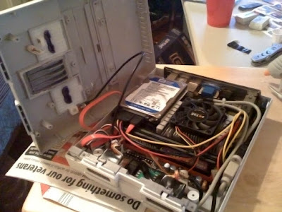

Gutted snes case. Purchased broken off ebay. I think I got like 5 of these for 20 bucks.

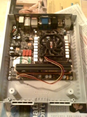

Zotac Mother board fit perfectly inside with room to spare.
First Assembly.

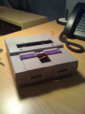

Fresh coat of paint.
Snes usb adaptor rigged to the controller ports.
Final assembly, with momentary switch rigged to the snes power button. And a purple LED for the power light.

It all works pretty well. I set it up to use the snes controllers  and they work great for all the emu's I have on here.   I'd like a faster setup but I'll save that for when I build a full-size cab.
