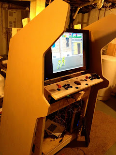

I took a quick break from working on the control panel and focused my attention on cutting down the sides to the arcade cabinet.
I had purchased some MDO a few weeks prior and I had been itching to get those cut down.  Without any size measurements from an actual Dig Dug arcade cabinet I decided to go with some measurements from a Centipede cabinet (available at http://arcadecontrols.com/arcade_cabinet_plans.shtml) and modify it a bit.  Centipede looked close enough to a Dig Dug cabinet so I essentially I just winged it and hoped for the best.

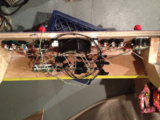

With the sides cut down I could again return my focus to the broken control panel.  A lot of internet research later and a few more hours working on the control panel and I finally had something that worked.  Not only could you play games but with the sides leaned against the frame it was starting to actually look like an arcade cabinet.
After the test run at Drunkin' Bike Rides we had a system that worked and could stand up to drunk people abusing it for hours on end.  Now I could get to work on building something that looks even more like an arcade cabinet.  I took the leftover MDO from the side panels and started to cut down the rest of the pieces needed for the cabinet.

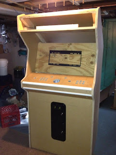

This is where construction took a major slowdown.  I talking to my wife and we both thought it would be cool if this thing took actual quarters.  After all if you are going to build a full sized arcade cabinet it might as well look legit.  Unfortunately a coin door was not in my original budget so I had to hold off on construction for a bit before I could afford the coin door.
Flash forward about a month or two and now we have something that looks like an arcade cabinet.  I ended up not using the original 32" monitor and instead opted for a 27" monitor.  This put construction on hold for a second time while I set aside extra cash for a monitor that wasn't in the original budget.

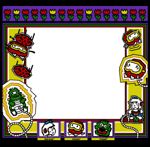

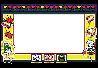

Over at the Arcade Art Library I was able to find Illustrator files for the Dig Dug marquee and brezel.  With these in hand I was able to recreate both a wider marquee and brezel which would fit my cabinet.
Original Dig Dug Brezel
Widescreen Dig Dug Brezel I Created
Original Dig Dug Marquee
Wider Dig Dug Marquee
As you can see the artwork is not only wider but it still looks like the original Dig Dug artwork.

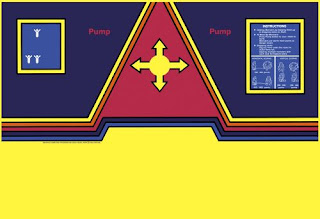

The Arcade Art Library also had the control panel overlay and the side art but I decided to go a different direction with those.  For the side art I figured I would just order the Dig Dug version available at gameongrafix.com.  (http://www.gameongrafix.com/products/dig-dug-sideart)  They already had the side art ready to order so why waste time recreating it?
The control panel was a different story completely.  Since my cabinet was not only wider but had more buttons I would have to redesign the entire overlay while keeping as close to the original design aesthetic as I could.
Original Dig Dug Control Panel Overlay
New Dig Dug Control Panel Overlay
In the end I thought I came pretty close to the original design even if I did have to lose some of the original artwork in the process.

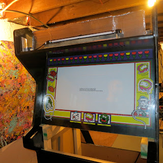

With my graphics finalized and the extra money saved up for the new monitor I put in my order to gameongrafix.com for the artwork and to newegg for the monitor.  While I waited I primed and painter all the parts.
Once the last of the parts arrived I put everything together and this is what I ended up with.
Not bad for a complete woodworking novice.  While it looked finished I still had some work to do.  I did spend some time doing a few other odds and ends to make it seem more like an arcade cabinet.  One of the major drawbacks of having a PC inside an arcade cabinet is that when you boot into Windows you get the default windows branded boot screen.  So I changed the Windows 7 boot screen from this...
...to this.
I also changed the default wallpaper to something a bit more arcade-y.
The computer now boots directly into Hyperspin so unless you know what you are looking for you only see the Dig Dug loading screen and then the wallpaper for a few seconds before the Hyperspin front end takes over.
