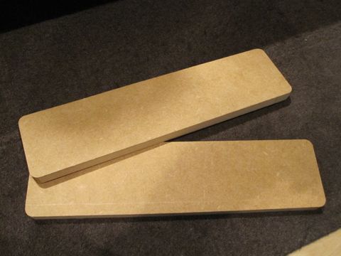

Now comes the fiddly part, making the doors for the cabinet apertures.....
I didn't want to use pin hinges so I had to figure out another method. I had an idea to use some Ikea shelf support pins and use these as a 'swivel hinge' ... that's my term, there's probably a real one.
I'm testing this out at the moment with a mock-up so here's the design.
The door/flap will be made of 12mm MDF. The side pieces 18mm. This will allow the flap to rotate relative to the side piece whilst providing clearance. Hopefully the pictures will make more sense ....
Ikea pins:
Hole drilled into the side of the flap:
Pin inserted into the hole:
Hinge in place (depth of hole in the side piece is slightly shallower to allow the flap to clear the side piece when opening/ closing):
This will need to be done accurately to ensure a decent fit.
The door/flap will have magnetic strip at the top to attract to another strip on the cabinet to ensure that it remains shut. The door/flap will have a cutout with embedded wire mesh. I'll post more pics as I go ....
This build doesn't seem to be proving that interesting to people  :dunno  Hopefully when I start to build the the control panels it will  :)
« Last Edit: December 08, 2012, 06:59:31 am by SpaceHedgehog »

The lower door/flap and the side pieces have been cut. A window will need to be cut into the door/flap to insert some mesh.
The side pieces are stuck to a piece of scrap with double sided tape to check it works and that everything is flush. It looks ok.
Making sure it opens!
Side pieces beveled:
Fit looks ok:
This side pieces will be screwed onto the left and right sides of the lower aperture.

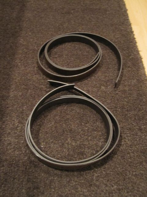

Complete the finish and fitted them to the front of the cab. The mesh is held in with hot glue. I need to tidy up the inside of the lower door a little. The photos are a bit rubbish unfortunately.
The next job will be to fit the magnetic strip I ordered to the top of the door and the cab.

Magnetic strip will be used on the lower door to keep it shut.

Started on the marquee today rather than the TV mount - I'll wait to buy the display beforehand to ensure I have it at exactly the correct height.
I wanted something similar to the Golden Tee machine but a bit sleeker (less height) and chunkier at the back - I'm going to be paying particular attention to the profile of the machine due to the place it will be located (visible sideways through an open door). I've cut out the basic pieces. The front piece will be given a similar treatment to the doors.
The width is 40cm and the height 10cm.
The Golden Tee has something a little too big I think.
I think the marquee will give a better balance to the cabinet and make it feel much more like a real machine.

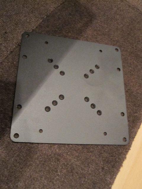

Basic mount has been made but still needs to be adjusted. Cables need to be fed through the white tube ....
