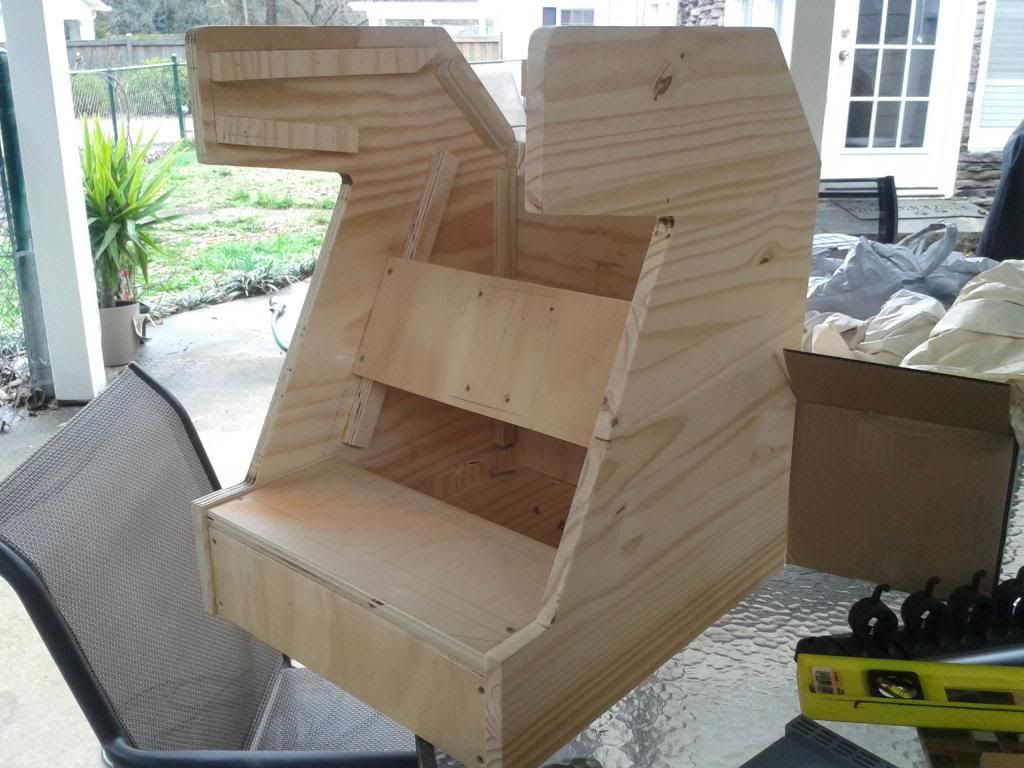

The Idea

Current guts
Gutted Goldeneye Cabinet: $40
Playfield: 40" Sceptre 1080p monitor/tv: $299.  The picture and viewing angle are fantastic on this, but I'm not happy with the refresh rate.  I will have to put the screen back together at some point to use the TV somewhere else and upgrade.
Backglass: 27" AOC 1080p monitor $219
ASRock G31M-S R2.0 Micro ATX MB: $43
Intel Celeron E3400 Wolfdale 2.6GHz Dual-Core Processor: $47
2GB RAM: $20
64GB SSD Hard Drive: $80 (Windows boots in 10 seconds and I haven't even tried to optimize it yet.  I can't wait to see how Hyperpin reacts.)
4TB SATA RAID: $238 I need the space!  When the machine isn't being used for pinball, it backs up all the other computers on my network and is used as a media server for streaming music and movies to all the TV's/computers/iPhones/iPads in the house.
On-Board video:  Currently too slow to play Visual or Future Pinball.  I'm hoping I can use it for the DMD later.
NVidia GTX 460 1GB: $139.  I compared it with the GTX 550 $5 less.  The 460 is 20-40% faster and and runs 10C cooler!  Tried ATI and had major graphic issues with VP.
Sound system:  Harman Kardon Soundsticks III: $112[/color]
12 various buttons: $16
KeyWiz40-ST: $36
Stern/Sega/Data East Black Front Molding Lockdown Bar: $55
4x MOLEX 15-pin Connector Kit 0.093: $18
12V Power Supply: $8
24v Power Supply: $20
Guts to Get
LED DMD + Controller
Nudge detection: undecided.  Anyone?
Plunger: undecided.  Any suggestions?  I may try to go with a trigger like the one that comes with a normal Golden Eye machine, but I'm not worried about it because I will be painting the case at some point anyway.  I was thinking about getting Nanotech's Mot-ion set up, but I have only heard bad things about the plunger.
2x 12V-DC industry relay for flipper force-feedback
Am I missing anything?   Anyone else have any cool ideas I can stea... err borrow?
The software set up has been really annoying so far and I'm only tinkering with one screen at the moment.  It's such a pain to download a Hyperspin media pack, a Hyperspin video, a game table file, and all the ROMs separately for each game.  Future Pinball has been crashing on me and just getting Visual Pinball running seems overly complicated.
Edit: VP is getting closer, just need to sort out the back glass now.  Future Pinball no longer crashes on me.  Running everything on pretty low settings.  I can barely notice the difference in the rendering, but I can see a wobble in the ball at anything less than 60fps.  My friends didn't notice it, but I didn't point it out to them.
I would really appreciate any help/suggestions for the items listed in blue.

I routed out the sides of the cabinet and dropped the monitor in.  Here is a pic of it under the glass.
I think it's going to look a ton better with a bezel and some artwork up at the top.
The second screen is just temporary.  I'm not sure if I am going to use that monitor for the DMD or just buy an actual DMD.  If I buy a DMD, I don't need to buy another video card.
More importantly, how do I move those annoying arcade mode future pinball graphics in the blues boxes!?  I would like to move the score and graphic to the second screen and remove the Future Pinball logo at the bottom altogether.  Do I need to edit the actual table?  I didn't see those items on it.
Ya you have to go in and move the fields to another area out of the way and resize the playfield. VP is great but a big pain in the @ss to set up right. The cab looks awesome so far btw, definitely thinking of building one again if i can get a cheepy 40" deal like that

Ya you have to go in and move the fields to another area out of the way and resize the playfield. VP is great but a big pain in the @ss to set up right. The cab looks awesome so far btw, definitely thinking of building one if i can get a cheepy 40" deal like that
It's a Future Pinball table.  Are you saying I need to edit the actual FP table?  I thought that might be the case.

If I remember correctly at least one of the Future Pinball logos is part of the FP program and is not built into the graphics for the table.  I do not think you can remove the FP logo because of this.  If you look at the graphics of the table you probably will not see a FP logo.  I checked a polygame table and Pollygame logo was there but not FP.  If you run FP you get the logo.

Okay, this is going to sound really stupid, but here goes.
I was told that I should get two power supplies to power my force feedback parts, a 12v and a 24v.  I was directed to the power supplies in the image below.  I didn't do much research as they were cheap ($28 for both) and I know others were already happy with them.  Now, here is the stupid part, I expected these to come with cords.  Am I supposed to just cut a cord off of an old lamp or is there a safe way that I should be setting these up?  I remember the basics from my high school electronics class, but the highlight of my electrical career was wiring the buttons and LED's in my MAME cabinet, so feel free to talk to me like I am a child.  Thanks!
TopJimmyCooks
  • Posts: 2097
  • Last login:March 01, 2026, 03:28:53 pm
Re: Rooter's Pinball
« Reply #35 on: May 10, 2012, 09:08:10 am »
from the pic it should be black 110V wire to the hot or Line terminal (L in the pic)  white to the Neutral (N) and ground wire, either bare or green insulated to the ground (upside down christmas tree next to N) in the pic.
you can buy a 3 conductor cord with pigtails at the hardware store, or just get an extension cord and cut off/strip the female end to make a power cord for your supplies.
This all assumes you're in the USA.  If not, disregard.
I am in the USA and that is what I was going to do.  I just thought there was some sort of cleaner or safer way.  Thanks

How about wire them in parallel and chop the IEC (C14) socket from an old PS.  It looks more pro, IMO.  I did that with my cab...
(sorry about the crappy pic...there's a drop light lit inside the cab in the pic..)
If there's a next-time, I want to do something like this:
http://www.amazon.com/IEC320-Inlet-Module-Switch-Socket/dp/B0050HH70E/ref=sr_1_10?ie=UTF8&qid=1336663277&sr=8-10
AJ
Here's your huckleberry:
http://www.homedepot.com/h_d1/N-25ecodZ5yc1v/R-100661452/h_d2/ProductDisplay?catalogId=10053&langId=-1&keyword=cord&storeId=10051
AJ
$14 per cord seems a little crazy.  I have a ton of these $2 cords lying around and I can just chop the end off.
« Last Edit: May 10, 2012, 11:22:51 am by mcseforsale »
