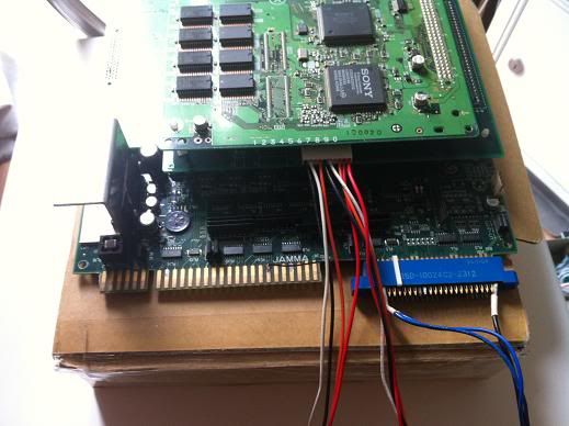

I thought I would continue this thread rather than making a new one.
I got my Namco guns and Point Blank 2 PCB and the guns work great  :)
I also picked up a Zero Point 2 PCB which is a similar game to PB and I'm going to add some AMP UP connectors so that I can use the guns with Zero Point 2 too.
Here are a few photos of the Namco Guns and System 11 PCB

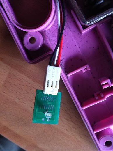

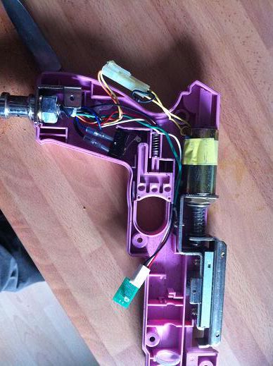

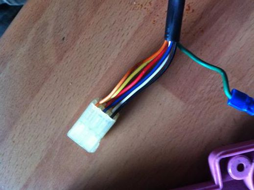

There are 6 wires going into the Namco guns as well as a green earth wire and I believe this pinout to be correct after taking the guns apart:
Black : GND
Red: 5v for sensor (metered)
White: Gun Opto
Blue: Trigger
Yellow: 24v for solenoid from separate PSU
Orange: 24v 'GND'
You can see the diode across the solenoid that arcadeswede mentioned
The yellow 24v is connected directly to the solenoid of the gun. I believe it is the orange 'GND' wire that governs when the solenoid is activated, this wire terminates at the 8 pin header you can see in the first picture of the System 11 PCB. You only get recoil in game when you are firing shots, you don't get any recoil when not coined up or when you have run out of bullets in a mini game etc.
I have found the gun header pinout for the Zero Point 2 PCB to be as follows:
   1| Gun OPTO - White Wire
   2| +5 Volts - Red Wire
   3| Trigger  - Green Wire
   4| Ground   - Black Wire
Obviously they will be easy to wire up to the Namco guns. What is troubling me is how to get the solenoids hooked up.
I found a video of the 1st Zero Point PCB and it looks like the guns do have recoil. I would imagine the Zero Point 2 to have feed back too as the PCBs are near identical from what I can see.
[This] is the full Zero Point 2 pinout. I can't see anything to do with the solenoids on that.
I'm not sure how the solenoids work in regards to this game but I'm thinking of wiring some relays up so that the solenoid fires whenever the trigger is pulled. I have measure the voltage at the trigger and as expected there is 5v. I was wondering if its possible to run a/some relays of this to power the solenoids every time the trigger is pulled.
I would need a SPST relay per gun or a DPST relay for the pair (or use SPDT/DPDT and just use one pole) that can be triggered from 5v, that can relay 24v and can handle 5A+
I've had a look but I can't seem to find anything suitable. Has anyone got a suggestion for relays or for another possible solution?

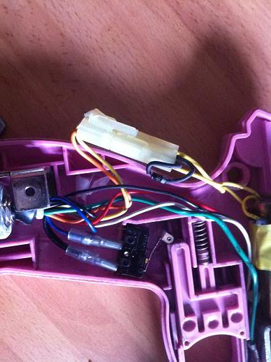

I told earlier that my pink namco gun didn't work so I found a "melt fuse", hidden under the tape on the solenoid.
If the solenoid gets too hot, the fuse will disconnect the circuit to save the solenoid from burning up if something goes wrong.
Here's a picture of the "melt fuse":
The specs on the fuse is:
121
UMI
2A 250V
102 °C F4
I replaced mine and the solenoid now works like a charm.
Maybe this will help someone with a non-working namco gun.
