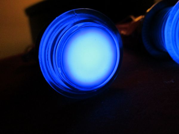

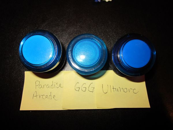

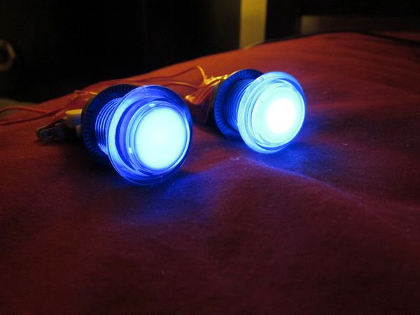

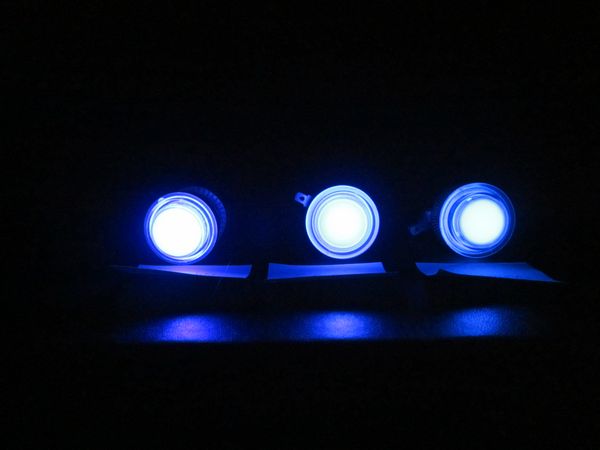

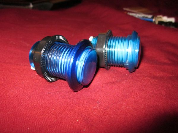

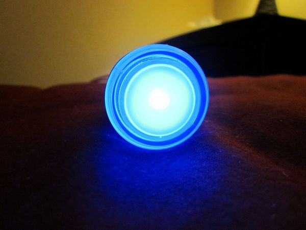

Thought I might as well make myself useful since it's a boring day at work today...

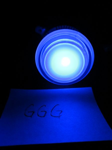

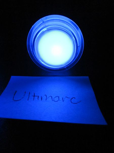

I happen to have a blue SpectraLite and a blue Ultralux button here.   So my disclaimer is that I only have the color blue available to me.  I have not tested other colors.   But I believe that despite having only compared this one color, I can give some honest feedback regarding these two products.
Ok, first thing of note.  The Ultralux button does not come stock with a LED.   However Ultimarc does offer some quality 5v LED's for an additional 90 cents each.   The SpectraLite DOES come with a stock LED.  This LED is a 12v LED.  I believe Randy from GGG said once that he did intend to offer different lighting options for the Spectralite button at some point, however, based on his site, it does not appear he has any yet.  You are of course able to use whatever LEDs you want, and are not limited to these two options.  But just know that the SpectraLite comes with a stock 12V LED and the Ultralux comes with nothing, but you can purchase a 5v one through them for 90 cents.
In the picture below you will see the Ultimarc 5v single LED on the LEFT.  On the 12v Spectralite LED on the RIGHT
Next, the button itself.   In the picture below, you will see the Ultralux button on the LEFT and the SpectraLite on the RIGHT.   You can see that they are slightly different in color.  The Ultralux has a brighter more pleasing color to it.  It just pops a little more.  The SpectraLite appears to be a little bit "murky" if you will.  It's not truly displeasing to the eye on its own, but when placed next to the Ultralux one, you can certainly tell the difference.
Here is just another sideview of the two buttons where you can see the color difference a bit as well.
Now, I thought it only fair when testing the two buttons to use the same LED in each of them, so that the side by side photos would be equal.   So in the pictures below I am using the Ultralux 5v LED in BOTH buttons.   You can see that there is some color difference here as well.  The SpectraLite button, on the right, appears to be brighter.   The Ultralux button, on the left, is still bright, and the quality of the plastic looks a little more clear.  Which makes the button look a little cleaner and more crisp.
The next thing you will notice, which is visible in this next picture, is how the light from the LED is diffused through the two buttons.  The Ultralux on the left has the light dispersed really evenly, giving it that same clean, crisp look.  The Spectralite, on the right has a pretty apparent circle of light showing in the middle.   This is not the camera playing tricks on us, it looks that way to the naked eye as well.
Here is a closer look at the Spectralite button, lit up, on its own.
Here is a closer look at the Ultralux button, lit up, on its own.
Both buttons do have a diffuser disc in the top of the button.   It just seems that one of them does a better job spreading the light out than the other.
I thought it was only fair to at least show one shot of the SpectraLite button lit up with it's stock 12v LED, so here it is.   It seems to have a much more direct one light dot in the middle.  This, I believe, just comes from the style of light bulb it is.  It's a smaller LED, whereas the one from Ultimarc has a much wider bulb on it.  The provided 12v LED appears to have some level of success getting rid of the distinct circle of light, however it replaces it with that more direct light in the very center.
I will not comment on the switches provided with the two buttons, as I am no expert on that sort of thing. They both feel fine to me. I believe both sites probably offer different options available for switches anyway.
So, in my assessment, I would have to conclude that the Ultralux button is the superior product.  The plastic appears more clear.  It diffuses the light more equally through out.   And it just looks more pleasing.
Now that said, the Spectralite button seems to still be a fine product.   It's really just when compared side by side with the Ultralux that it pails in comparison.   When on its own, it does do a pretty decent job, especially at it's current price.
I guess what it comes down to, is that, you get what you pay for.  The Ultralux is $3.95 + $0.90 for the LED.  So $4.85.   The SpectraLite is $2.15 with an LED included.   So at over twice the price, the Ultralux is a better product, and you are paying for it.
Thus concludes my button comparison.   ;D  Back to work!
Let me know if you have any further questions.
Edit:   typos, other small corrections.

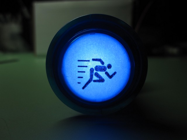

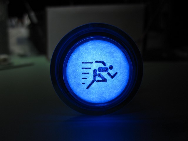

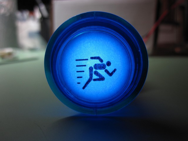

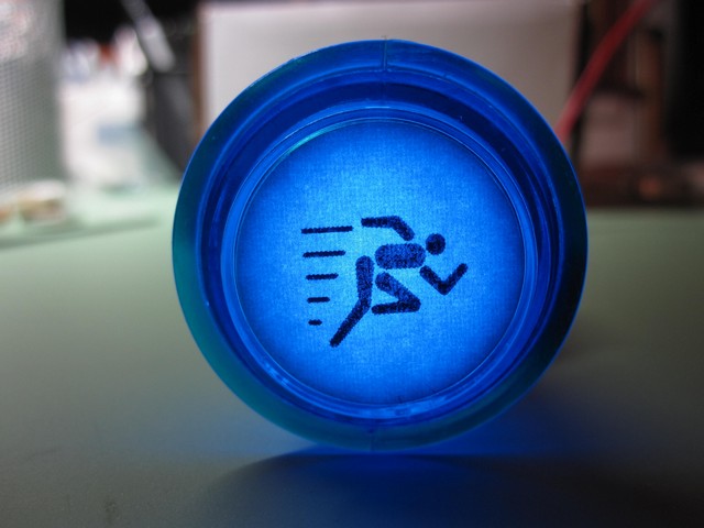

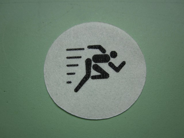

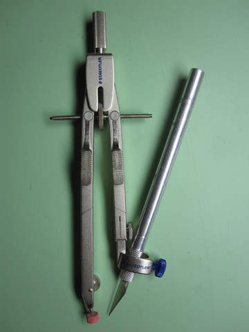

Ok, here is a technique for creating custom PGIs that I experimented with tonight.
I put an exacto blade in a compass like so:
The eraser bit keeps the compass needle from making a hole in the paper.  This contraption worked for me because I had an attachment for my compass that accepted pens and which could hold the exacto knife.
When I used it to cut out a circle, I got this:
Now, it took quite a bit of practice to get a nice circle like this, but like you said, you can print a whole sheet and just keep trying until you get some good ones.
I tried two types of paper: drafting paper (which is translucent) and normal printer paper.  In both cases, the logo was printed on a standard LaserJet printer.
I also lit the button using my cutout with the supplied diffuser disc as well as just my cutout (no disc).  Here are the results:
Normal printer paper with diffusion disc:
Drafting paper with diffusion disc:
The drafting paper looks nicer because you can see too much of the paper’s texture with the normal printer paper.
Normal printer paper without diffusion disc:
Drafting paper without diffusion disc:
The surrounding area in the pictures without the diffusion disc are darker because the button illumination is brighter and the camera had to adjust for that.
I'm still experimenting with this, but it seems like this idea might work!
There are a number of items which need commenting upon in this feedback, as some of the conclusions are not entirely accurate.  So I'll do my best.
It's not well known, but these LED's also work very nicely at 5v, albeit not as intensely (website updated to reflect this).  Based on some of the commentary here, this may be just what you are after.  Also, running it at only 5v will likely give it an incredible lifespan.
...snip...
You probably shouldn't try to use the same LED in both buttons.  That probably makes it more unfair than fair.  If you look at the overall length of the buttons, you'll see that the Spectralite is shorter.  If you install the lighting into the body of the button, you'll also notice that the LED in the Spectralite button sits much higher.  Light works on the inverse square law, which states that a light half the distance away is 4 times brighter.  You can see that this is roughly the situation here.  Again, if you don't like the extra brightness, 5v would be the way to go.  Keep in mind two other things as well; 1) slight "murkiness" aids in diffusion of the light and can be a desirable trait.  This is probably partially responsible for the more even lighting across the bezel on the Spectralite.  And, 2) brighter lighting is beneficial when used with inserts, especially when the material used is something like normal paper.
Again, the distance is different, so the comparison is not valid.  If the distance between the LED on the Spectralite is half that of the other button (I believe it is actually less than half in this case) then 4 times the amount of light is striking the diffuser on the Spectralite button. As one can imagine, this would have an effect.
This is a camera artifact.  The buttons do not look this way in use.  The camera CCD becomes saturated, thanks to improper exposure settings, and goes to max at a certain level of light output.  This is why the spot appears white, instead of blue, which would be impossible for a blue LED to do.
This is, however, an important consideration, unless one is purchasing "lights" with the button functionality being of secondary importance.  Most won't approach the situation in that manner.  Both styles of buttons are considerably stiffer than the normal concave arcade buttons, so switches are important.  The Spectralites come standard with our "Soft Touch" switches, which improves the feel of them considerably.  If one needs to purchase these separately, to get the same feel on other buttons, that cost also needs to be taken into account.
I'd also like to address the "no printed inserts" situation as it applies to the Spectralites.  I planned to do this, but these buttons really work well for the DIY'er in that regard, especially with the amount of light they are capable of applying to the insert.  I can't possibly keep a library of all of the different designs folks will likely want, and they are so simple (with these buttons) for the user to customize themselves.  Blind_dado has the right idea, but cutting them out is even simpler than using a compass.  Here's how to do it.....
Using your favorite drawing program, make a fine outline of a circle about .850" in diameter.
Put your artwork in the center of the circle, being mindful to leave a some space from the edges.
Print your design on whatever paper you want, so long as you can hold it up to a light and see a desired amount pass through, and it goes through your printer without a problem.  The more dense the print, the better.
After your design is printed, take the diffuser disc from one of the buttons and put it face down on your printed design.  It should be very easy to center it by eye, as the template circle is larger.
Then, while applying pressure to the disc, carefully cut around the diffuser disc with a hobby knife or razor blade.  This should give you a perfectly centered design on a disc that is both cleanly round and just the right size for the button.
Insert into the button, snap on the plastic cap and admire your creativity ;).

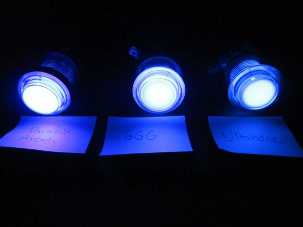

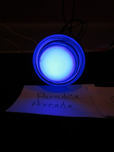

Can anyone offer opinions/comparisons with the Paradise Arcade LED pushbuttons?

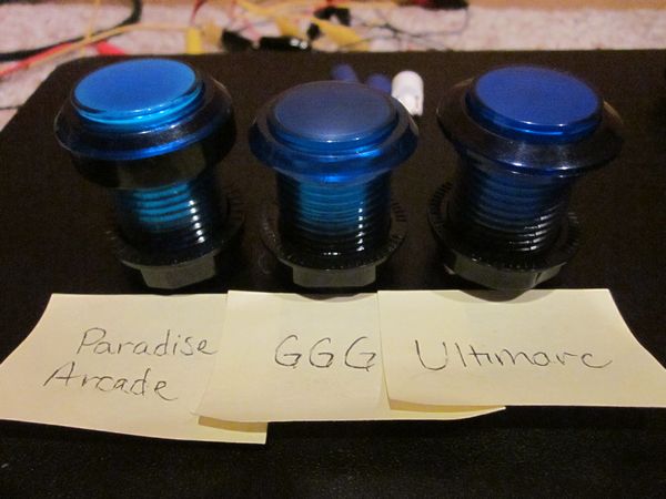

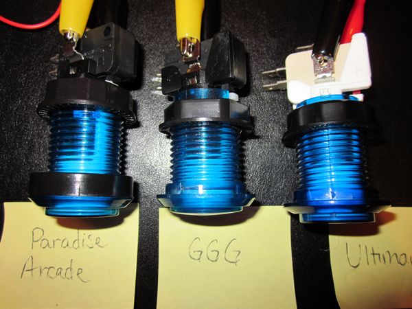

I have them, I will update my build thread tonight and you can see them lit up.  They look really good, the LEDs that come with them are plenty bright.  Yes to dim them you need need a Pac64 or LEDWIZ.  I have them with the 20 microgram or whatever switch in them.  There is no spotting from the light, it diffuses pretty evenly.  To be honest though, I don't think the diffusion is THAT big of a deal.  The main reason I got LEDs is so that I can pull up CP wizard before the game and have the controls used for that game light up.  Most of the time you aren't going to be looking at the buttons.  So like on Bryan's video, how the hot spot grows when the button is pressed down, nobody would notice this, your fingers are on the buttons and when you are playing, you are looking at the screen, not the buttons.
I would recommend the Paradisearcade buttons, but I don't think there is anything wrong with the spectralite's and the ultralux buttons.  I am sure there are differences between them, but there is also differences in price, and the differences probably aren't noticeable enough to the average consumer/user.

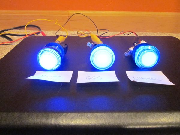

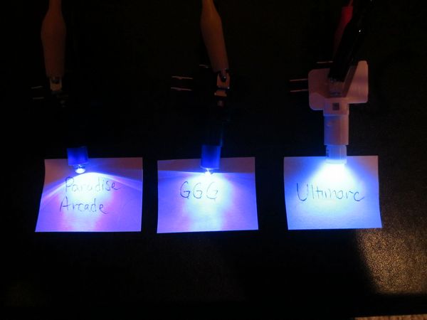

A few quick comments...
1) For inserts the biggest pain is cutting them out, which is why we charge a bit more for insert buttons, but we do have over 100 different inserts on the website.  However, doing these yourself is not a bad idea and works quite well if you take the time to cut them out carefully.
http://www.paradisearcadeshop.com/en/27-led-buttons?p=2
2) You need to be really careful when comparing LED buttons based on website images.  Ultralux is a product exclusive to Ultimarc and there for under their tight control.  Everyone else is subject to their supply chain.  We order these by the 1000's and our supplier knows that if they do not match our specifications exactly, they will be paying to ship 1000's back.  We shared this in this video here:
3) We also have an RGB solution for these that works quite well.  The biggest benefit is that we sell these pads separately so you can retrofit old builds and update them to RGB pads.
http://www.paradisearcadeshop.com/en/arcade-pinball-leds/92-tropical-mood-light-rgb-5vdc-led.html
4) Every button we tested was a 12V LED had about 20 mA of current at 12V.  Our buttons will light up at 2.5V, and are about 5 mA with decent lighting at 5V.  I can say with confidence that I think this will be almost identical for every seller in the US, I have not done this testing with Ultimarc's buttons.  Also please note that it's not the voltage that determines the brightness of the LED, it's typically correlated to the amperage, which is usually controlled by resistance.  5V 20mA lights just have lower resistors, than 12V 20mA lights.  Any one of these buttons can be converted if you want to swap out the resistors, it's actually quite easy.  Of note, our super brights are 30-40mA.
4) It is true that light follows the inverse square law, however, this is applicable over a specified area.  Since you are trying to light the entire button top, it is critical to match the distance with even distribution over the diffuser.  Markronz shows this difference with the Ultralux and our video posted by blind_dado, shows this with our buttons.  By placing the led closer to the button top you don't really get a more light reaching the top, you just focus the light on one part of the top, as shown by Markronz's pictures.

The above image Mark did so well, shows the advantages of the more diffusive ("murky") material when being illuminated.  It's about the look one is trying to achieve.  To paint one as better or worse is pointless, as it becomes a matter of personal preference and expectations.  Both look great...just different.
Donkbaca
  • Posts: 2648
    • Slim built MAME/Xbox cab
Re: SpectraLite vs. Ultralux
« Reply #32 on: July 15, 2011, 12:09:28 pm »
Exactly!  :applaud:  Which is why asking for opinions on this forum is total ---That which is odiferous and causeth plants to grow---.  A lot of people give opinions on products they have never personally used, or have some sort of elitist notion regarding some controls (see Happ vs Il, the constant bashing of x-arcade parts, etc.)  As I usually say, its all personal preference and a lot of the differences are going to be subtle one's that your average person would never pick up on.  On my cab I have cheap parts.  I have the paradise arcade light up fight stick, which is a like 9 buck taiwanese seimitsu wanabe stick.  But it lights up, it looks cool and it plays pretty well.  I have been playing MK9 on cab using this stick and I find it responsive and is just fun as hell.  Now would a $25 Sanwa JLF make a difference?  Maybe, but probably not.  Will it be a big enough difference for me to spend twice as much money?  No, I would probably have just as much fun as I am having now.  I am not saying there aren't differences between different joys, buttons and switches; there definitely ARE, what I am saying is that in a lot of cases, these differences are not super-huge to  where you can say x is crap and y is gold.  Even in the cases where the differences ARE noticeable, I would say that some people will prefer one, some will prefer the other.  Some LIKE the murkiness -that is sort of the whole point of the electric ice line that Randy carries, its all a murky color and that button sells like gangbusters.  Others, don't like the murkiness.  Some like concave buttons, some like convex, some like bat tops, some like ball.  Its all preference.  Also, people get USED to what they have.  You play concave buttons enough, you get used to them, you like them, you deal with them.  You hate bat tops, you get a ball top because they light up, you come to like the ball tops.

First the LEDs.  Here is a screenshot of the three LED's side by side.  Although the PA and GGG bulbs appear to have the same bulb holder, the bulbs themselves do differ.   You'll see more on that later when I have them lit up.

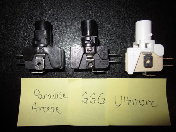

Here are the switch holders.  The PA switch holder is definitely made using harder plastic than the others.   Whether thats a legitimate plus or not, I'm not sure.   I've never broken a switch holder from any of the three vendors, so the fact that PA's holder is harder, doesn't particularly do anything for me.  One thing I noticed is that it's harder to take out the switch by hand with the PA one.  Because it's a harder plastic, I couldn't bend it very easily to get the switch out.  With the other two, I could get the switch out without any problem.  This is easily remedied by just using a small screwdriver to aid in getting the switch out.   Besides, how often to you replace your switches once they're in there anyway?

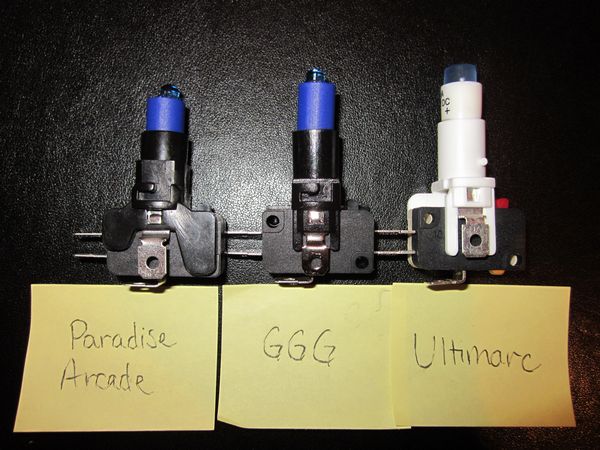

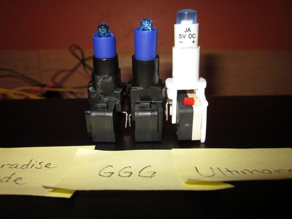

Here's a shot of switch holders and LED assemblies side by side.
Another angle of the switch/LED assembly.
Now to explain what I meant earlier when I said that the LED holder appears the same, but that the bulb is different.  Here are all three of them lit up outside their buttons.   As you can see the PA LED is different than the GGG one.  One could argue that this has to do with the angle of the bulbs when I took the picture, but I played around with them, and that just seems to be how they work.  One appears to have a more conical light on the bottom, and the other has a more flat light on the bottom.   I won't speculate as to which is better at this point, I will let the illuminated buttons decide that for themselves.  My only point is that, while they look the same, they are not identical.

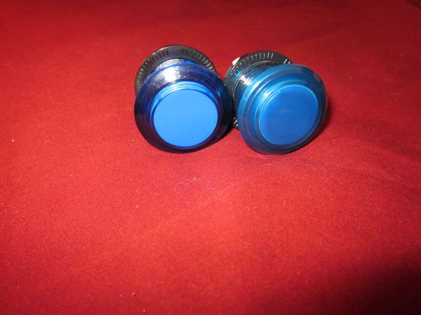

Now here are a few pictures of the buttons from various angles.
You'll notice that the PA button comes with a black washer immediately under the button.  If you watch the PA video posted earlier, they say that this helps with the lighting or something.   They also say that their competitors come with smaller black washers on their buttons.   I'm not sure what's up with this, or what vendors they are referring to, but I did not receive any sort of black washer at all with the GGG or Ultimarc buttons. But at any rate, I've used both the GGG and Ultimarc buttons before, and never had a black washer in there, and never had a problem with that.  I guess I personally don't see what advantage this offers.  I would think it would look strange if each of the buttons had a big black ring under them.   But you can decide that for yourself.   Anyway, the washer is removable, so you could always just take it off if you don't want to use it.  I guess it's nice to have it there if you feel that it makes a positive difference for you.

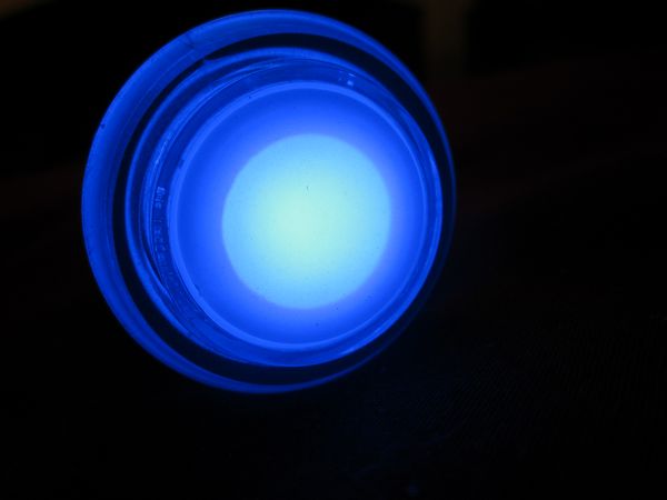

And here are some pictures of the three buttons, side by side, lit up. Again this was very hard to photograph properly.  I will make some overall comments and observations at the end, after all the pictures.
For these next few pictures, the overall brightness of the pictures is a little misleading.  So for these next three pictures, don't try to compare one to the other.  Only use these three next pictures to give you some idea as to how the light gets dispersed with that particular button, and not judge the brightness.
PA button.  Very clean light dispersion.  Very similar to the "clean, crisp" look and feel of the Ultimarc one.  Really no complaints here.
GGG button. Circular cone of light in the middle.  Does not appear to disperse as evenly.  The outter ring of the button lights up just fine however.  As was mentioned earlier, your finger will be covering the button most of the time anyway, so you can make your own decision how important the overall look of the uncovered, lit up, button is to you.
Ultimarc button. Very clean, crisp look.  Even light dispersion. No complaints here.
As far as brightness goes, both the PA and GGG button do appear to be brighter than the Ultimarc one.   I believe this is because of the 12v LED's instead of the stock 5v Ultimarc one.   I hooked up 5v power to each of the three bulbs to see how that worked.   That's what the picture below is of.  Note, the PA button appears to look purple in the picture, but not in real life.   But anyway, bringing down the voltages to 5v, really evened out the brightness across the three buttons.   It did not appear to do much for getting rid of the cone of light thing with the GGG button however.  All three buttons do light up to an acceptable level at 5v, if that's the only voltage wire you have available there.
Now, back to the comparison of the stock LED's at their designed voltages... I would have to say that the PA button is the brightest.  GGG is a close second brightest.  And Ultimarc is the least brightest.
As far as light dispersion, the PA and Ultimarc ones are very similar in look.  Both do an excellent job at dispersing the light evenly across the button.  The GGG one, as I've mentioned before, has that cone of light in the middle.  It lights up well, but not as evenly.
So that's the basic review of all the buttons.  Now that I've gotten to look at all three of them side by side, based on solely brightness and light dispersion, I like the Paradise Arcade buttons myself.   The Ultimarc ones are very good as well, but simply not as bright.   Also, when you compare the price point on the PA button vs the Ultimarc one, it's a no brainer for me.   The GGG and PA button's prices are comparable.  The brightness between the GGG and the PA is also pretty close to each other.   So when choosing between those two buttons, you'd have to consider how much it means to you how well the light disperses.
That's all I've got for now.   If anyone has any questions about any of these, or would like me to clarify anything, please let me know.   Hopefully there isn't too much backlash from this latest comparison of mine.  ;D
