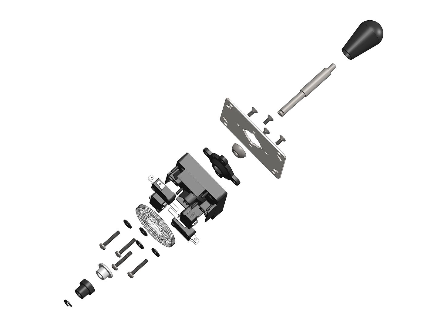

« Reply #7 on: June 03, 2011, 07:01:56 pm »
I'm not sure what you mean by "posts" so here's an exploded view of the Sanwa JLW, the only thing missing is the springs... You'll have to right-click it and open in new tab to get the full resolution.

Re: Octagonal gate for Sanwa JLW series
« Reply #8 on: June 03, 2011, 10:12:42 pm »
I am talking about a U360. Which is essentially a modified JLW. The screws holding the restrictor plate are replaced with four posts so that you can screw one end through the restrictor plate and the other end holds a PCB. You can see this about 2/3rds the way down this page http://www.ultimarc.com/ultrastik_inst.html. Also, the switches are removed since the PCB allows for digital and analog mapping.

« Reply #9 on: June 03, 2011, 10:30:50 pm »
I haven't got a U360 fro Andy to draw up in SolidWorks yet, so I don't know too much about their construction, other than they share the same base, like you said.
