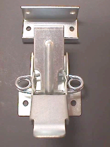

You can actually leverage quite a bit heft of a control panel into your cab using control panel latches. I can't give details on how you would install them in your case since I have no idea what style cab you are going with, but bet with four latches, they can hold your panel rock solid.
Bob Roberts sells them 2 for $8.00
