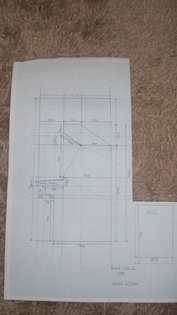

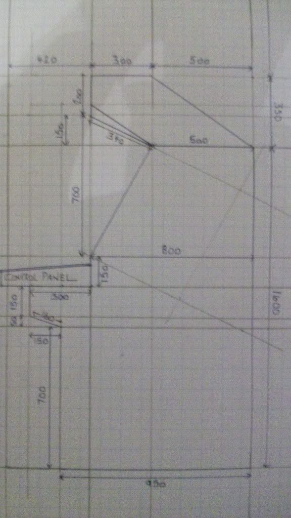

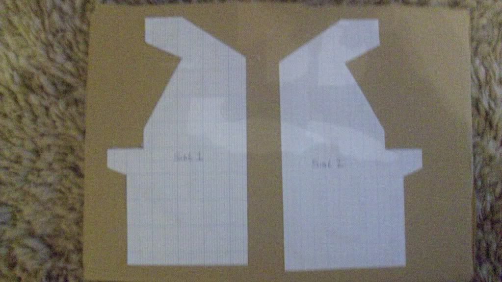

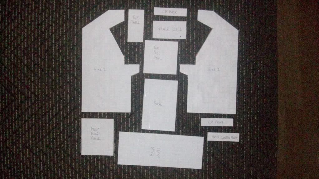

I liked the basic design used at arcadecab.com which i had planned to use with my X arcade and have had the plans sat in a draw for a couple of years but since the measurements are all in inches I have decided to use my own and use MM (millimetres).

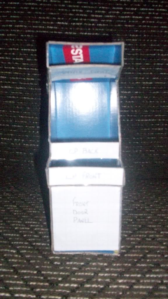

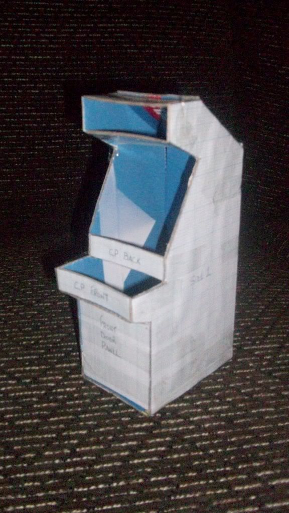

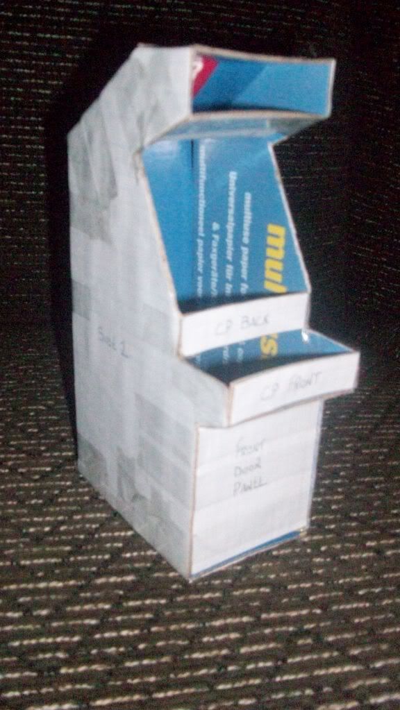

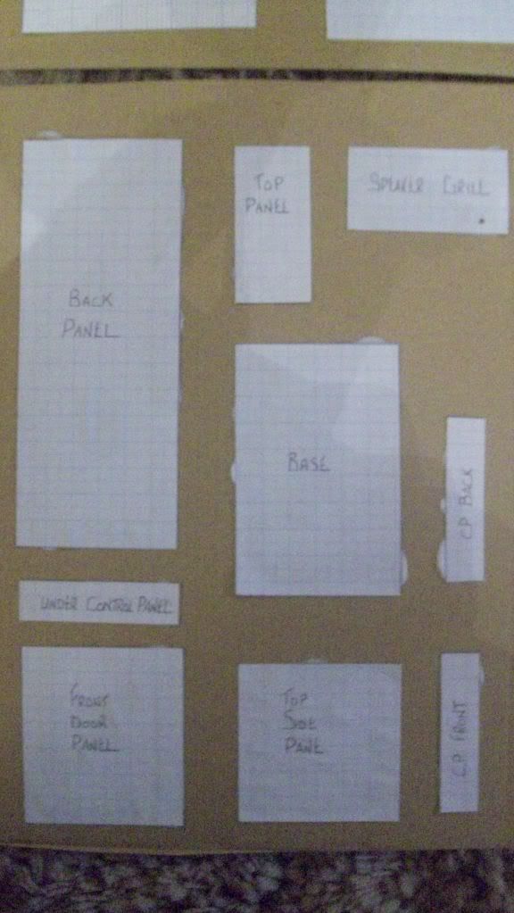

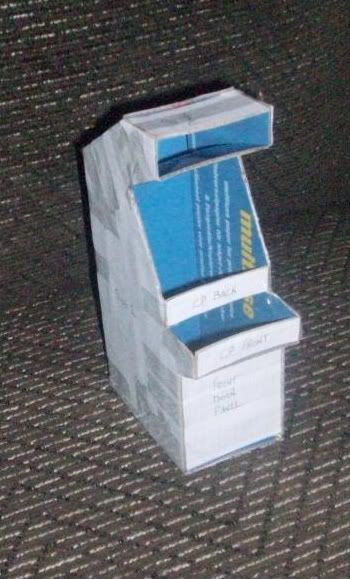

I recently bought a VGA 29" monitor from Franco  :cheers: so had a guide what my measurements need to be and have drawn a template on graph paper. I then wasnt sure how it would look so using a scale of 100:1 I copied my plans onto cardboard and made i model to see how it should look!
So hopefully after christmas a can buy some MDF and have a start!

Hi Blyths!
I'm in the planning stages, much like you, so I can't offer much in the way of insight other than to say:
Make the first ever cardboard cab!  That is so awesome, insert some hidden steel supports and have a paper based cabinet!
Ugly?  Sure.  But awesome?  Oh yeah!  :afro:

hey, welcome to the forum.  I too am in the process of building a cab. started 5 months ago..  anyhow im in the home stretch.. getting closer every time i think about it..  i too like you research plans...  and i first came across some plans that were printed on graft paper like you, 1" per square..  anyhow..  before i cut a piece of wood i built a card board model of that cab.  i think they refer to them as lucas plans?  i forget now, at any rate.  i ended up going with plans from mameroom.com cause my door ways are narrow and needed to get it in and out.  so the ultimate 2 plans are in two pieces so i can get it in and out of door ways.  if it was not for me building the cardboard model first i probably would of built something i could not get in and out of my room.. you are on the right track with the model.. and look forward to your build.  rock on man. :)
