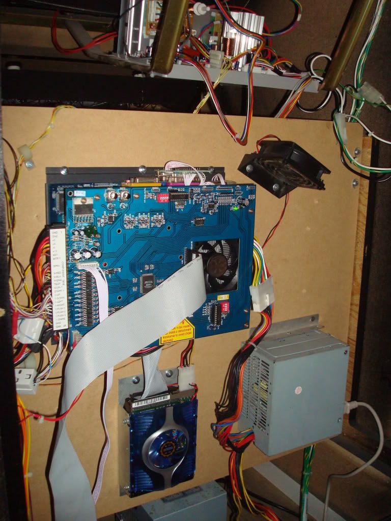

Also, I put that piece of MDF in the cabinet to mount the components like this:
Which I saw on another forum.

1. Put the mount in for the xxxx in 1 components and mounted them.
Sadly, I got a bad drive with the board so I am waiting for a replacement. But soon, I will be playing some SUNSET RIDERS and SF II.
2. I also replaced the mono speaker and shelf with a new piece of MDF that matches the original piece and stereo computer speakers I decased:
I got the 40 button/2 joystick package from Xarcade, so next will be to replace the control panel. This I will need help with. Any plans around to make a replacement to what I have? Preferable something wider? Also and ideas for console art?

New Drive came today and it works! I now have a working xxxx in 1.
One small issue, only the top 3 buttons of my control panel work...
My Jamma was wired for a CPS2 and worked fine the way it was with 6 buttons, but obviously now I can only use 3.
I know the board came with a connector for buttons 5 and 6, but that still leaves one button left. Any ideas?

OK been a while since updating. I installed a fan for the hard drive and a fan for the board to keep things cool.
Still need to get buttons 4-6 working sadly...
Sorry for the iPhone pics:
And here are some pics of the board running:
