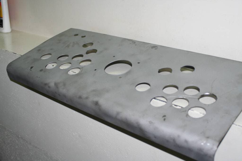

Ok, so I couldn't go take the pictures just yet (Hope I can go this saturday), but I don't want this thread to die, so here's more questions for you experienced folks....
I know that part of what I'll need to do is get the cabinet up to shape, and that involves fixing/filling the broken corners as shown in the pic, and that's done with the filler and such as you've told me.  Then, additionally I will need to do the whole sand/prime/paint job, and being that the control panel (and front) is metal, I guess I'd have to scrape all that off to and repaint it (or not and stick the artwork on the panel after scraping and cleaning I suppose). so here are the doubts on this....

The second doubt is regarding the control panel. It's made of steel. If you look at the pics above, you can see where the sticks and buttons are placed. That's gonna go away, as I have bought a new set of controls and buttons, of the color combination I like, and it'll be a 7-button per player setup. So now... I take off the existing controls.... I'm left with the steel control panel with the holes.... Now the stick holes may be fine, as I will probably place my new ones in the same place, but what about the button holes? The way they're distributed currently does not match the setup I want, and I can't "un-cut" the holes...  So what can be done about this?  a) Cut everything out with a large hole and put a plaque covering it up? (and drill the holes on this new plaque). b) Remove it entirely and make another control panel like it of steel or wood? or c) Anything logical that I can't think of?

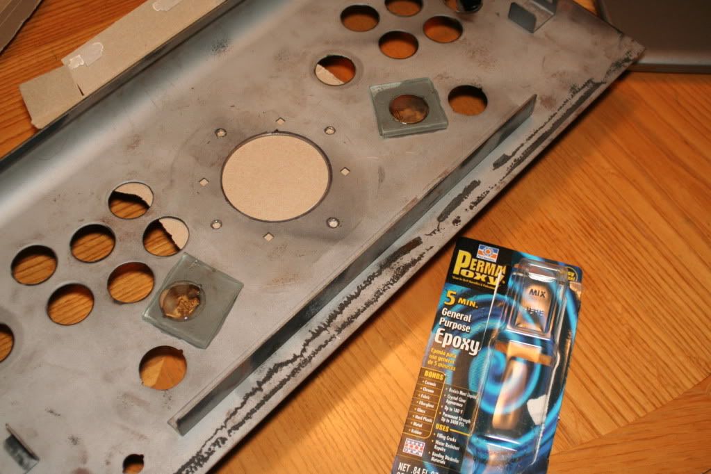

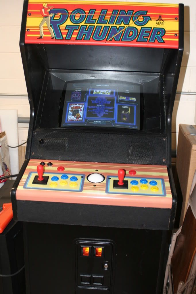

To cover existing holes in a metal control panel, I epoxied some squares of plexiglass on the underside of the CP, then filled in the hole flush with bondo. Once sanded and covered with the overlay, you'd never know the hole ever existed.
I have some pics documenting the process on my home laptop -- when I get back tonight I'll put them up so you can see what I did.

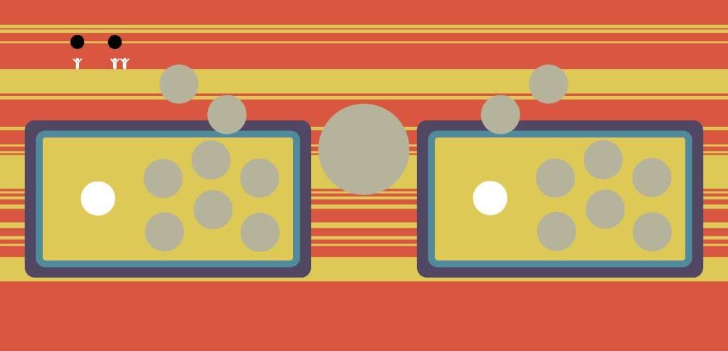

My final Control panel design used the following image:
The 2 sets of angled holes on top are the original Rolling thunder button holes that I'm talking about. The lower holes that interfere with the joystick borders are the ones that I covered up. The upper ones I kept as admin/mouse buttons.
A little tough to see here, but you get the idea:

My only concern is that you just covered them up, while if you look at my pics, it looks as though I might have to cover them up, but later on drill where I just filled... Wonder how that's gonna go down...  :-\

As long as you support the area you're drilling through from the top and bottom, you shouldn't have any issues whatsoever. Just sandwich the CP between two pieces of MDF or plywood, and drill away.
Here's a few shots of the process I took to cover my holes:

Here I epoxied two squares of plexiglass over my unwanted holes.

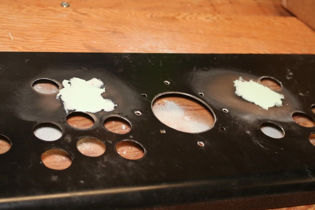

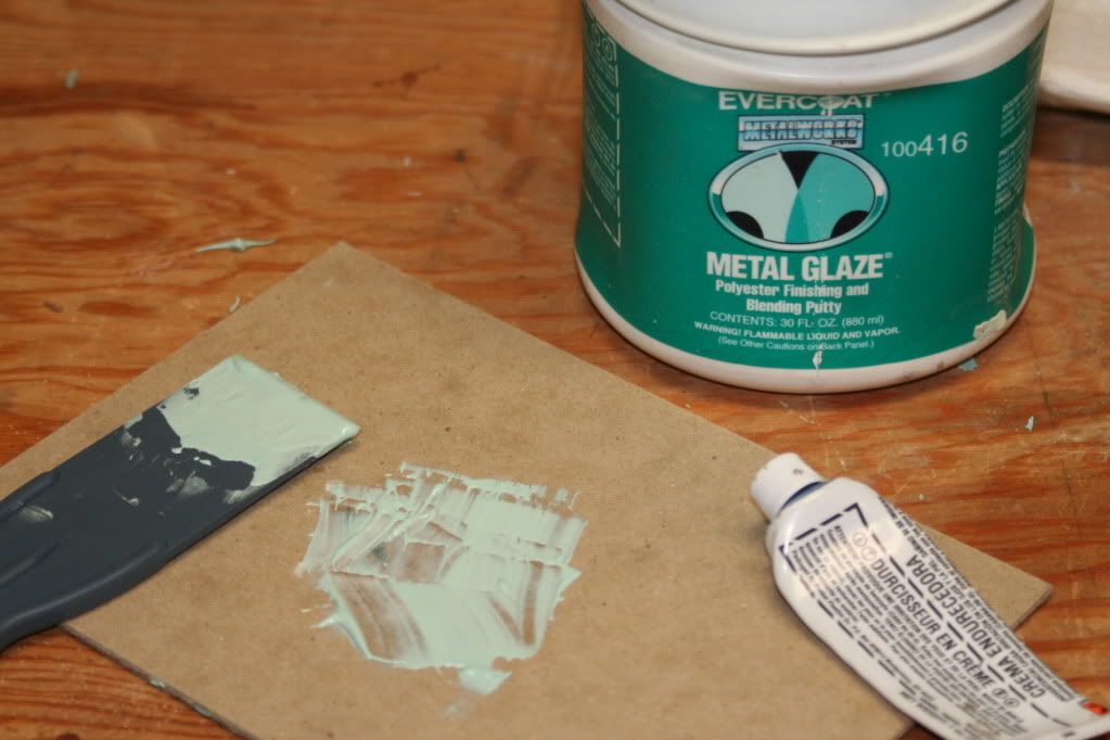

Next, mix up some body filler putty:
Then fill in the gap on top after the epoxy has dried.
After that, sand up to 600 grit or so, reprime, and you're ready to paint or apply your overlay.
