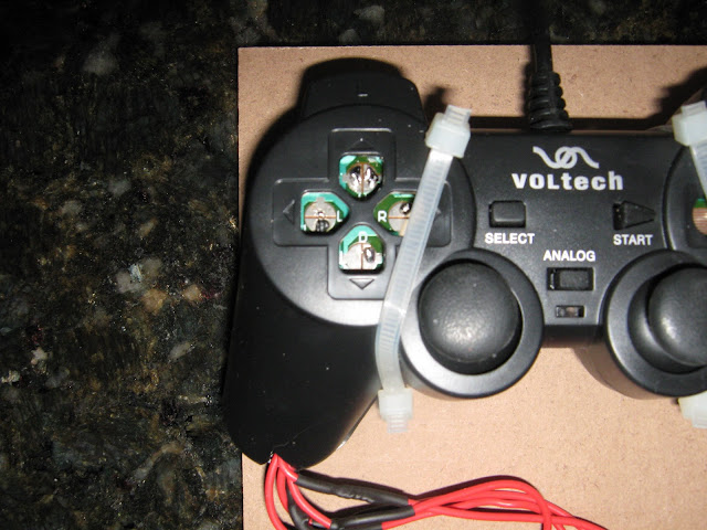

I removed a couple smaller boards, removed the rumble motors, and removed the left and right triggers.  Remove the arrow buttons.  I only needed three buttons for my jukebox, so the arrows buttons were perfect.  In this picture, you can see the copper pads under where the arrow buttons used to be, with my wires soldered.
When you press down on a button on the joystick, the button "short circuits" across two halves of a copper pad.  To hack the joystick, we need to solder wires to the two halves of the copper pad, and then attach the wires to the terminals of an external button.  That way, when you press the external button, it shorts the two halves of the pad and the joystick will record a button push.
One half of the pad is "ground" and is shared among all the buttons.  Just look at the traces and see which path connects to half of all the pads.  That's the ground (you'll connect this to the common terminal on your external button).  The other half of the pad will be connected to the NO terminal of your external button.

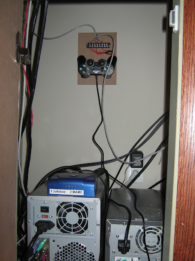

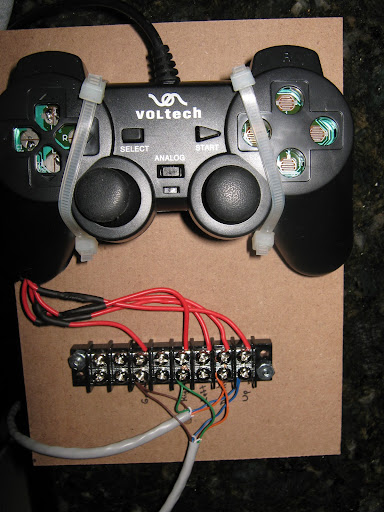

I nibbled away some of the plastic and ran the wires out of the handle of the joystick.  I mounted the joystick to a small board, and ran the wires to a barrier strip.  You can get this at Radio Shack for a couple of bucks. http://www.radioshack.com/product/index.jsp?productId=2103983
  Label each of the wires (Up, Down, Left, Right, Ground).

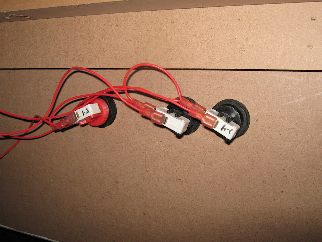

Next, you need to connect the wires to your external buttons.  The common terminal of the buttons are all connected together, and connect to the ground screw on the barrier strip.  The Up, Down, and Right external button NO terminal connects to the corresponding connection on the barrier strip.

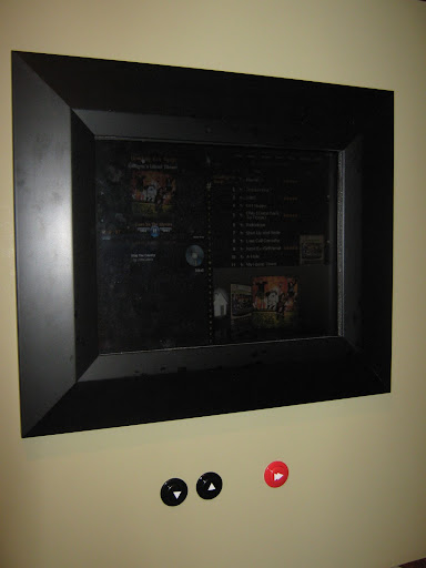

I connected the buttons below the touch screen, and duplicate buttons behind the bar.
For my jukebox, Up=volume up, Down=volume down, and right=skip song.

were are the  green,blue,orange and brown wires going to.
Burke LaShell
  • Posts: 52
  • Last login:October 10, 2015, 06:45:05 pm
Re: Jukebox USB joystick hack - HOWTO
« Reply #6 on: May 17, 2010, 01:51:02 pm »
Brown - goes to the "common" connection on all the buttons
Green - goes to the NO (normally open) connection on the RIGHT buttons
Orange - goes to the NO (normally open) connection on the DOWN buttons
Blue - goes to the NO (normally open) connection on the UP buttons
