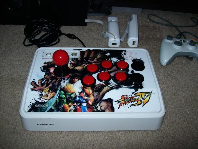

Hi y'all, just checking in as promised.  Kev's stick arrived today and he is giving it a workout on MK vs DCU as I type.  Looks like we made a good choice, the weight is good and the stick/buttons seem pretty responsive, of course I haven't had a chance to check it out myself.  It shore is purty! ;D
As long as he's happy and this puts him on an even standing playing against others, I'm satisfied.
FYI, Kev turns the stick sideways, presses the buttons with his better hand, the right and uses the stick with his leg/knee!
He kicks ---my bottom--- in fighters on a regular basis.  Pretty amazing guy.
Pix of the stick and Kev kicking ass below.

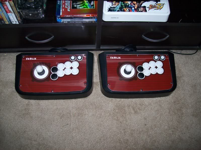

I'm glad that you decided to go with the Mad Catz Stick over the lower end Hori Sticks.
I've always been a big Street Fighter / Joystick fan and I have Two Tekken 5 Hori Sticks (Low End) a Mad Catz SE, like the one you have, and a Mad Catz TE stick. I will admit that the TE is incredible right out of the box, I've never been a fan of Sanwa Buttons, but I DO love the JLF joystick. The SE is not a bad stick either, but after playing some serious street fighter / Blazblu with it, I decided I needed to Upgrade the stick and buttons. The good thing about the SE and TE is everything was designed to be plug and play meaning you can buy a new JLF-SK and simply drop it into the SE without any serious work. The buttons all have Quick Disconnects as well so swapping buttons is a breeze. Again, the SE was designed for Sanwa buttons to drop right in, but I prefer Seimitsu buttons as they aren's as sensitive as the OSBF Sanwa's are. I had no problem dropping in my JLF and Seimitsu buttons. I strongly recommend it if he continues to play with it.
The only other issue with the SE is there is a washer on the inside that can come loose and scratch the inside of the metal plate. This really only affected the first wave of sticks and should be fixed by now. Just a heads up.
Here is the final layout.
I also modded my Hori T5's to be put onto my Vewlix replica thats currently being built.
Again, Sanwa JLF's for Sticks, and Seimitsu 30mm's for buttons.
Let me know if you need anymore info about modding, I've done a couple and may be able to help you a bit.
