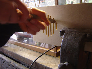

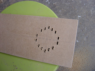

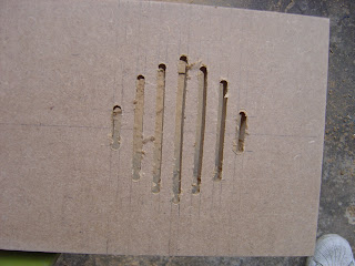

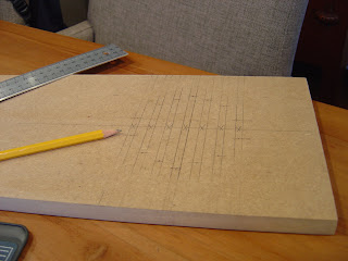

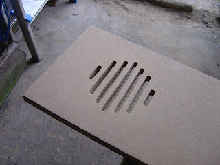

Speaker slot making for the Nintendo type cabinets is easy. Once you lay out your holes you drill a hole on each side of your layout. Then you clamp down your piece and take your jig saw with a fine blade and cut out the oval holes. After your done use a fine file to smooth it up and it looks perfect. If your using MDF it's even easier because MDF is so easy to cut compared to plywood. Here are some examples below:
