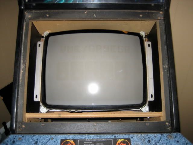

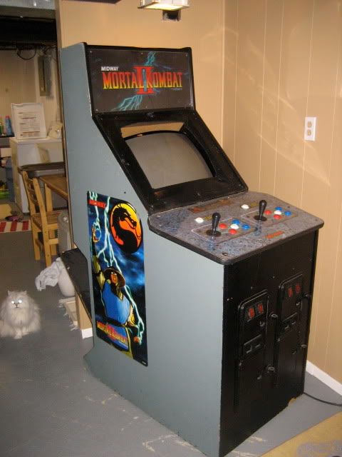

Unfortunately, someone did though. It was converted into a MK2 cab. I bought it like this. (fairly cheap too!) here are a few pics, its the original 19" monitor in there as far as I can tell. In fact, most everything looks original besides Jamma. (and artwork of course

What's wrong with the original monitor?

Absolutely nothing! MK2 was originally a 25" monitor, and the characters seem a bit small on this screen.
Rather than try to restore it back to a Gauntlet, I'd like it to be as much like a MK2 as possible.

« Reply #7 on: December 14, 2009, 09:17:57 am »
Dedicated MKII definitely had a 25" monitor, but without significant work, I don't see you getting a 25" monitor in that Gauntlet.

« Reply #8 on: December 14, 2009, 11:16:51 am »
What kind of work we talkin bout here?
Also, I have an opportunity to pick up a Hantarex polo 25". But its just the tube and yoke. What would I need to get it workin properly?

« Reply #9 on: December 14, 2009, 12:32:02 pm »
You'd need a chassis.  I'd pass on it.
What work?  At best, knock a couple holes in the monitor mounts to accommodate the new monitor.  At worst?  Having to modify the monitor to fit in that tiny space, and the cab.
