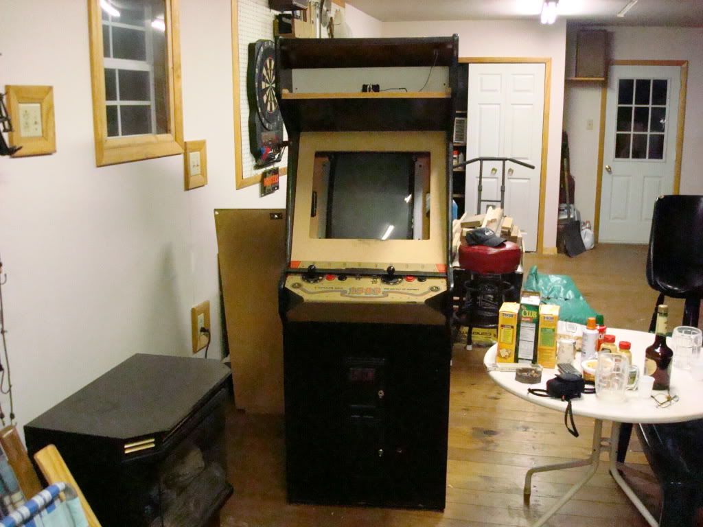

I’ve been tinkering around with the MAME program for several years and have often thought about assembling my own arcade cabinet to run various games on.  Recently I have acquired a used CAPCOM 1943 arcade game that is in very good condition.
  I know this is going to be a long project and will require a lot of work;  but before I get started I wanted to reach out and seek advice with some of you that have already completed a cabinet regarding what I should do, i.e. what you would do different?  I am going to leave the cabinet intact for the most part; but I do plan on building a custom control panel to control the games with.  I would like to build something that is premium quality and is very customized; yet easy to work on.   I have looked on several websites that have arcade parts for sale such as buttons, joysticks and trac balls that I will need; but they all look the same to me.  I plan on customizing the control panel with lighted buttons and I need to know the best site for this type of stuff.  I have read on other sites that once the control panel is complete there is certain devices that you need to run them through to convert the controls to a USB so that I can access them through the Windows operating system that will run the program.
Another dilemma that I am extremely uncertain about is what type of monitor to use in the cabinet?  The monitor that came with the unit has burn-in extremely bad and is junk so I will be needing another one. The games that I play on my pc now run on a 22” widescreen monitor and they look and run great; but I have seen and heard about other VGA cards you can connect to a computer that make the graphics and resolution even more arcade authentic.  Is this something that is recommended or just a personal choice?   To sum it up at this point, the main advice I need is on this control panel and which monitor to install in the cabinet.
So as you see this project is just starting and before I get too much money wrapped up in this thing, I wanted advice to point me in the right direction and hopefully prevent mistakes that others have made.
Any advice is appreciated.  Thanks  ;D

Is it this one?
http://www.klov.com/game_detail.php?game_id=6769
I would first check if you can keep it original. There are for example 4 VAPS members looking for an original one. I think a MAME cab is best built from scratch.

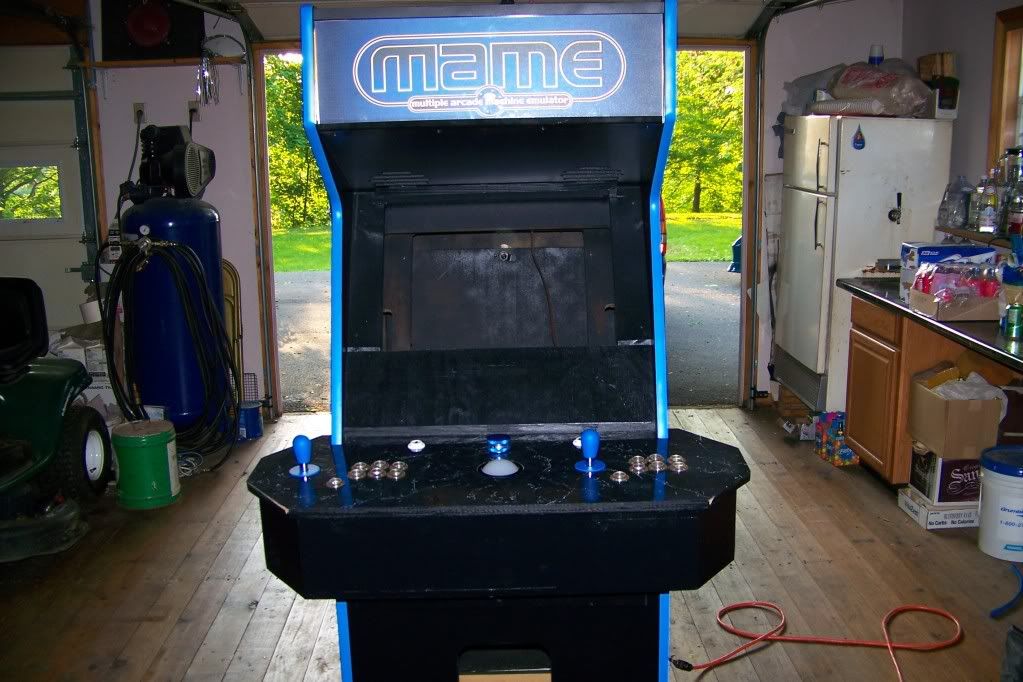

I think I have almost everything together for this project. A few days ago I gutted the inside of the machine of the mb and monitor, and vacuumed it out.
Here is a picture of it if your interested - http://i263.photobucket.com/albums/ii133/Section_25/DSC00719.jpg
I am going to be running the Game Ex front-end program  with the cabinet. I have Game Ex about 50% configured the way I want it, but I had a question about what some of you thought about how I should power-on the cabinet. I am going to install a widescreen 22' monitor in the cabinet along with the computer, but I want both of them to power off and on with just one button or something from the outside of the cabinet. A few people suggested "modding" the monitor and the computer motherboard to run off the same switch, but I'm not sure how to go about doing this. The monitor seems pretty simple, but for the computer to power on and off with a button or switch press seems like it would be tricky. I'm sure lot's of people around here have a solution for this and I wanted some ideas of how I should approach it. Thanks in advance for your suggestions!  :)

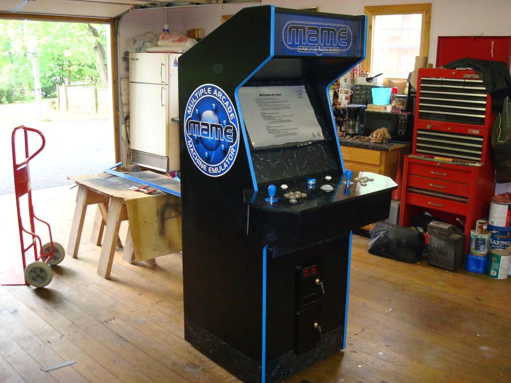

Latest Pic.
Except for the T-molding along the top board of the CP (had to wait for the correct bit to arive), and a sticker with white and blue flames running around the front of the CP (Custom made) I think the exterior is finished.
Opinions !  ;D

i think it looks good....good job.
