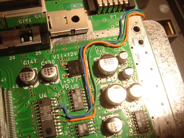

theres always tapping RGB out of the N64:
heres an old blog post of my mod:
http://tsenzen.blogspot.com/2007/05/n64-rgb-mod.html
gamesx and mmmonkey has great diagrams/info on explaing how it works:
http://www.mmmonkey.co.uk/console/nintendo/ntsc_nintendo_64_rgb.htm
once youve accomplished RGB out, than all you have to do is wire an RGB2JAMMA adapter similar to how ive done here:
you might have to find the right version of the N64, some have issues with amplification, so you might need to make an amp for your video.
follow the instructions from the Saturn 2 Jamma project:
http://pc2jamma.mameworld.info/arc_sat2.html
all the same rules apply, cept your using an RGB modded N64 in place of it :). Hope this helps
