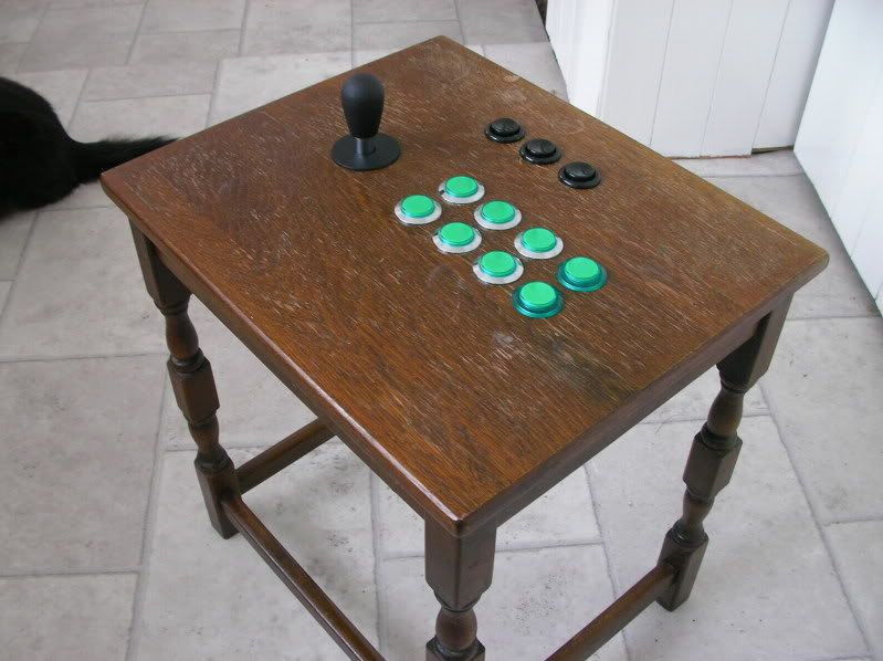

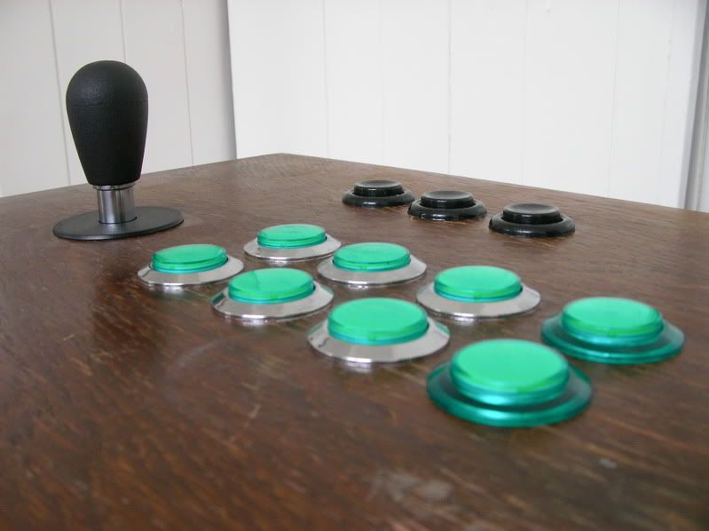

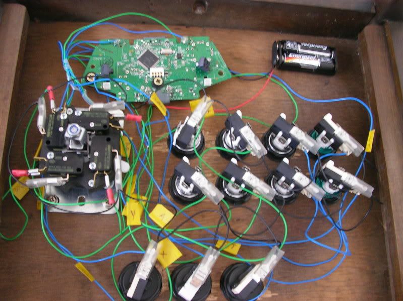

Hi Peeps,
This crappy old, cup stained coffee table has been in my family for years. its been used for so many things in the past, the mind boggles. Couple that with a touch of nostalgia, and years of memories, i almost shed a tear when i drilled the first hole in it.........

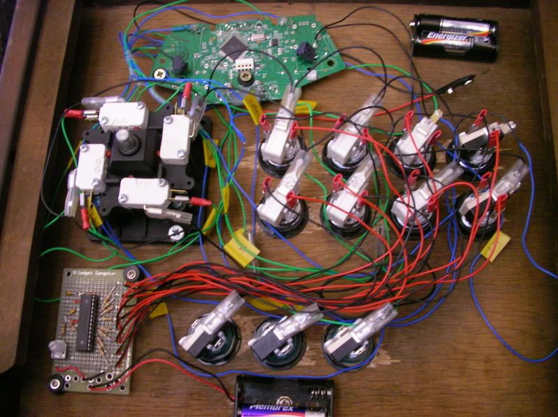

Parts used were chromalux buttons from Ultimarc, some left over happ competition buttons i had left over from an old arcade machine, and a Mag-stik plus, also from Ultimarc.
I also used sanwa microswitches, but are too 'clicky' for me. I plan on changing the full lot for cherry micros for my preffered feel. Also gotta tidy up the wiring.....
There is also green leds in the buttons, but they are 5v, so another power source will have to be used to make them work. (probably do it at the weekend)
Now, anyone for a severe thrashing on SF4????

Nice job, but put a bottom panel in there... someone will eventually catch one of those wires on a finger or a beer or something.

Love it! I'm a sucker for repurposing stuff.
But, seriously, would it a killed ya to give it a rub down with some 240 grit and slap some stain on there?  ;)

lol, it is a bit grubby yeah. But thats the point. I can still use it without fear of further damage, as i have done for nigh on 20 years!!!
I do plan on making it a little nicer, but by way of chasing leds in the buttons.
I plan on making a two player coffee table for my next mod, and it will be a whole lot nicer.....

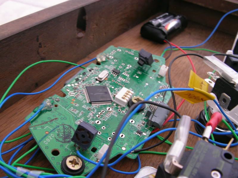

How did you connect the wires to the controller?  I've tried soldering wires to a TV remote in the past and didn't have any luck.

The level of ease/difficulty for this mod relies on which controller version you decide to use. I used a common ground (CG) version for minimal soldering. Other versions i hear have larger solder points to hit, but a lot more work involved wiring wise.
I'm pretty good at soldering, but still had several issues with small contacts lifting from the board. i then had to hit even smaller points as an alternate to fix my mistakes which really was a pain in the ass.
All info you need can be found here:
http://forums.xbox-scene.com/index.php?showtopic=471958

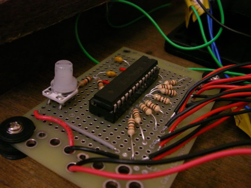

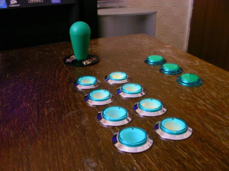

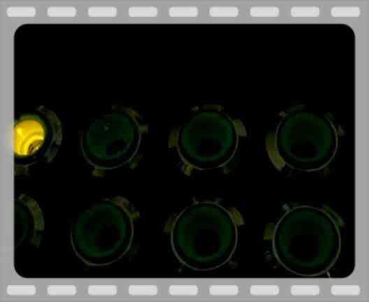

Got well sick of the magstick, and went for a much smoother Happ ultimate stick (modified to sit lower than standard) Also changed buttons around and made them all green. I took out the green inserts as i couldnt see the light through them:
I also bought a running led kit from 'GadgetGangster.com' and hooked it up to the buttons. I had to solder some of my own leds into the button casings as the ones i had were 5v and ended up being too dim. Just need a way to better diffuse the light, was thinking cotton wool, but this will do for now.....
More messy wires...Ugh!
And a short vid showing how it works......
Photobucket can be a right pain sometimes. Heres a link to the vid if you cant view the one above:
Still messing with light colours and such, but you get the idea......
